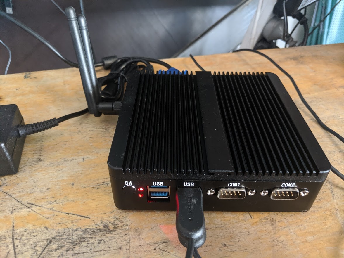

I've been using the gigabyte Brix J1900 and N3160 PC's for a few years.
It will be interesting to know if the Wifi works as the internal card caused unusable latency which meant that you need to use an external Wifi Dongle.
Its an odd choice for an industrial machine, There are much more robust J1900 Industrial PC's in Aluminiumn cases in the same form factor with external Wifi antennas, 2 x NIC's and RS232 ports if you want RS485 control (via a RS232 adapter). The downside is they use a Baytrail Chipset which has many settings to tweak to get acceptable latency.
But the Wifi via those antenna's works!

Not with the mesa ethernet hardware. You've still got all the latency issues to sort out but with Mesa hardware stepping, the latency requirements are substantially relaxed so its not a drama. It also runs sheetcam perfectly. I mount the PC behind the monitor as it comes with a Vesa bracket. I also have a Gigabyte N3160 (next version of the J1900) on my packing bench as the monitor is wall mounted so everything is up and out of the road. It struggles a bit with Win10 with 4 gb RAM, I've been meaning to upgrade the RAM to 8gb but it works for what that PC does. The last time I was on a PC shop, they did not have the right RAM for it. It will still run Photoshop and Lightroom which I use for photo processing if you are patient! You can get other Gigabyte Brix with a lot more grunt but they hurt the wallet more! I think that would be a good way to go if you have to support Windows.
