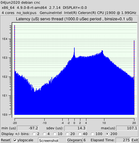

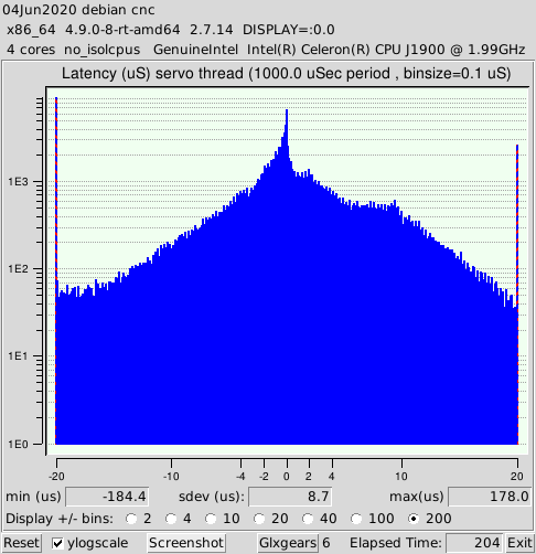

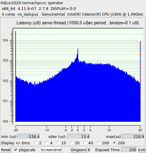

I also ended up getting this mini PC GB-BXBT-1900 (MZBAYAB-00). As a starting point I looked into
this post
for BIOS settings. I also removed WiFi card from the PC. Did all the tests without network connection.
Running on stock linuxcnc-stretch-uspace-amd64.iso from 2018-10-27 17:57
Here is my BIOS dump:
Results are kinda not impressive:
Servo: 210028ns
Base: 170048ns
With 6x glxgears and with various apps running

- Posts: 12156
- Thank you received: 4149
04 Jun 2020 08:11 #170080
Replied by rodw on topic Pathpilot MiniPC
do your testing without the base thread as with Mesa ethernet hardware (which I assume you are using) you do not need a base thread.
210028 is still OK for Mesa Ethernet. Mine is around 120000
