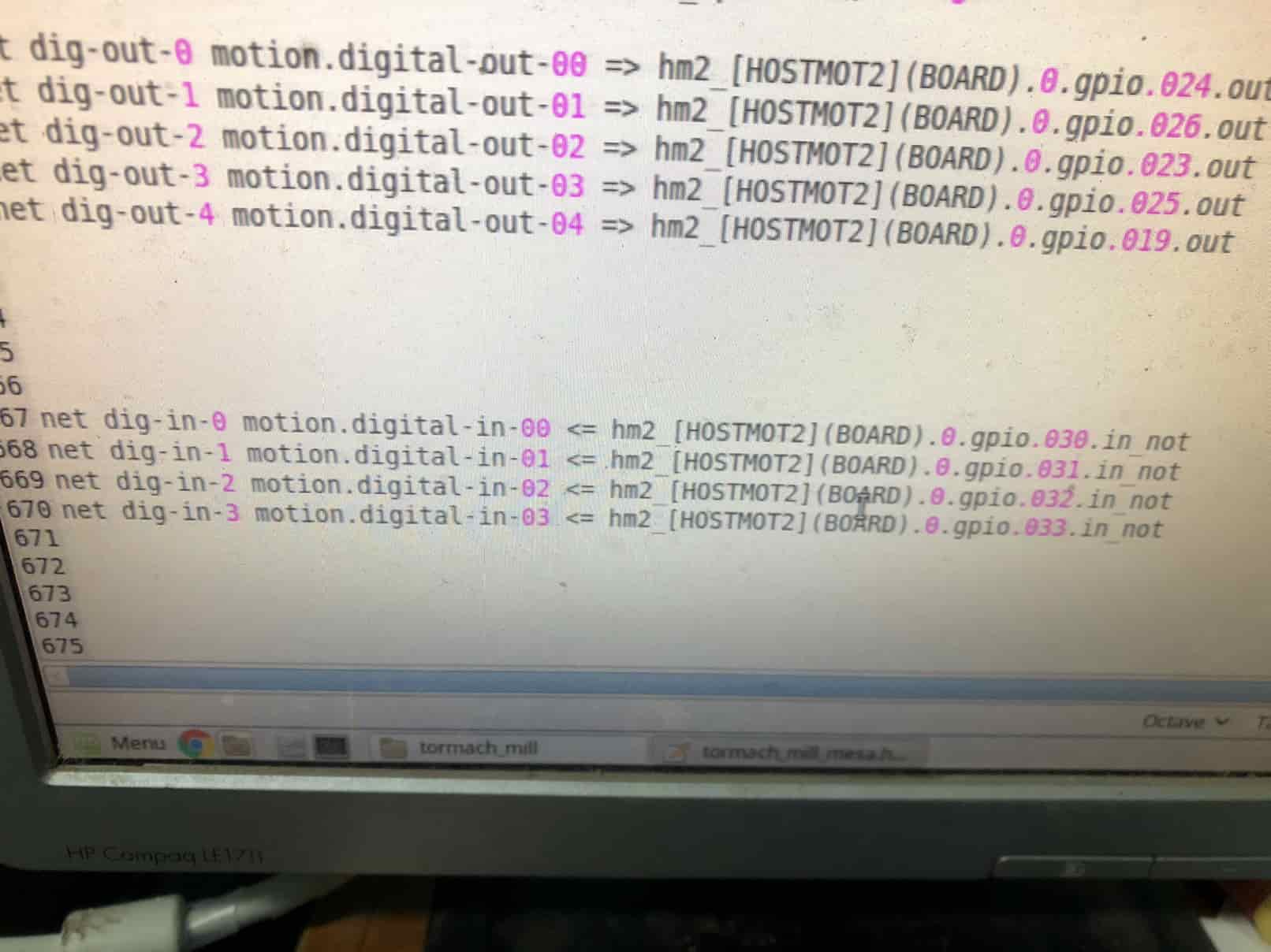

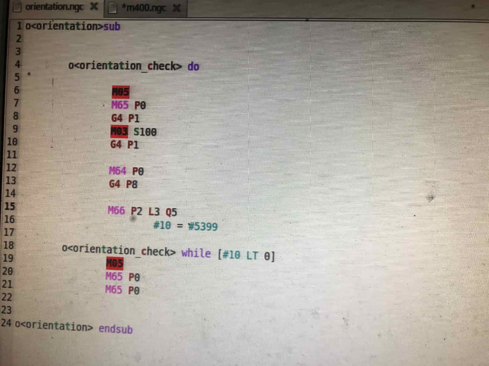

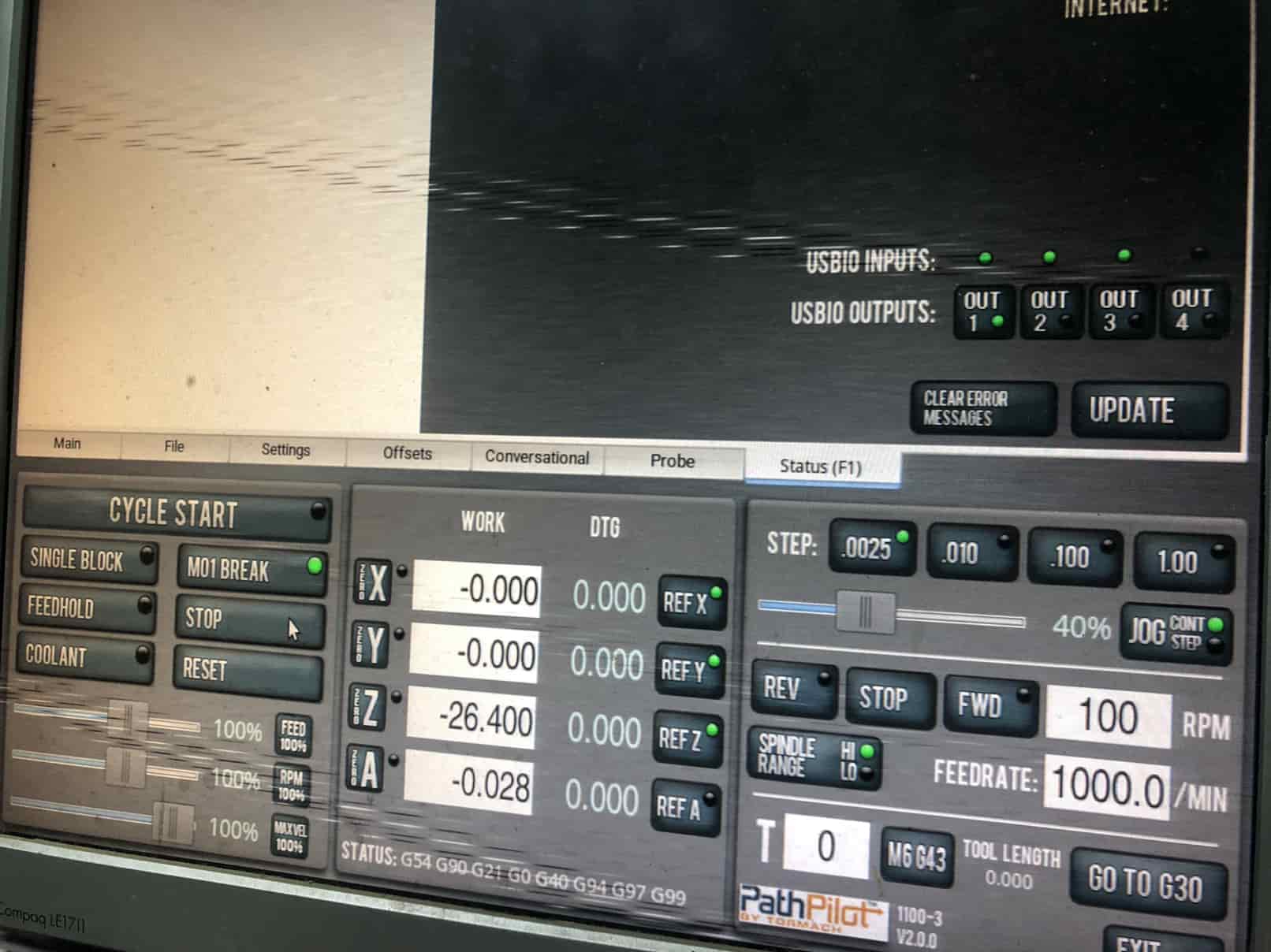

Hi all
Im new to linuxcnc and pathpilot is my first try, i got everything to work accept M66
I tried this code to check the spindle orientation, the code will run again if orientation signal is false
My input signal in status tab still function, i checked it's work fine
This is my hal file
Im stuck with this more than 2 days, i tried all M66 example i can find but it's still not work
when the code run to M66 line the cycle is stop
Please help me what i did wrong ?
This is my hal file

I use mach 3 board for usb io port, when the port go low the usbio inputs light's up
I realy dont understand your question but do you mean even if usbio inputs light's up, M66 still may not work ?

In the picture of your HAL setup there is no setup for motion.digital-in-02 you have two entries for motion.digital-in-03.
You are waiting for motion.digital-in-02 but have not set up a signal.

There is a problem in your HAL configuration, it looks like a copy-paste error.
in0
in1
in3
in3
You have set up input 3 twice, and input 2 not at all.
Replied by andypugh on topic M66 doesn't work
in0
in1
in3
in3

17 Jul 2020 12:59 #174942
If you use the halmeter, can you watch the dig-in-2 signal and the motion.digital-in-02 signal to be sure that they are triggering as-expected?
Which Mesa board are you using? It isn't that usual to use the bare gpio pins on most of them now.
Are you sure that gpio-032 is not being claimed as an output pin by a step-generator or similar?
If you can tell us the board, firmware and loadrt_hm2 lines from the HAL file we might be able to help more.
