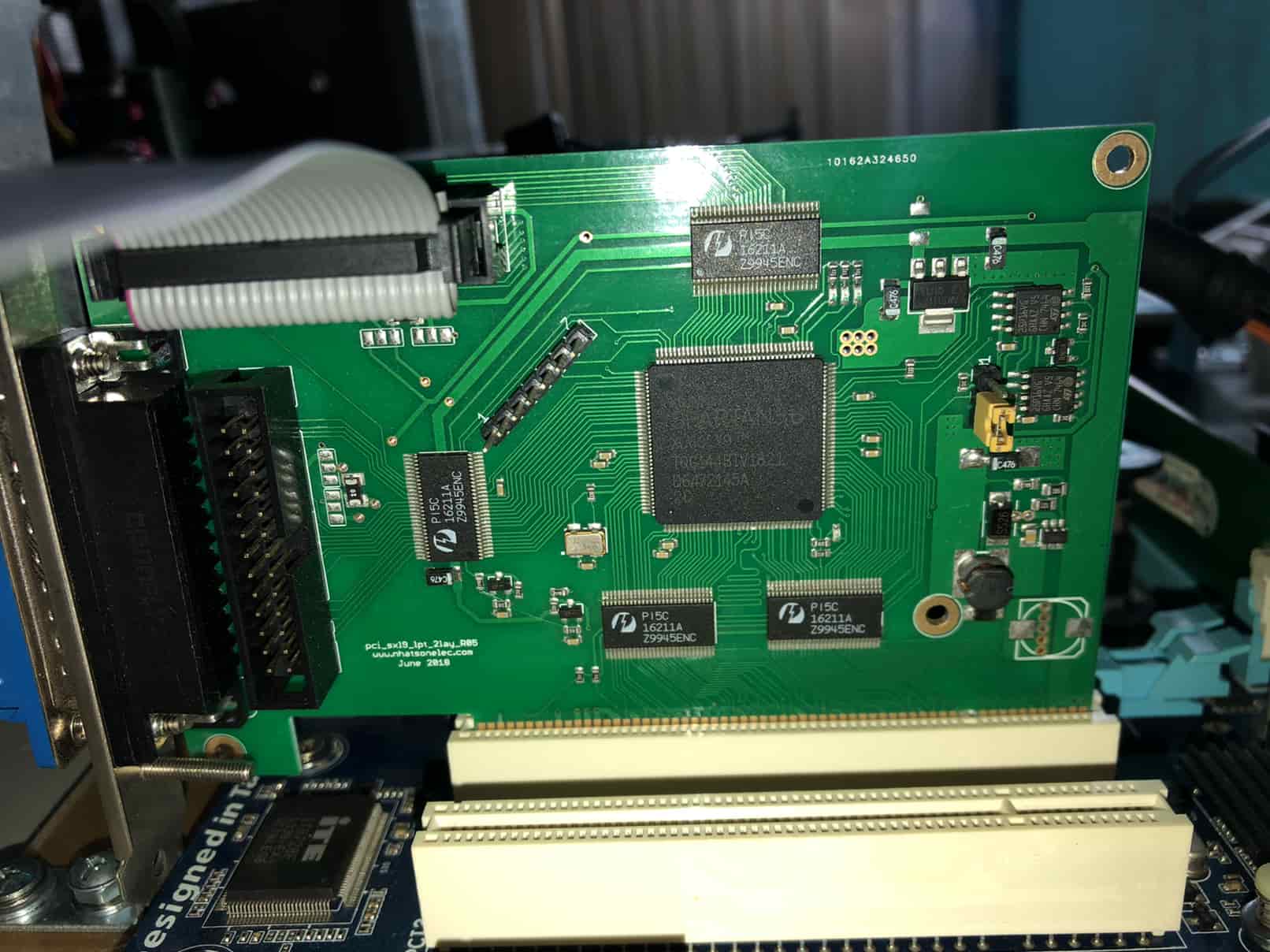

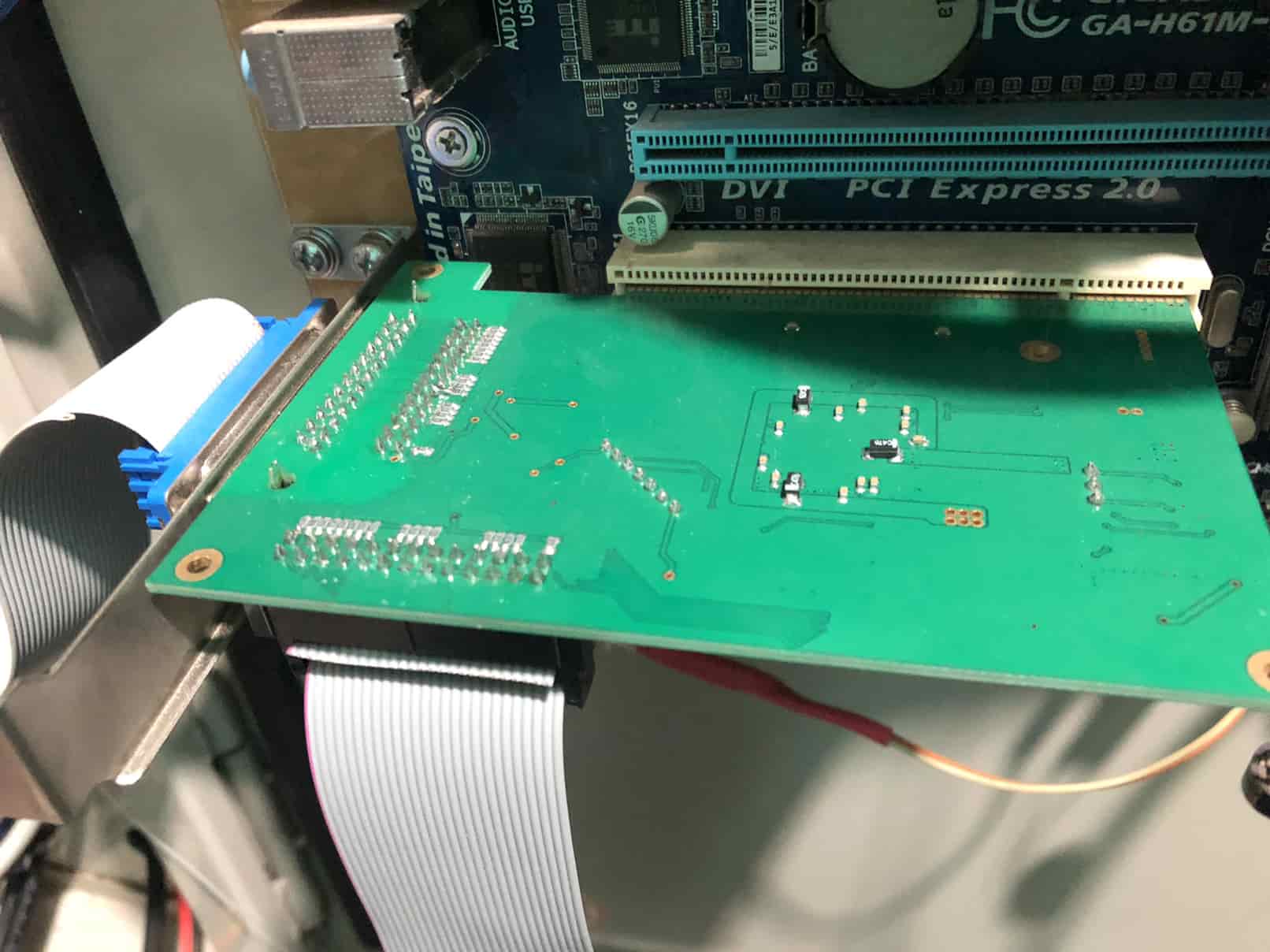

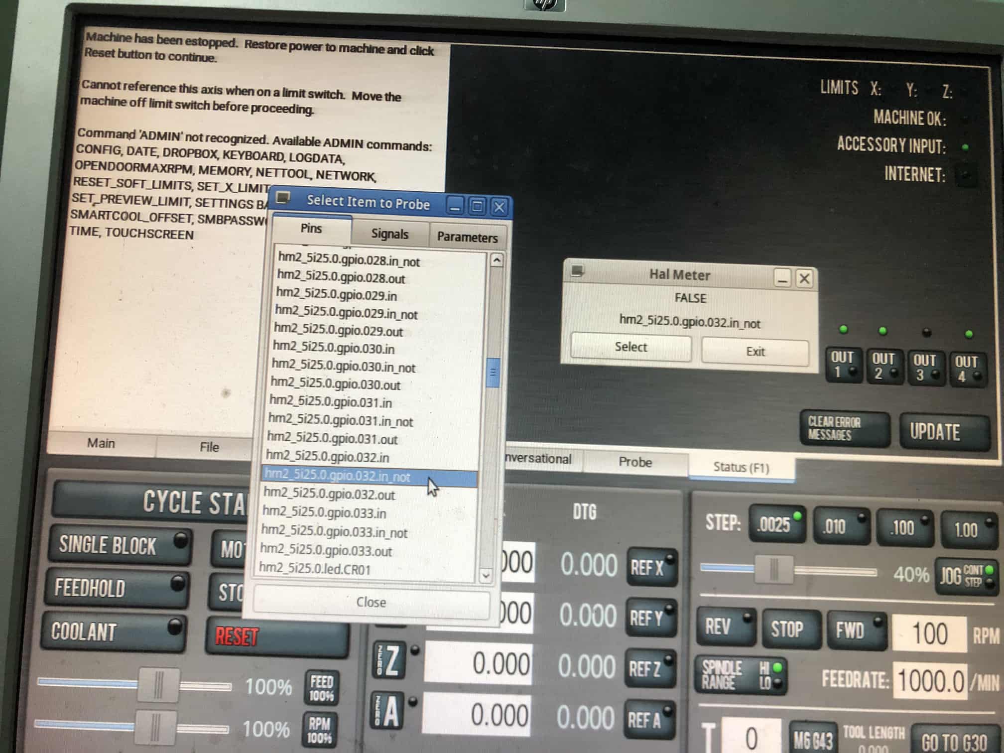

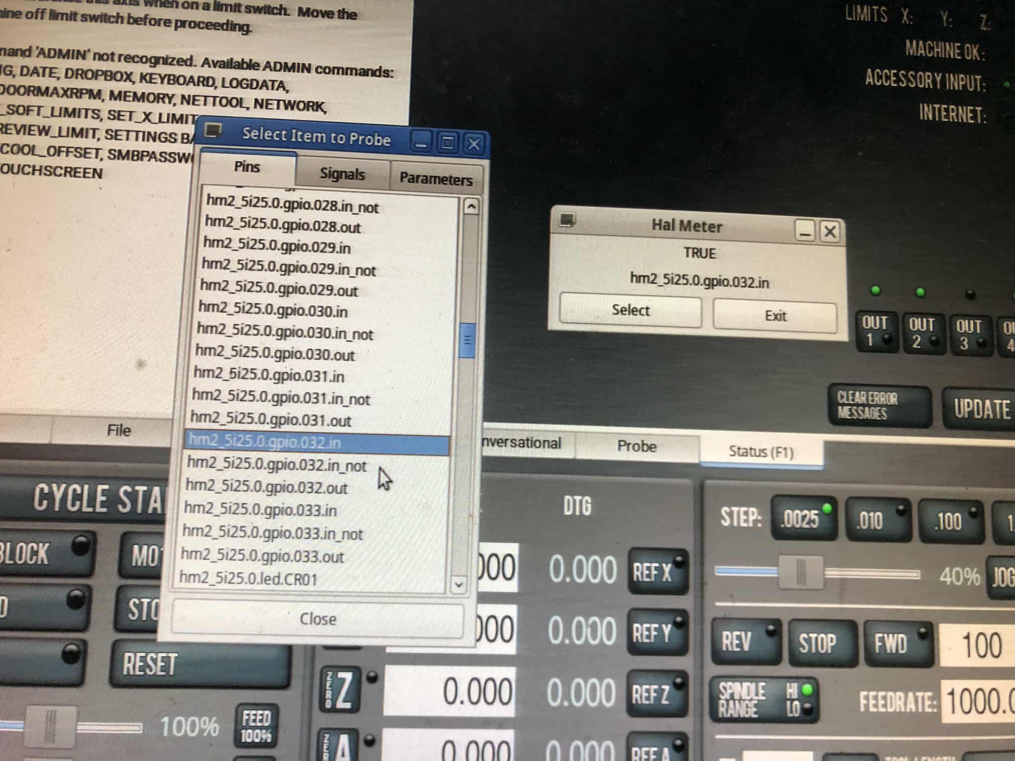

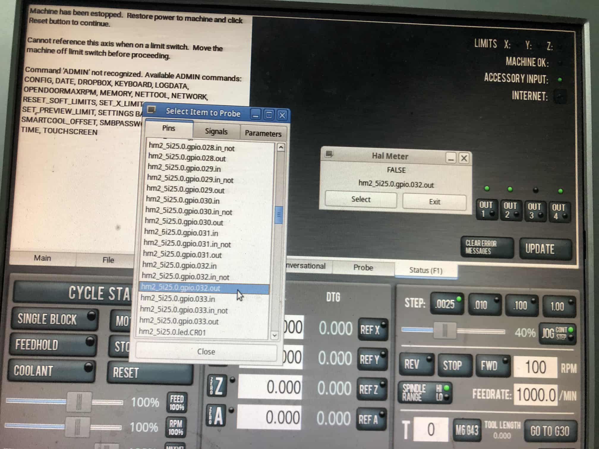

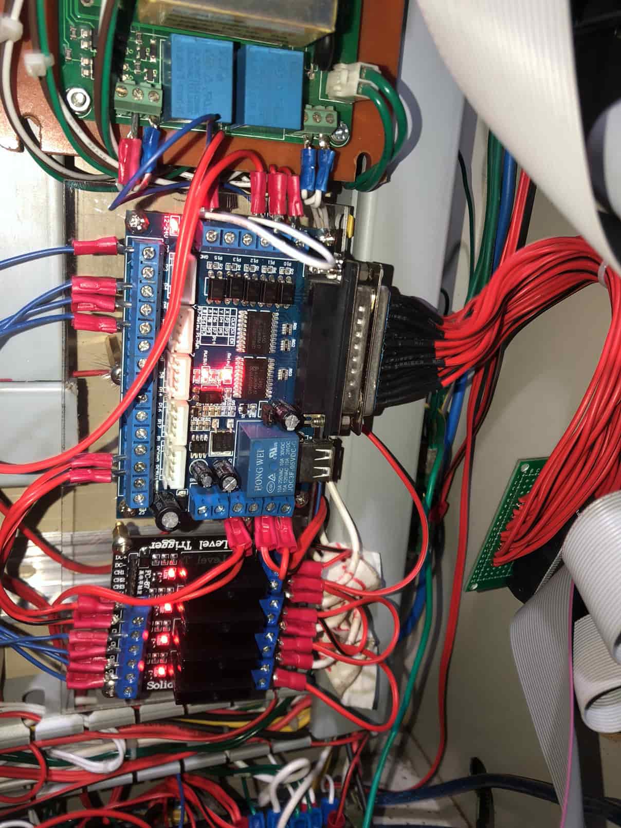

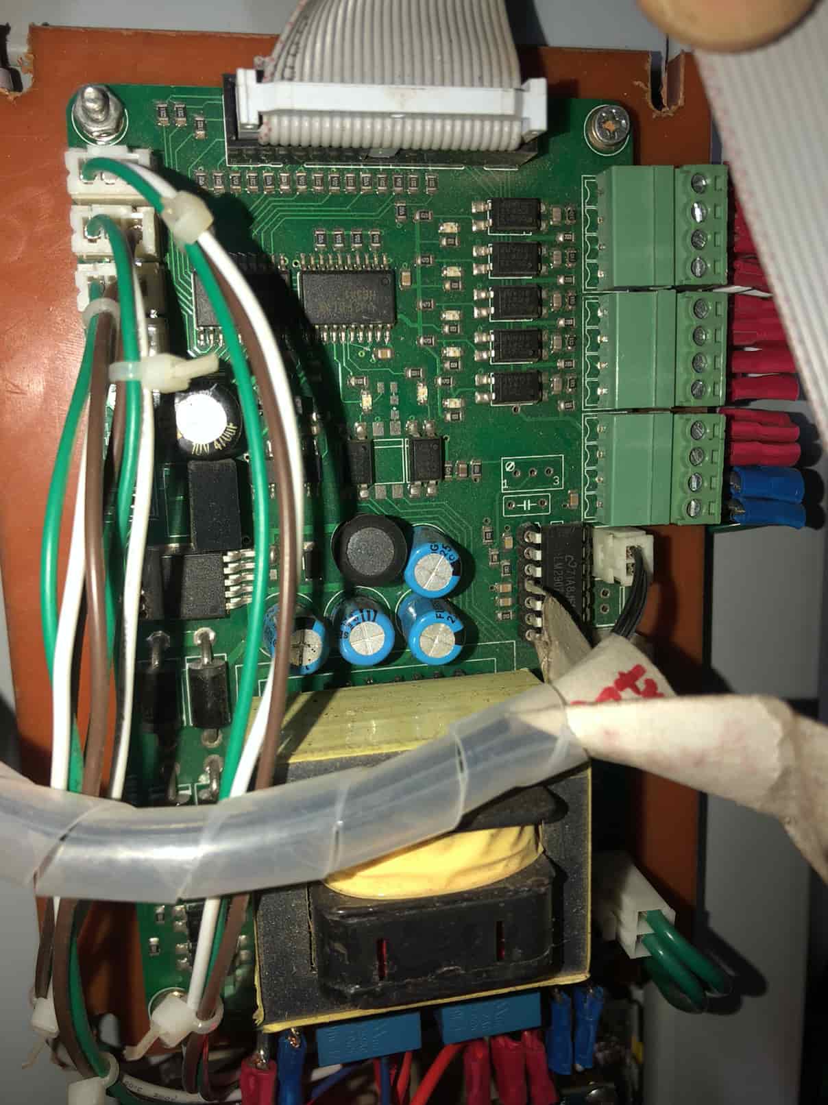

My setup is a little bit weird cause im in third wolrd country so i have to stick with third world solution
This is pci e motion control card
This is linuxcnc bob
I use mach 3 board + relay board for io pin

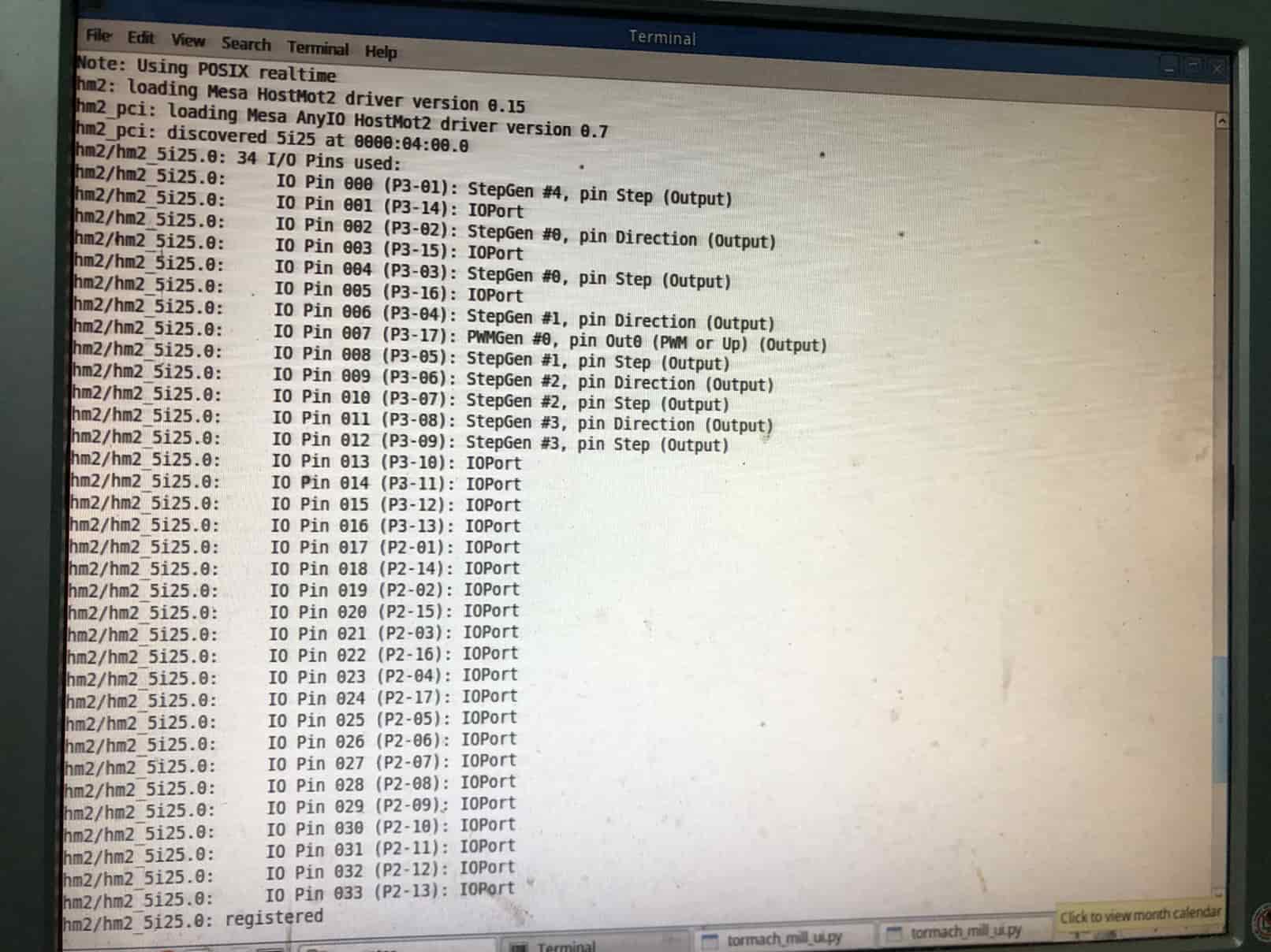

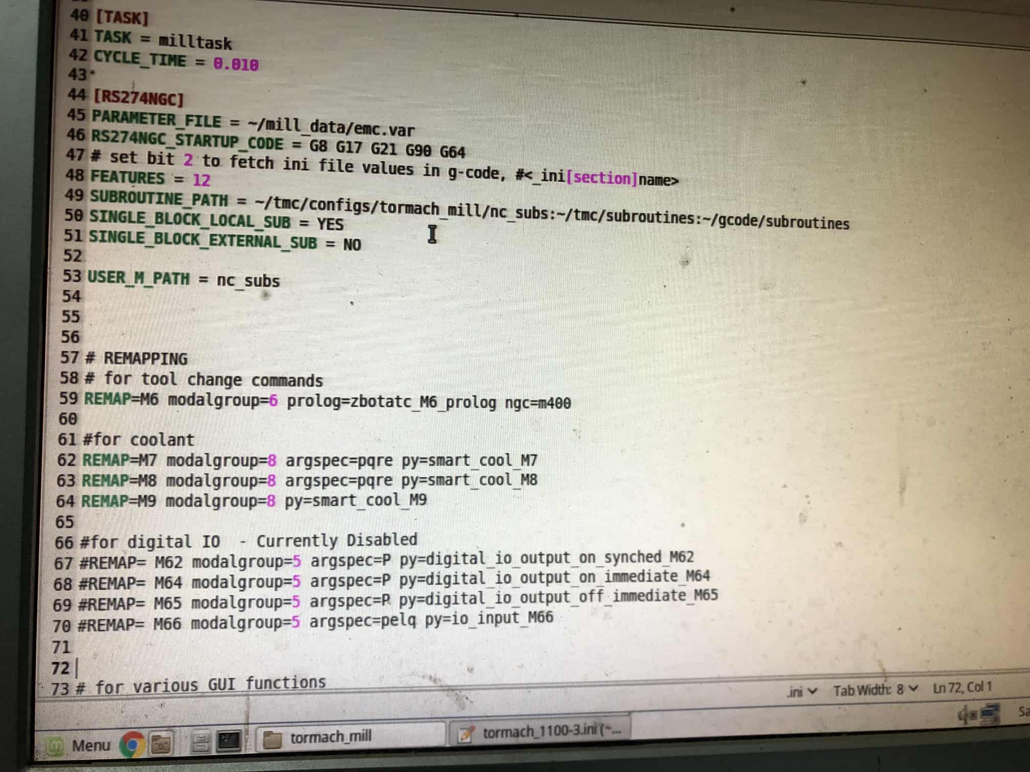

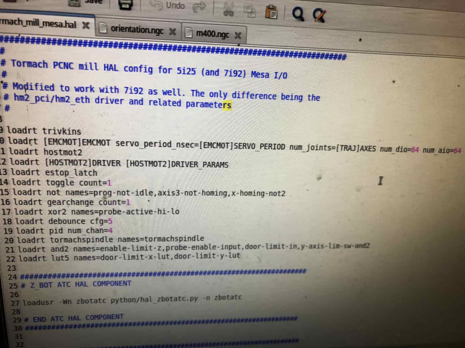

Here's the loadrt line, but it no hm2 :
I dont know how to open halmeter, i will figure out how to do it later but this is io port list show in operator_login

That seems to be a clone of a 5i25. So there is no real guarantee that the dmesg output that tells you that GPIO 32 is on DB25 pin 12 is correct.

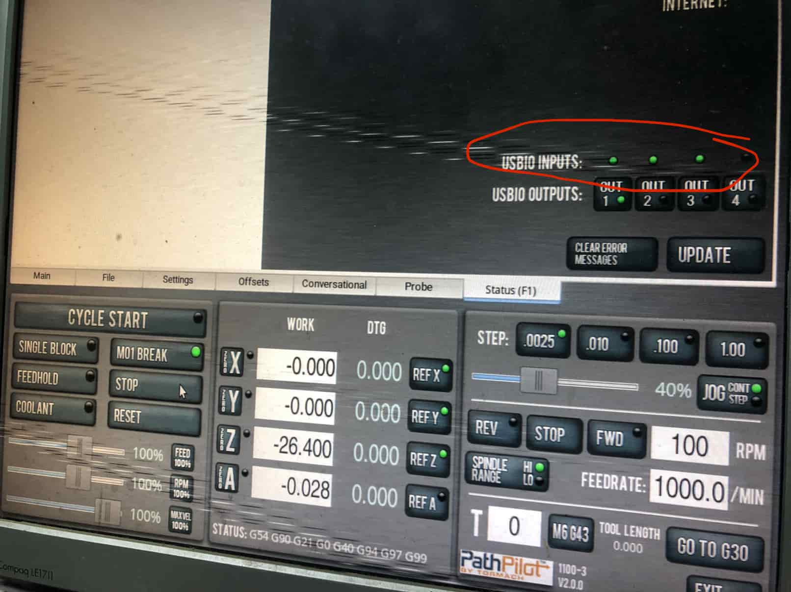

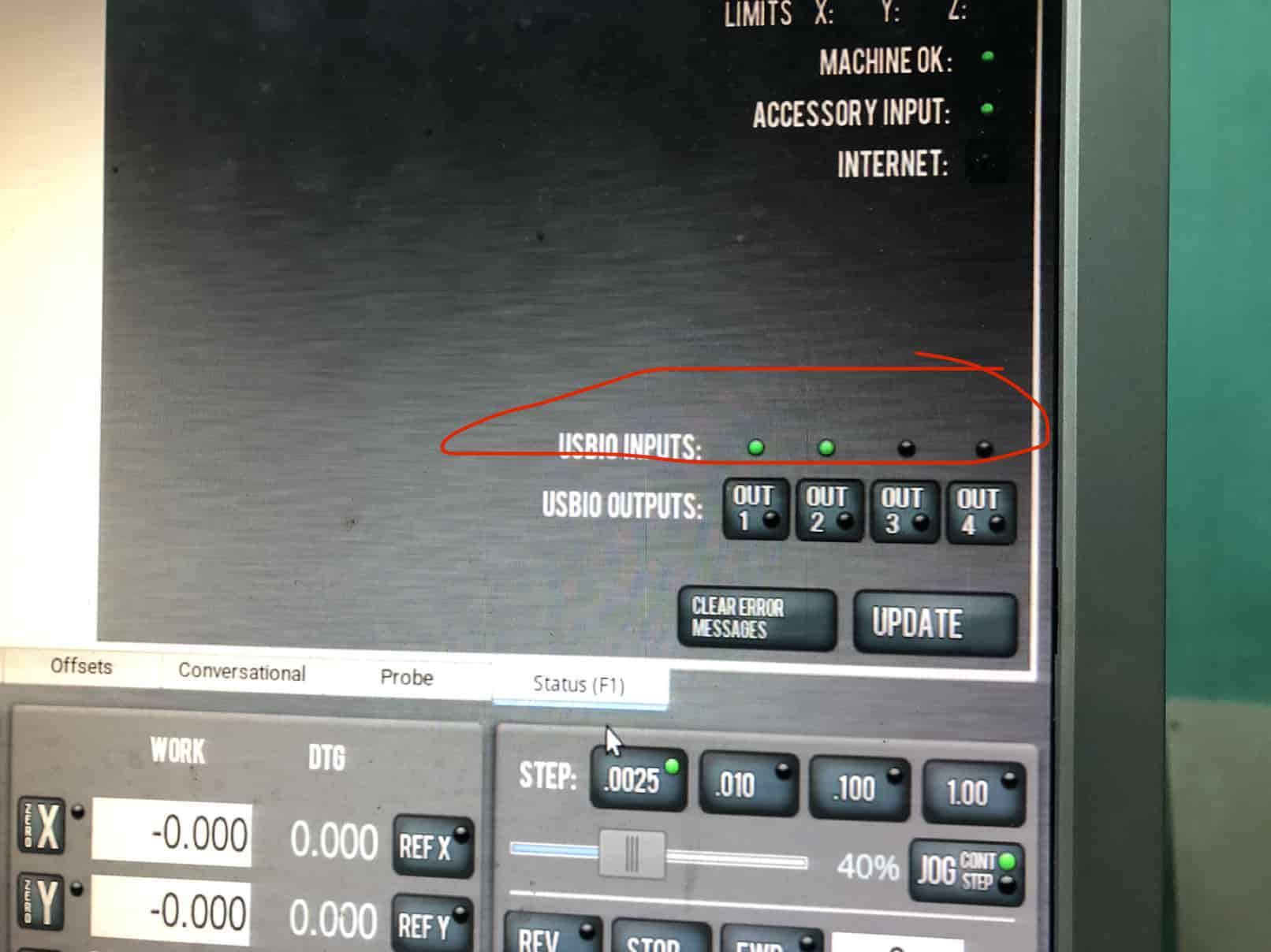

Can you use Halshow with PathPilot? That would let you check which physical input (if any) triggers when you toggle the physical input.

Back on subject, he did mention he is using USB something for inputs, so in that case i am not sure it will work.

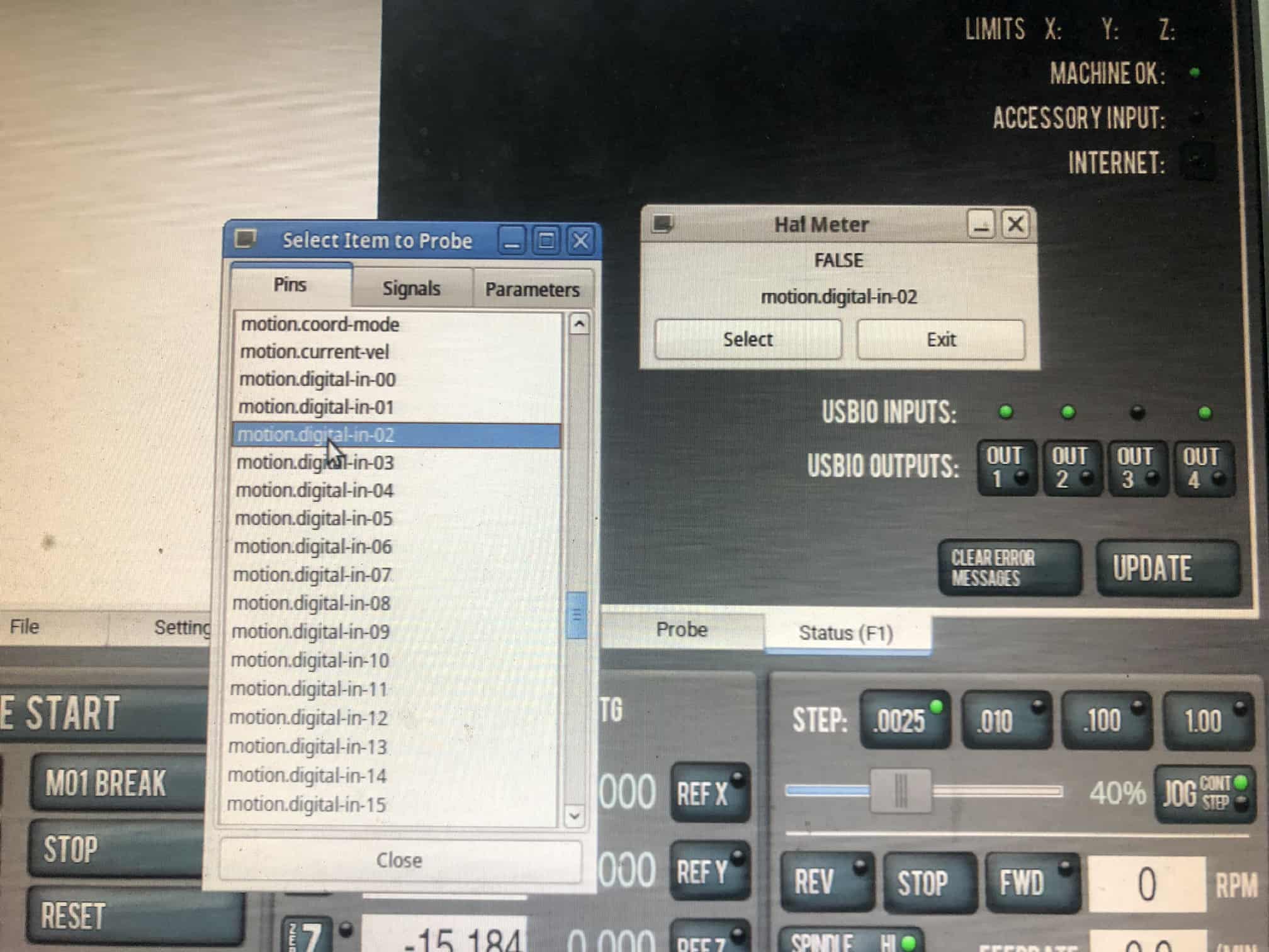

My halscope seems like everything work's fine
<iframe width="560" height="315" src="" frameborder="0" allow="accelerometer; autoplay; encrypted-media; gyroscope; picture-in-picture" allowfullscreen>

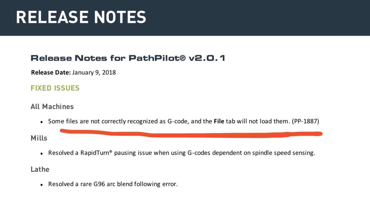

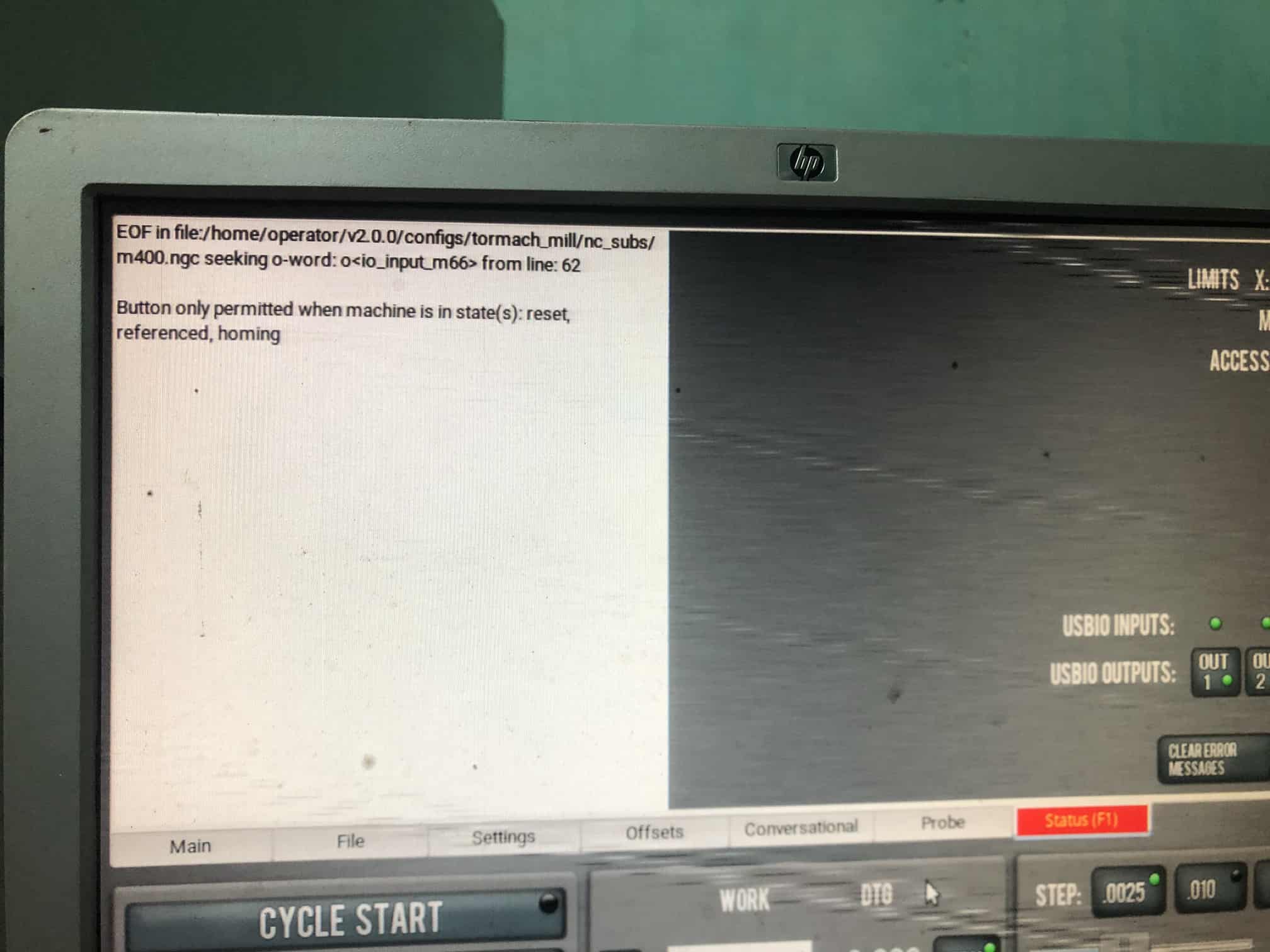

Problem is solved
I update pathpilot from virgin version to ver 2.0.1 and M66 is fixed
I found out it in tormach updates release notes ver 2.0.1
The file is not recognized is invoved with M66, i just spend 3 days for nothing![]()
Might as well go to the latest. They have fixed lots of errors since then.
