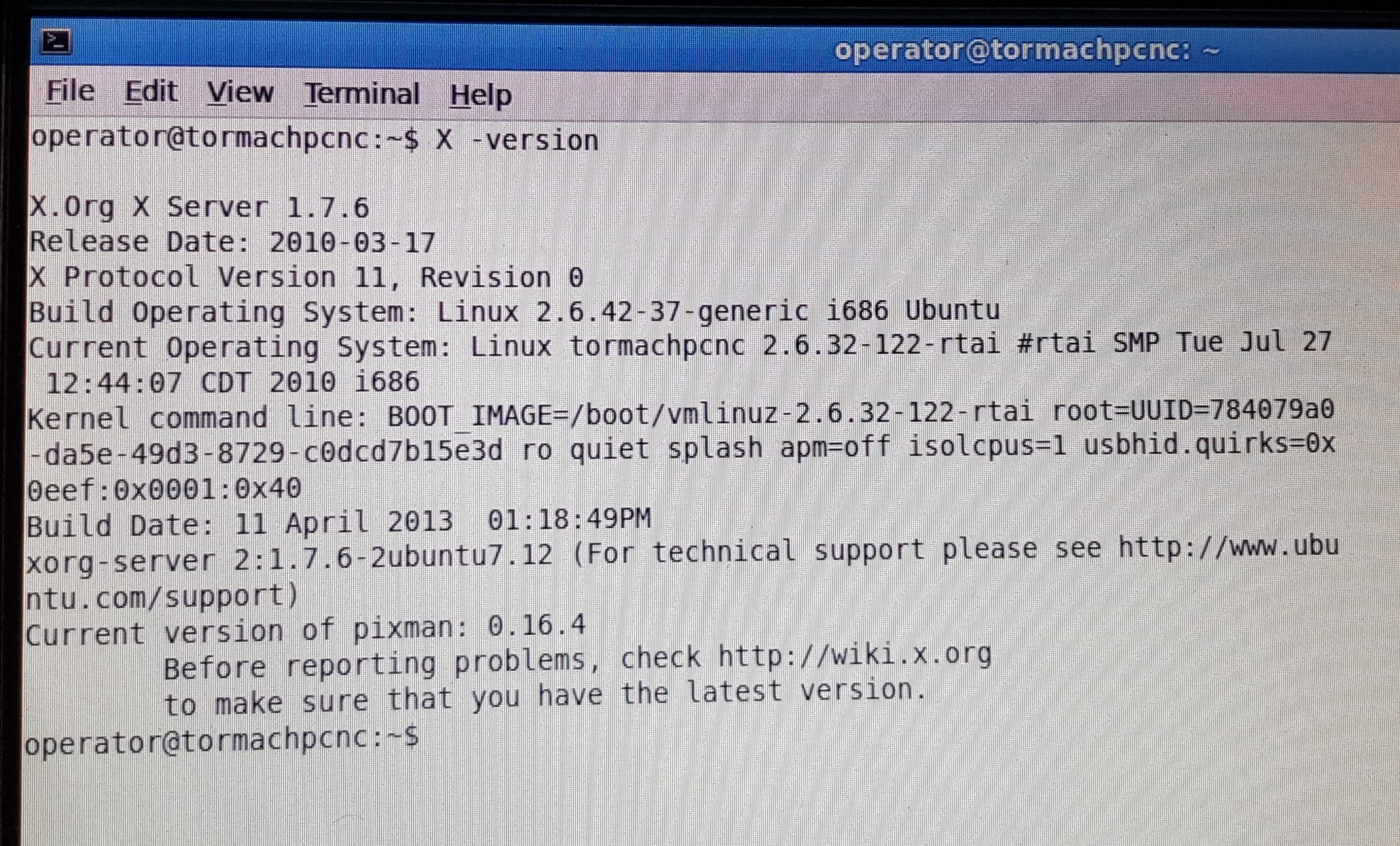

Here's a photo of the Xorg version. I don't know if that helps. I think my version of Linux is 32 bit.

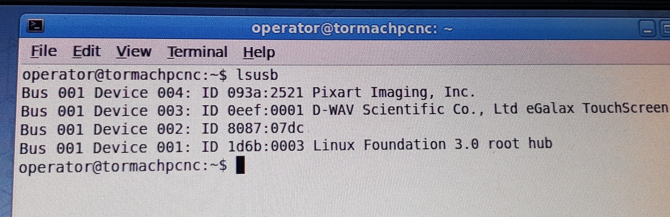

First lets try this:
And if you can copy the output and post it to the forum that would be great.
Now if you get an error about having to install usbutils we'll have to do this:
Now before you press yes to install the software package, press N and post the output. There maybe a long list of packages it wants to update.
When it asks for a password it will be the password you use to logon with. If you don't have that password, well we are a bit up the creek without a paddle.
Code:
lsusb
Code:
sudo apt-get update
sudo apt-get install usbutils

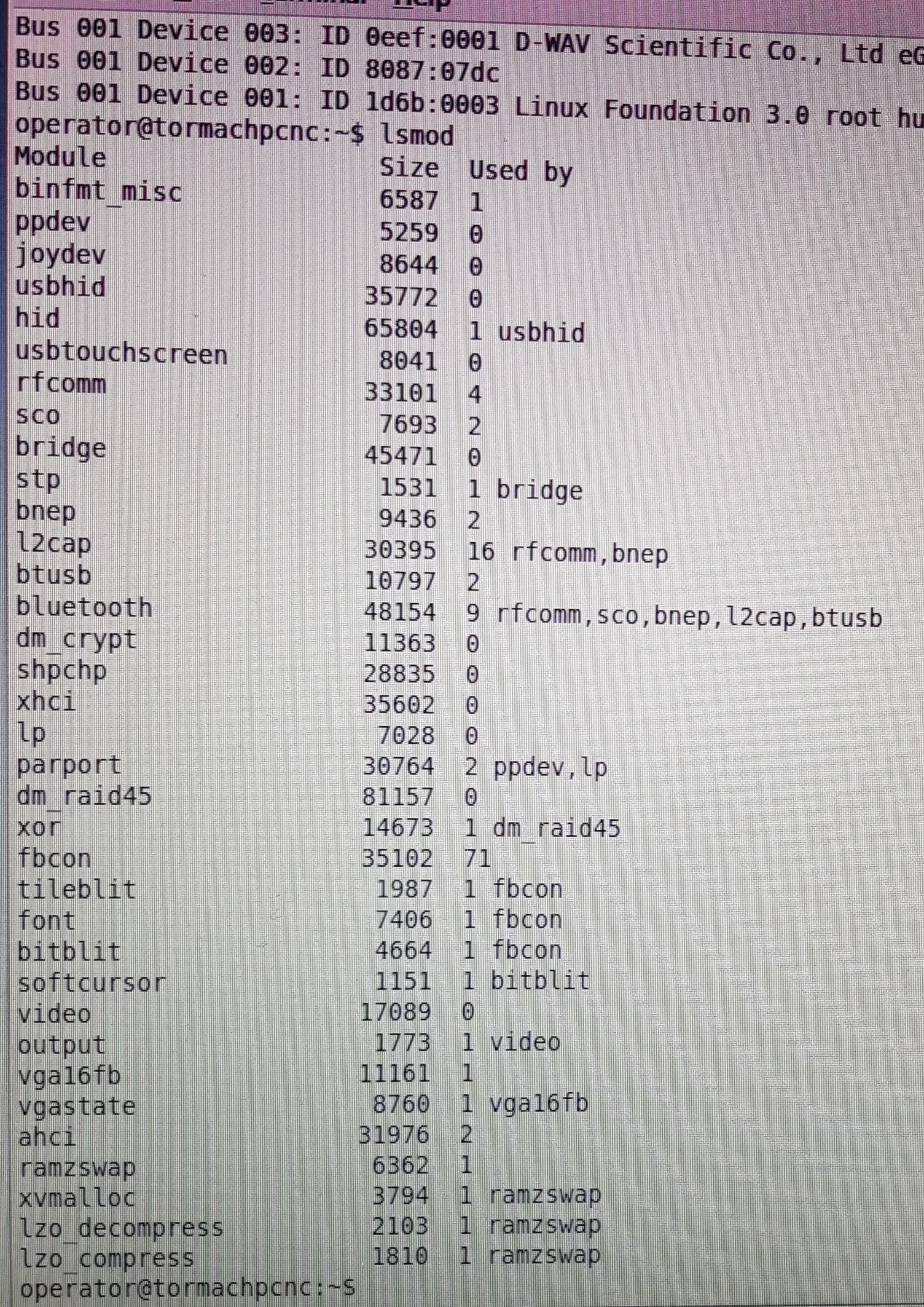

Can you try this:
Did you edit the grub.cfg file ?
If not you maybe in luck.
Try this:
tormach.zendesk.com/hc/en-us/articles/36...athPilot-controller-
Code:
lsmod
Try this:
Last edit: 6 years 3 weeks ago by BeagleBrainz.
