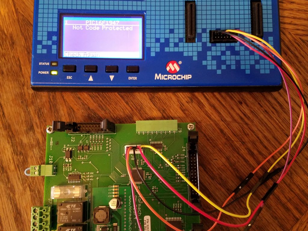

I am interested in the lathe ATC board and its interface to PathPilot.
My Denford NovaTurn uses the 7i77 and 6i25. I am currently working on a PIC16F 887 to decode and control a bi-directional turret.

I think we have enough information from the schematics and firmware to reverse engineer quite a bit. I have a PIC 16F1947 and development board to test out the firmware and monitor the inputs/outputs with a logic analyzer.

I finally have my hex file running.

Have you ever used the "MPLAB PM3 Universal Programmer" ?
Iron-Man
Great to see you are feeling better.

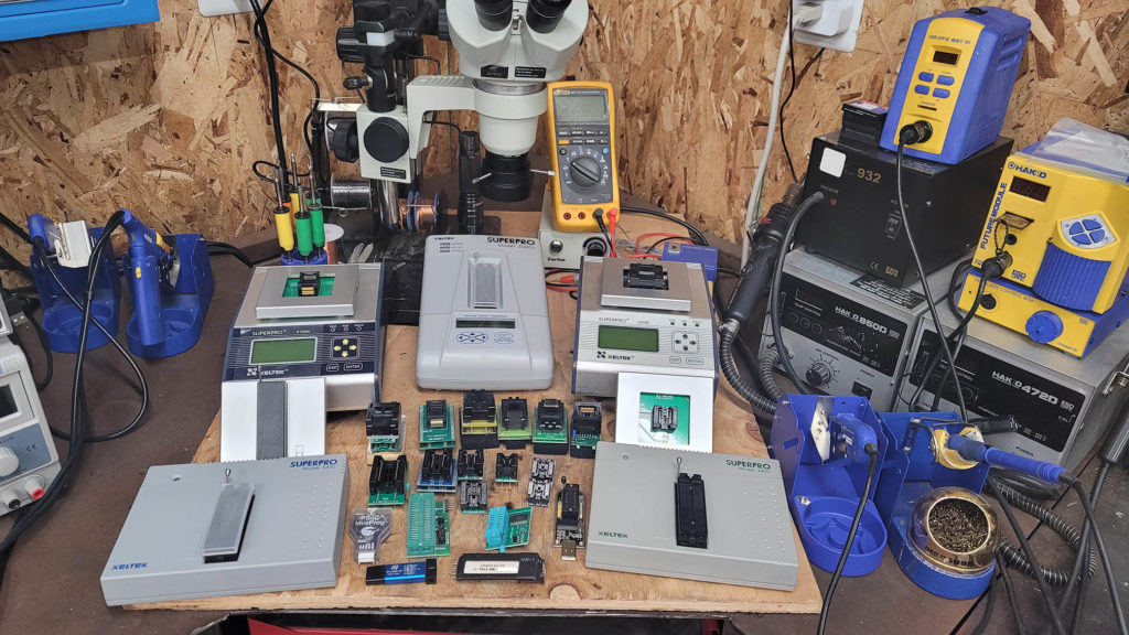

Yep I used to own one dumped the slant lathe pic the 1st day I got the board LOL. I really do not like the microchip studio the Xeltek is much better programmer. I do device programming as a part of my business.
I have owned many Xeltek programmers, Currently down to just the 6100N, 5000E, and 3000U. (Old Photo)
