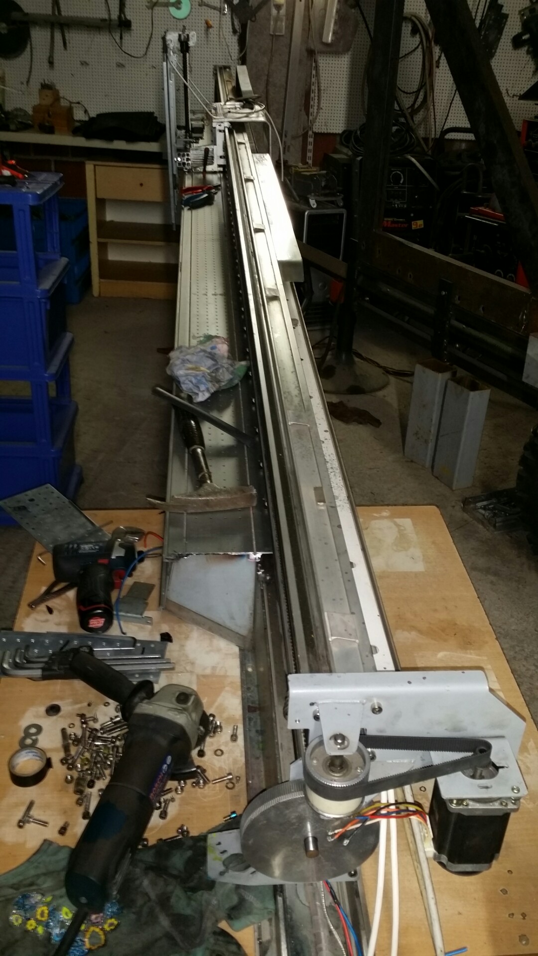

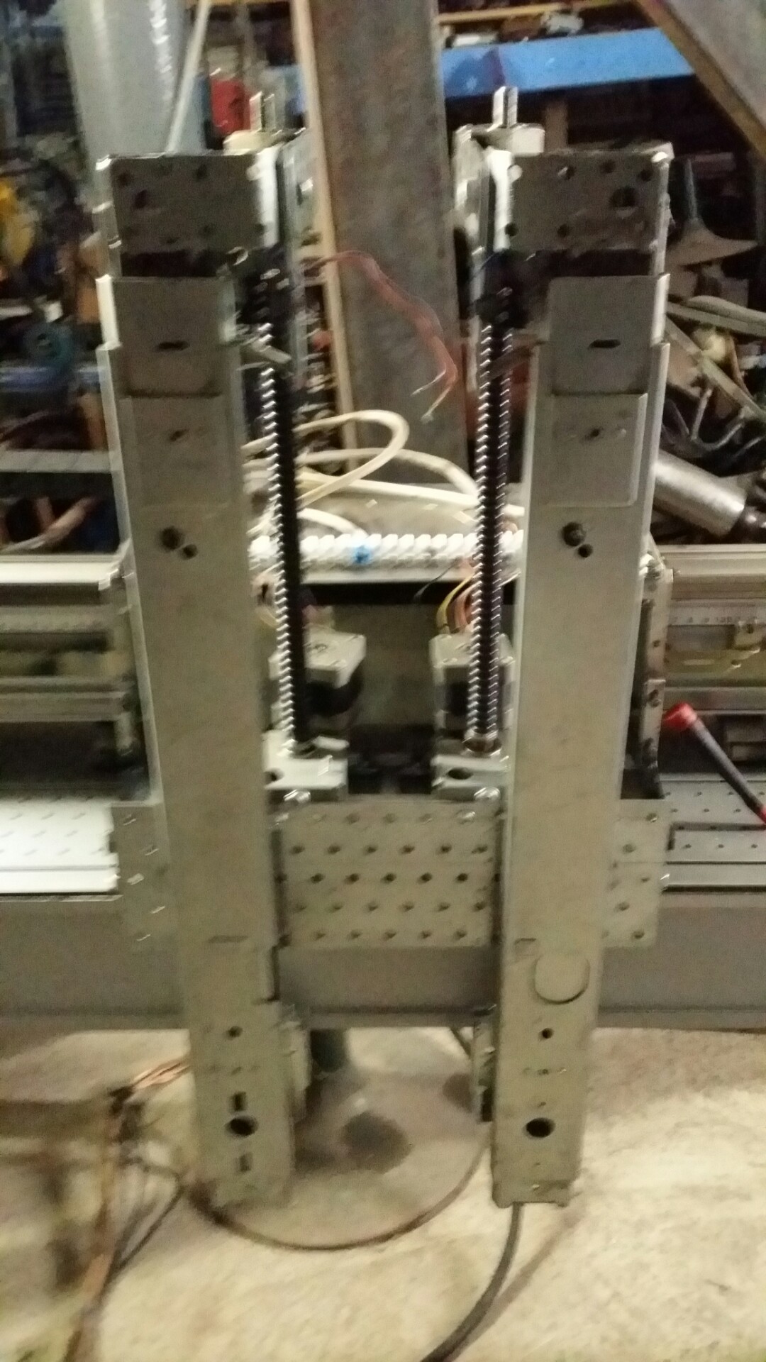

Last 3 days been bussy building the dual Z axis for a new cnc plasma cutter.
The gantry is over 4 meters long taken from a ploter so the max working length is 3.7 meters. Left the rails and cariage as is, the cariage is 32cm wide so more than enough for plasma.

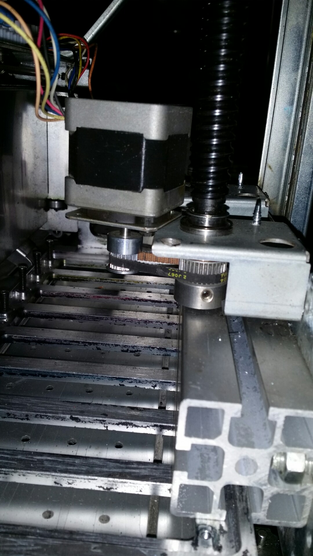

This is how the Z axis looks like now, two double drawer slides from old photocopiers, beefy ones capable of 25 kg each, two 16mm Nook ball screws with 5.08mm pitch (1/5 inch), two nema 17 stepper motors, all bolted to a 45X45 mm Bosch aluminium extrusion and that bolted to the existing cariage.
Side view, just in case

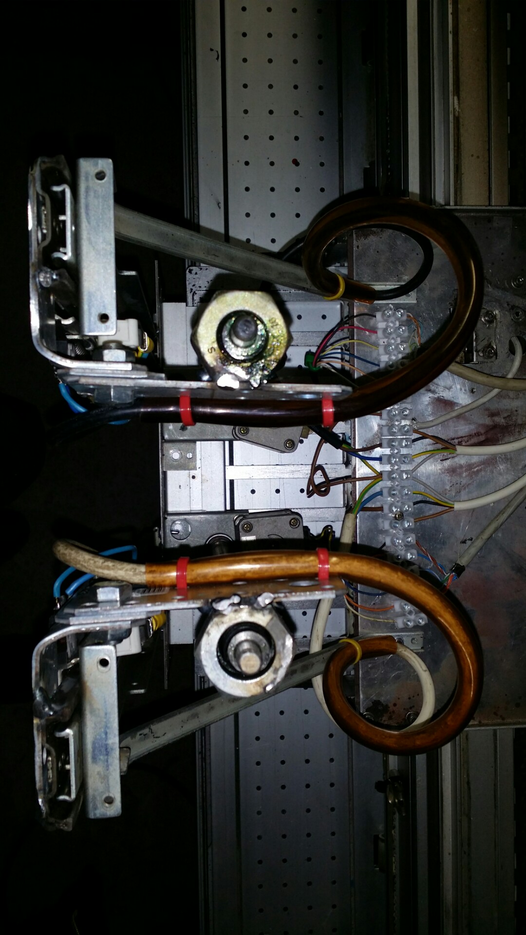

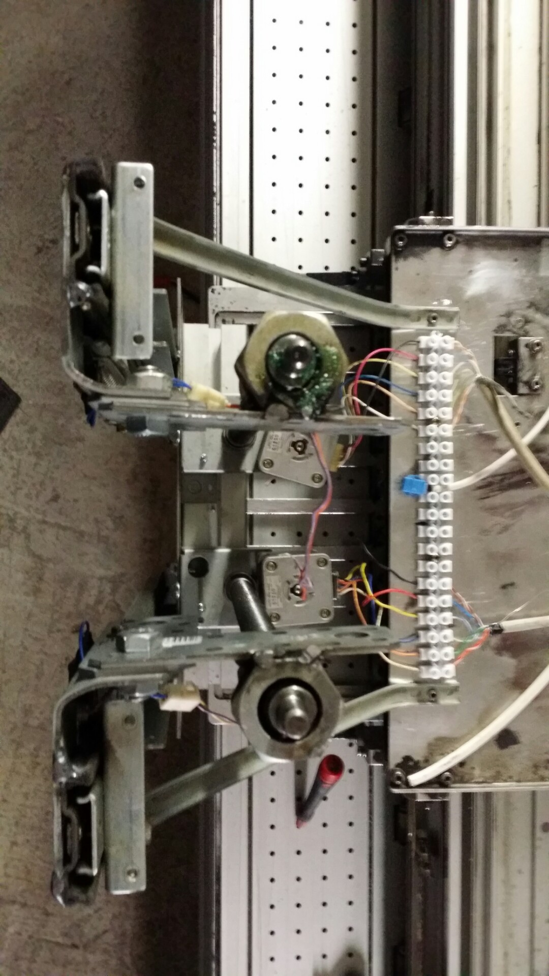

And a view from above, already made wiring look a bit nicer but forgot to take a picture.
There are also two micro switches used for probing and 2 springs to pull one rail down if gravity fails to do that.

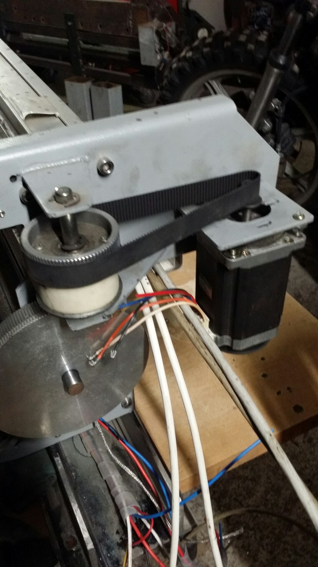

This is the right side of the gantry where the motor for the long move is, i decided to have it move quickly so i put in a nema 24 ( not 23) 5A Sanyo Denki, should be capable of ripping the belt appart easily. Going to use two more of the same for moving the complete gantry on both sides.
This is a side picture of the assembly, taking a frontal picture is not an option as i have 2 of my bikes and 2 bicycles and a lot of mess behind it.

Tommy, Looks great. You are certainly faster at this than I am!
I could not work out the stepper dive on the gantry. Is there a worm drive in there somewhere or is it belt driven?

Good morning Rod
It is belt driven, the white thick one under the black to motor, 8 meters of it.

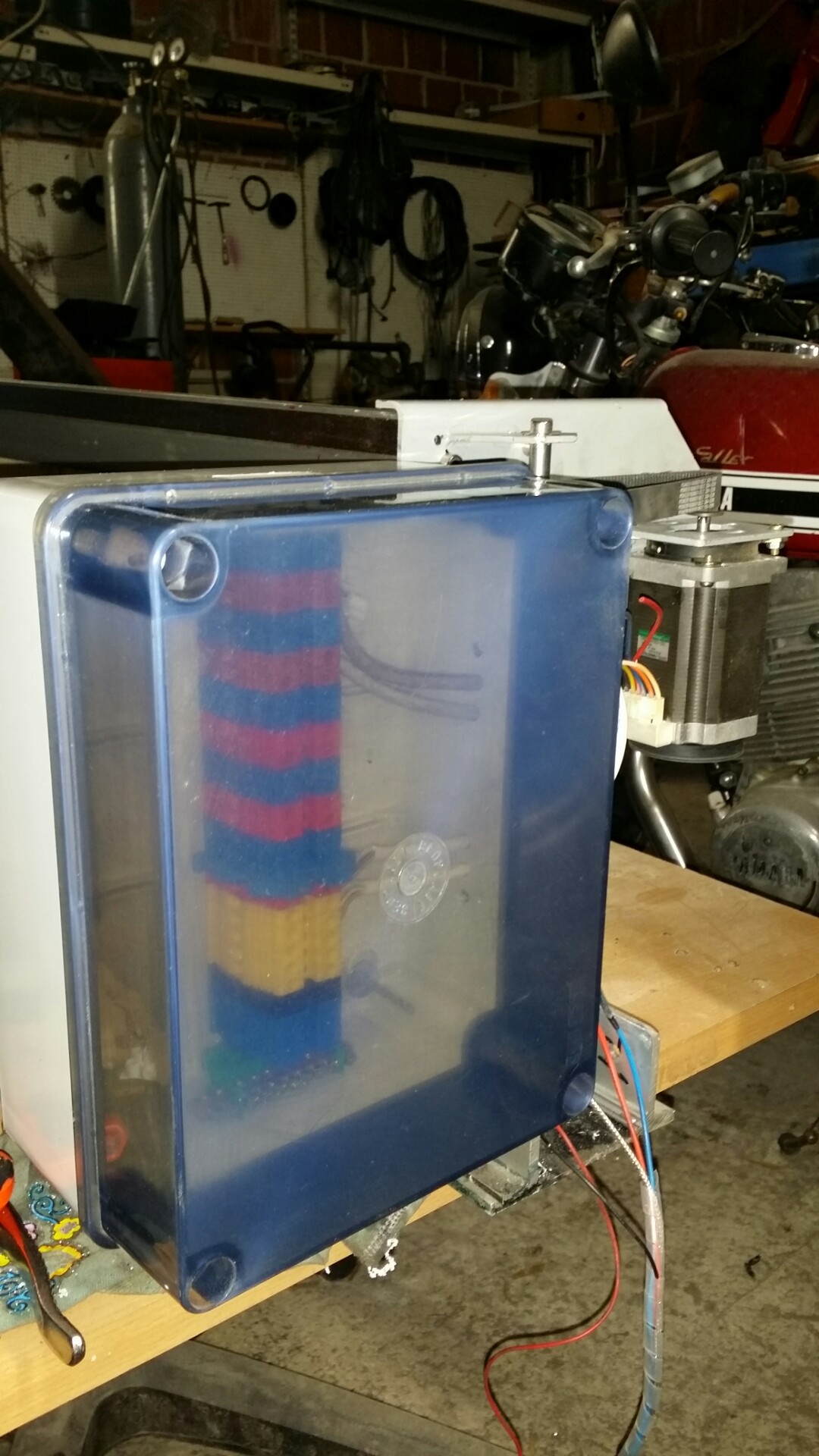

Had to change 4 micro switches, they where normaly open, i like to use normaly closed so if they disconnect, it will alert. Also added a box for wiring so it looks more pleasing. I plan on installing white LED lights under the gantry the whole length, and add red green and blue LED on the Z cariage, so when i make the thin plastic enclosure, it will have status colored lights as per RodW instructions. It will be a nice WOW effect for sure.
This is the interconnect box
Also added some tubing for probe and limit switch wiring on the Z axis to prevent them from tangling on moving parts.

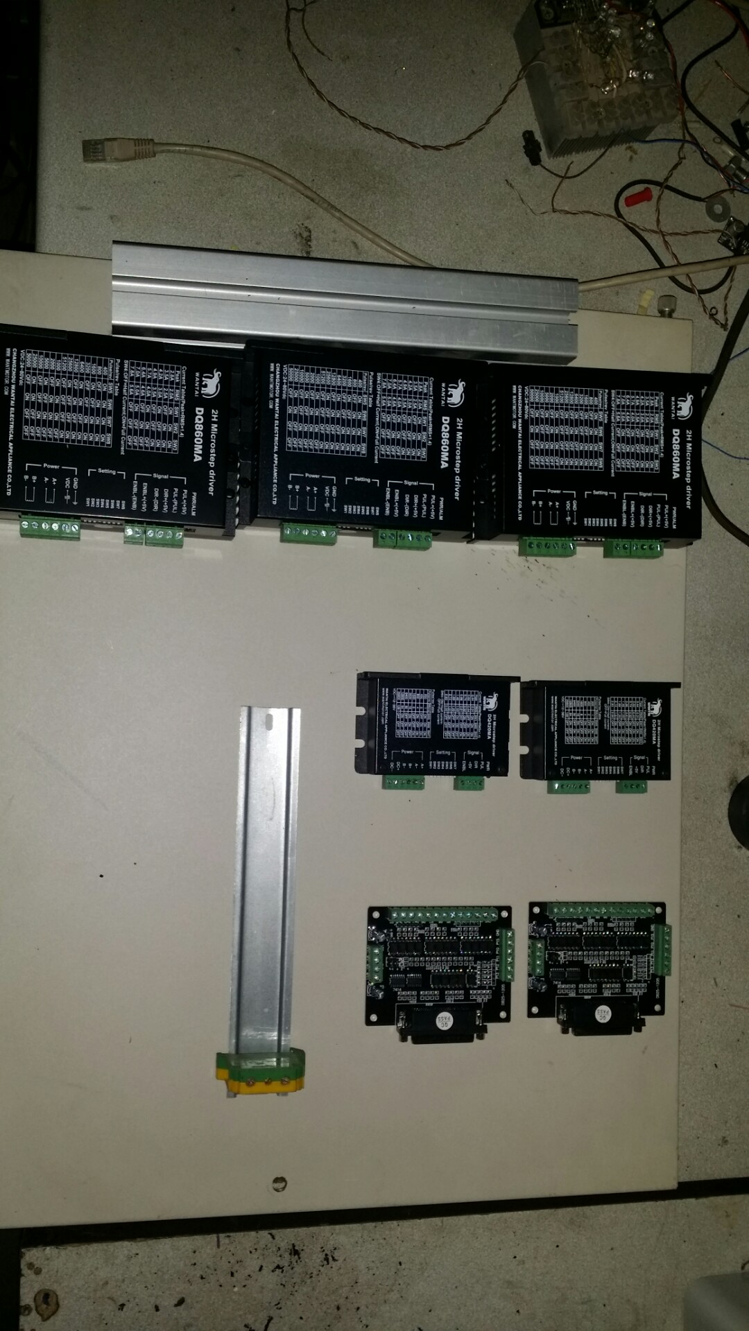

Last night i recieved the vantai drives, 4X422 and 3X806 and 2X BOB. Unpack and mount on a piece of plate, added plenty of stuff, so tonight i was doing the wiring and testing. Had some serious troubleshooting with BOB's since the output signal is realy bad, like horror show bad, on the Tektronix scope it looks like saw blade, not a nice one at that.
On the other hand, drives work perfectly, current control is all good, checked with DC current clamps, current reduction at idle works as advertised, agan clamps, microsteping works perfectly smooth, again clamps while running the motors realy slow to se the current change, no heat after half hour of testing at 5A RMS, motor Sanyo Denki 5A got mildly warm during the test.
All in all, very pleased with the drives, especialy after using Lam Technologies drives, they are without a doubt the best stepper drives money can buy. I have yet to see drives that can do 200kHz pulses without a hitch, and can not be destroyed on purpose ( i did try, even reversing the polarity of the power supply will not kill them, misswiring the motor between different outputs, nothing.)
The only problem, price, 2 vantai for 1 Lam Tech.
Will have to order some more vantai for sure
Here is a picture of them while i was thinkin on how to mount them for reduced wiring, ended up diferently so will add another picture tomorrow.
