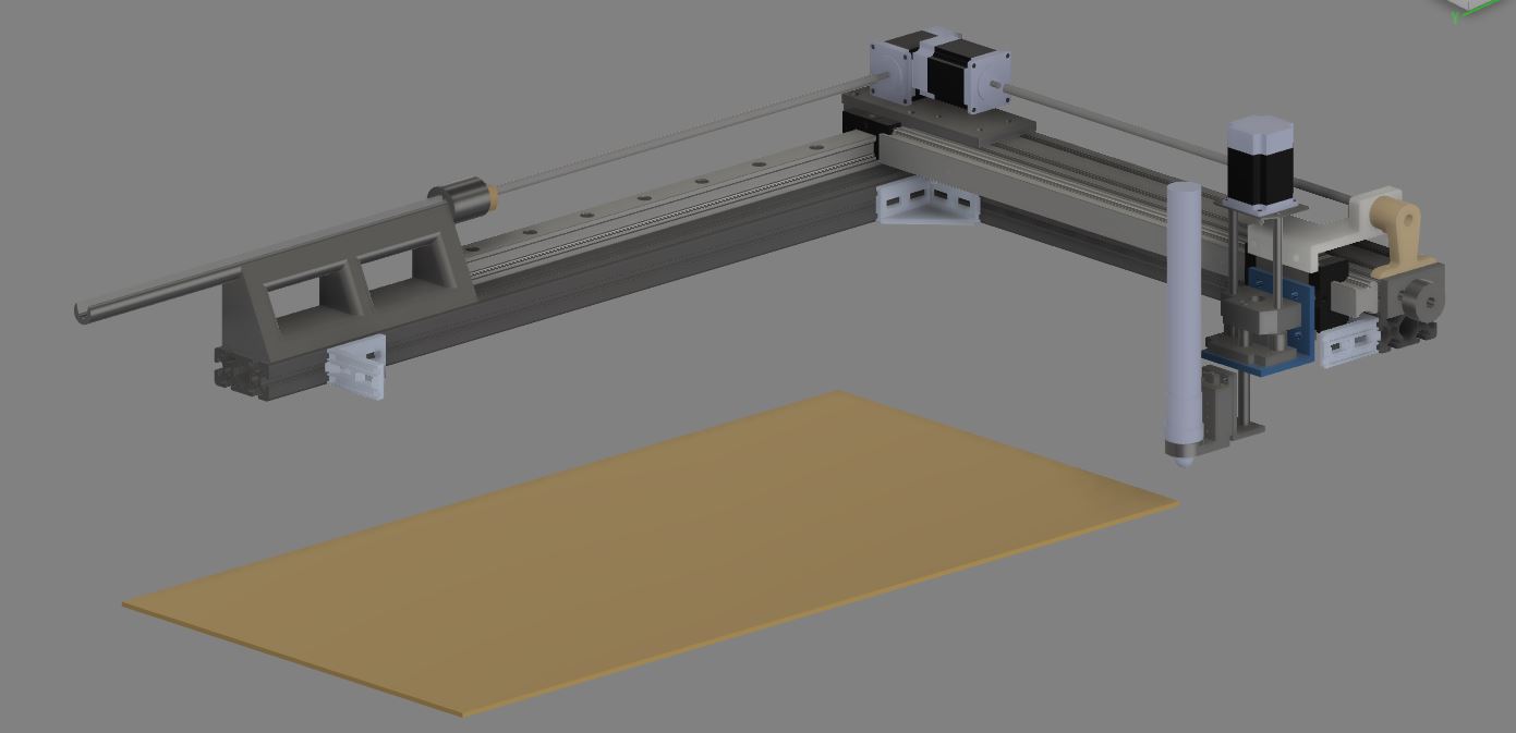

Step by step.....

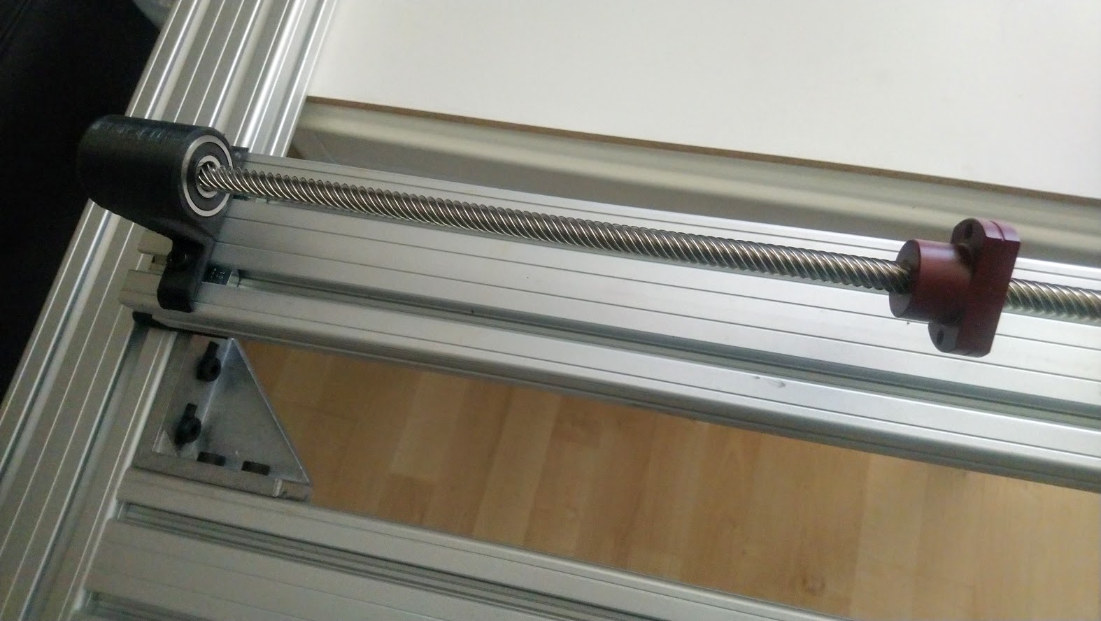

Some more progress, now Y axis support is in the works ( not ready)

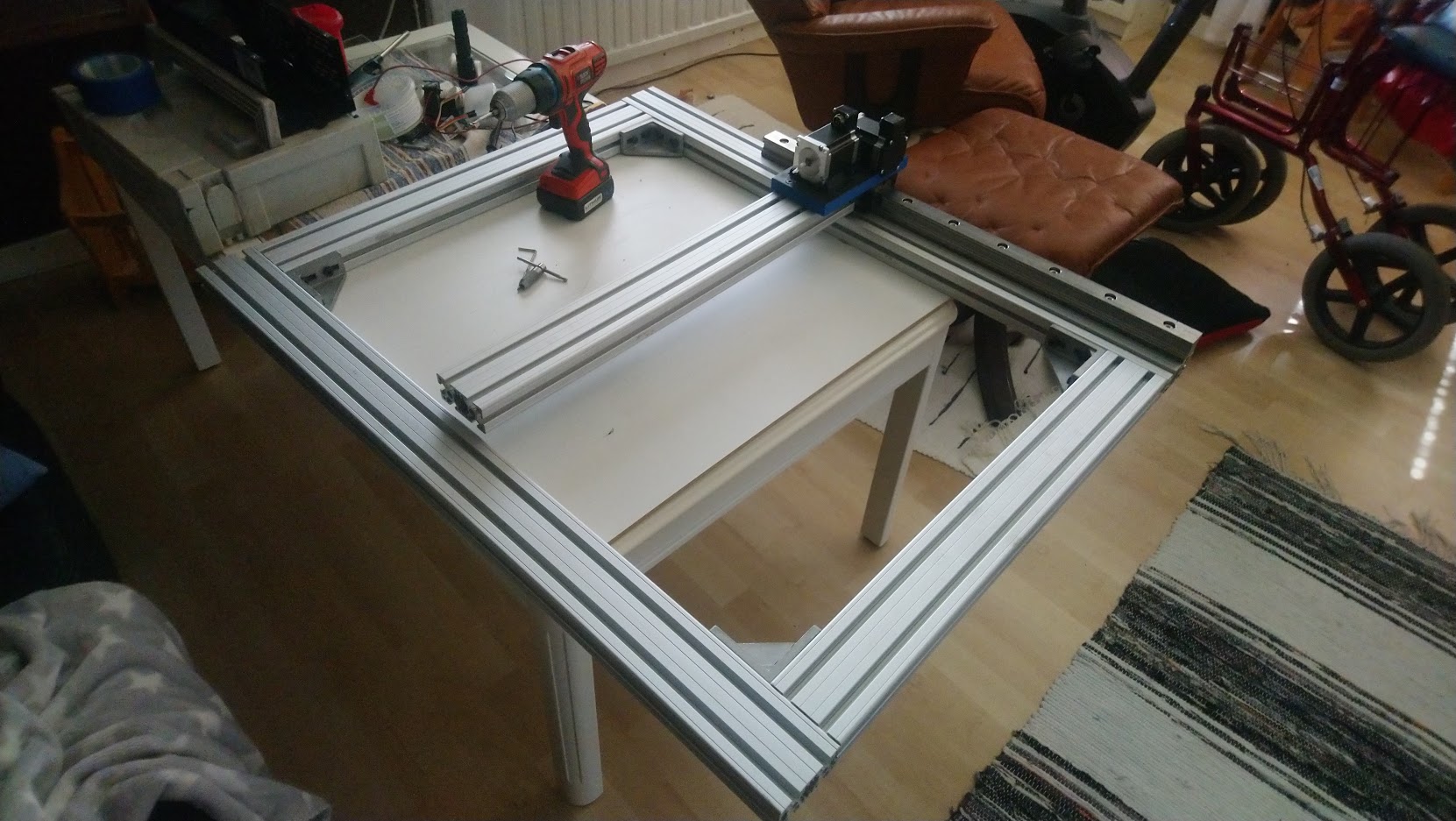

16 Jan 2020 15:43 #155026 by tecno
Replied by tecno on topic Low budget plasma setup, what do I need?

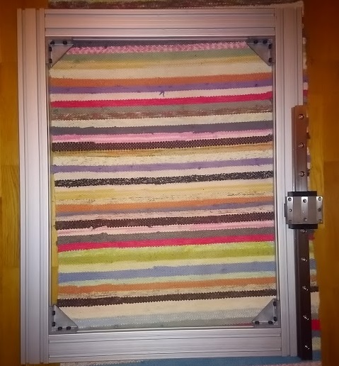

At last the frame is assembled, got the parts for this few days ago. Weight now 16.9kg

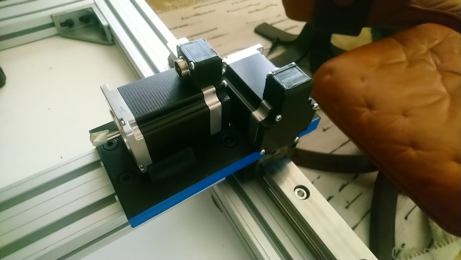

07 May 2020 12:23 #166957 by tecno

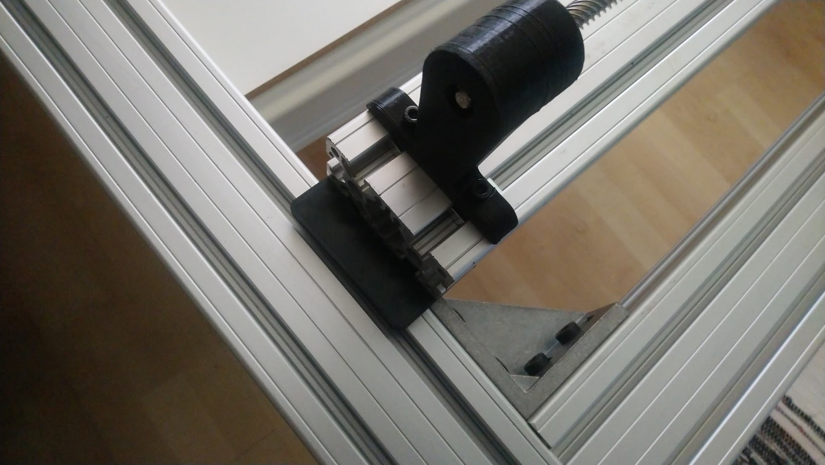

Here som progress on my build.
3D printed the X/Y coupling.

07 May 2020 12:44 #166960 by tommylight
Replied by tommylight on topic Low budget plasma setup, what do I need?

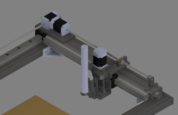

Nice and clean ! :)
Those two motors look a bit off, what is the drive going to be ? Belts ? Screws?

07 May 2020 12:46 - 07 May 2020 12:47 #166962 by tecno
Last edit: 07 May 2020 12:47 by tecno.
  • tommylight
  • tommylight's Avatar
  • Away
  • Moderator
  • Moderator
07 May 2020 13:10 #166964 by tommylight
That works !
Thank you.

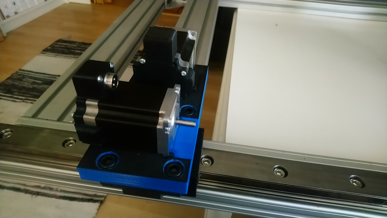

08 May 2020 07:22 #167015 by tecno
Some more details printed.

08 May 2020 10:21 #167023 by tommylight
Enjoy it while it is still clean, once you start using it, it will be dirtyyyyyyyy. :)
