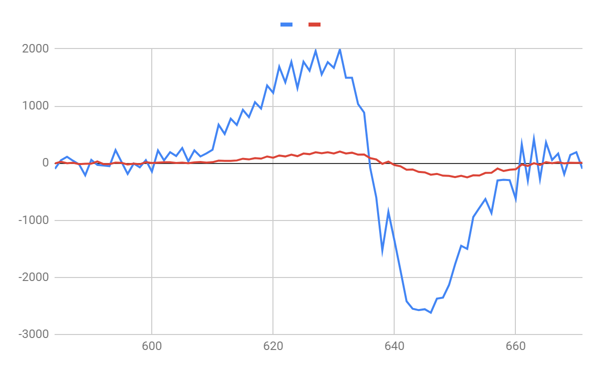

12 May 2019 11:07 #133547 by rodw
Replied by rodw on topic Kerf Crossing / Anti Dive
Phill, be careful with the period variable as it might be a system one in nanoseconds. The correct variable to use is fperiod which is calculated each servo cycle and is in seconds. Just check the halcompile docs.

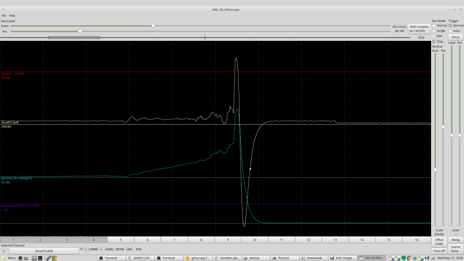

Its my understanding that most THC's monitor the change in voltage over time. This results in big numbers (as volts per second) eg:
(this_volts - last_volts)/ fperiod
But this value is several orders of magnitude higher when crossing a void than when normal servoing for torch height control. So if you calculate a dV/dT moving average of the last n readings (n might be 10, 100 or 1000 - to be determined), you have a slowly fluctuating smoothed benchmark to compare the current dV/dT for this servo period. I have not done enough samples to detemine a suitable threshold. A 1 volt change in a servo period results in a dV/DT of 1000 volts per second.
This plot I did shows clearly what happens when the data is reviewed in this manner and you can see how clearly the kerf cross is delineated.
Note that this data is not in real time. I think there are 20 servo periods per tick on the horizontal axis. I really think this experiment needs to be repeated using halsampler and I think one cut will tell it all

15 May 2019 08:25 #133824 by rodw
Phil, I really think your algorithim is a bit off the mark. Have you seen this patent?
patents.google.com/patent/US5866872
Review FIG. 3 carefully and you'll see similarities to what I observed leading up to my dV/dT approach.
If you wanted to explore a velocity based approach, I think you need to come up with an angle of the material at maximum warpage (2-3 degrees but I have no idea) and then calculate the change in voltage that could occur at the cut speed if the material was on that slope at the generally accepted 10 volts per mm, the inverse of 0.1 mm/volt. But then you need to allow for natural voltage fluctuations as the anode spot moves from the top surface (shortest distance, lowest voltage) to the bottom of the material.
So you'd come up with a formula something like
height_change = sine(theta) * (distance travelled per fperiod)
volts_change_threshold = cut_volts + height_change * change in volts per mm + anode_spot_voltage_variance + safe_margin
Where:
theta = maximum angle from warpage
Change in volts/mm = 10 (7.53v is what I measured)
anode spot voltage variance might be = say 1.2 volts (or your guess of what the normal voltage variance per period is.)
Safe_margin = your guess.(0.5-1 volt?)

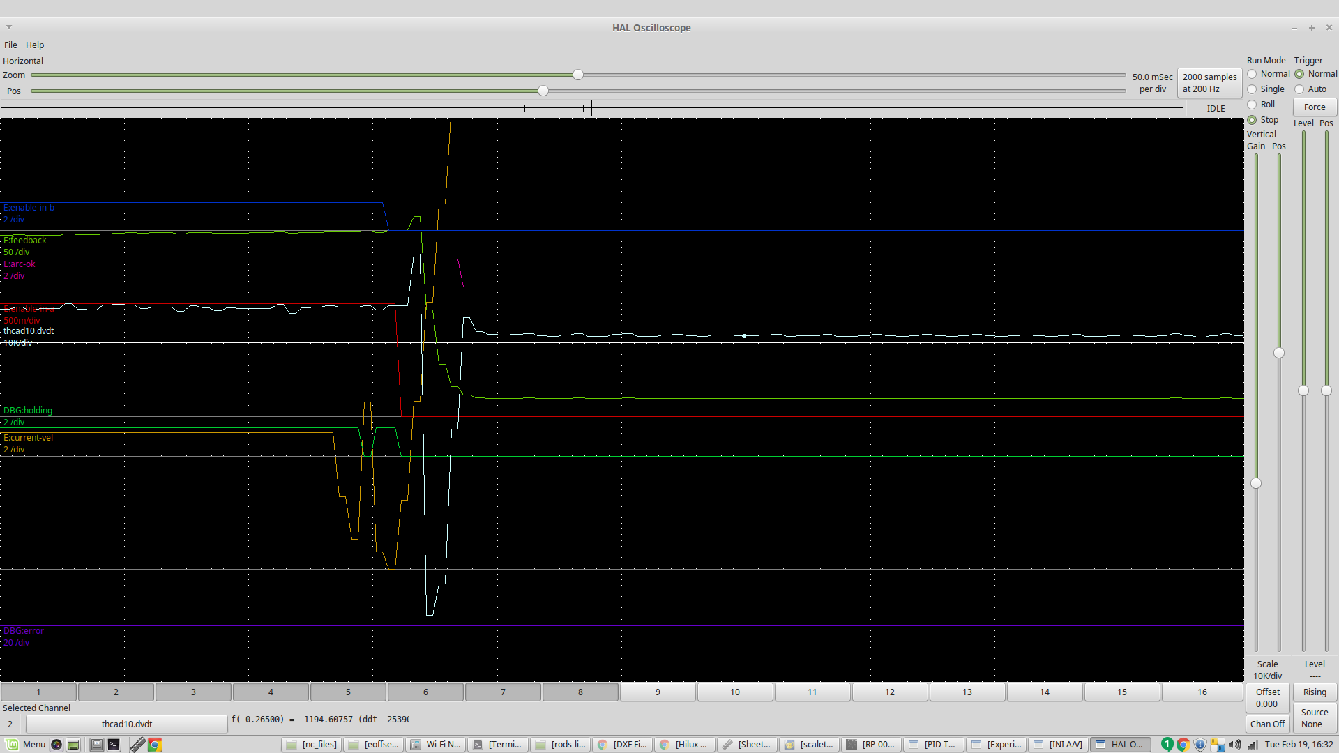

16 May 2019 04:18 #133944 by rodw
Phil, I know how you feel. I have left kerf crossing alone for exactly the same reason. My intent was to use halscope to observe behavior for a while before settling on a technique.
What if I change feed rates between cuts? Will this update correctly?
John, in a sheetcam environment I'm guessing you might add some cutting rules on holes or arcs or the like. Could you use a feed override to slow the machine down instead of the F rate?
Really to change cutting speeds, you need to use another plasmac material. One thing that was cool to watch was the plasmac GUI being updated from my centre punch tool on a holes layer to the profile cutting tool on the M190.
I posted this on the plasmac thread, but I guess it really belongs here dv/dt and torch voltage during a kerf cross
  • rodw
  • rodw's Avatar
  • Away
  • Platinum Member
  • Platinum Member
16 May 2019 04:52 - 16 May 2019 04:55 #133945 by rodw
Actually drilled down into this again at a much higher resolution (same plot), 10 ms/per vertical division, 1 ms per white dot between them
The normal cut was around 3300 up to 4000 very occasionally. So setting a dV/dT threshold of 5000 would catch a kerf crossing in 2 milliseconds. It would be hard to get better than that. White line is roughly at that 5000 threshold
I'm not sure that the torch voltage approach would be any quicker and on the face of it, the 1 volt change required would be within normal expectations of a 1-2 volt cutting range.
Last edit: 16 May 2019 04:55 by rodw.
