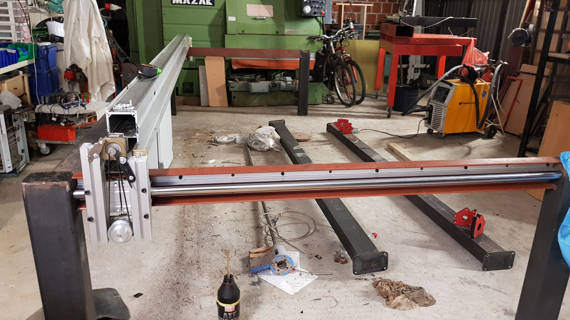

Last few days been working on this :
The machine dimensions are 4.2X1.75 meters, cut area will end up to 3.6X1.35 meters, so big enough.

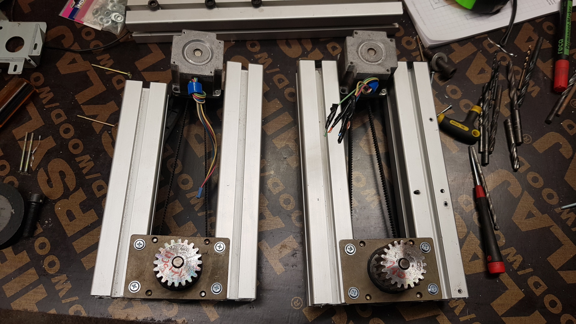

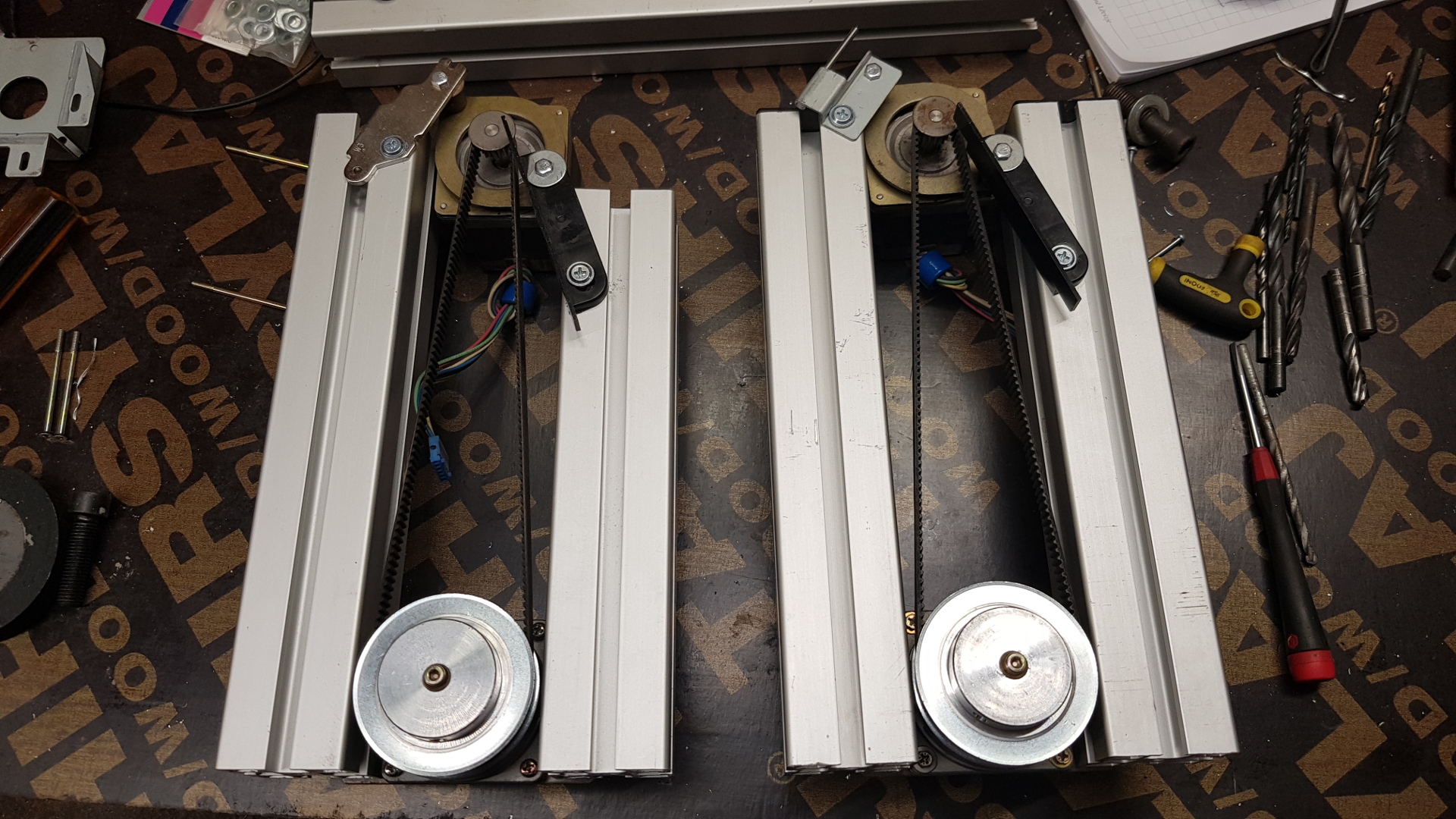

Here are some details of the reductions on both sides:
Other side

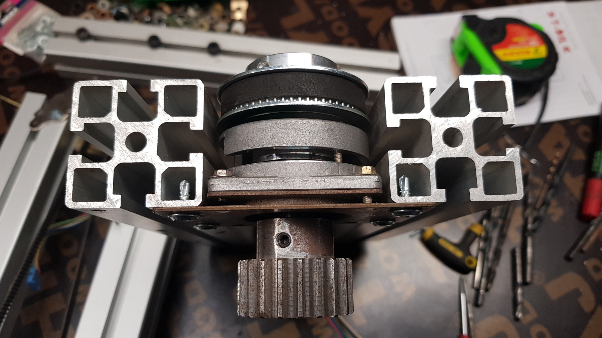

Bottom part where the pinion and the big pulley are mounted, gutted two healthy Vexta 5 phase steppers to get the bearing holders and bearings that did the job perfectly:

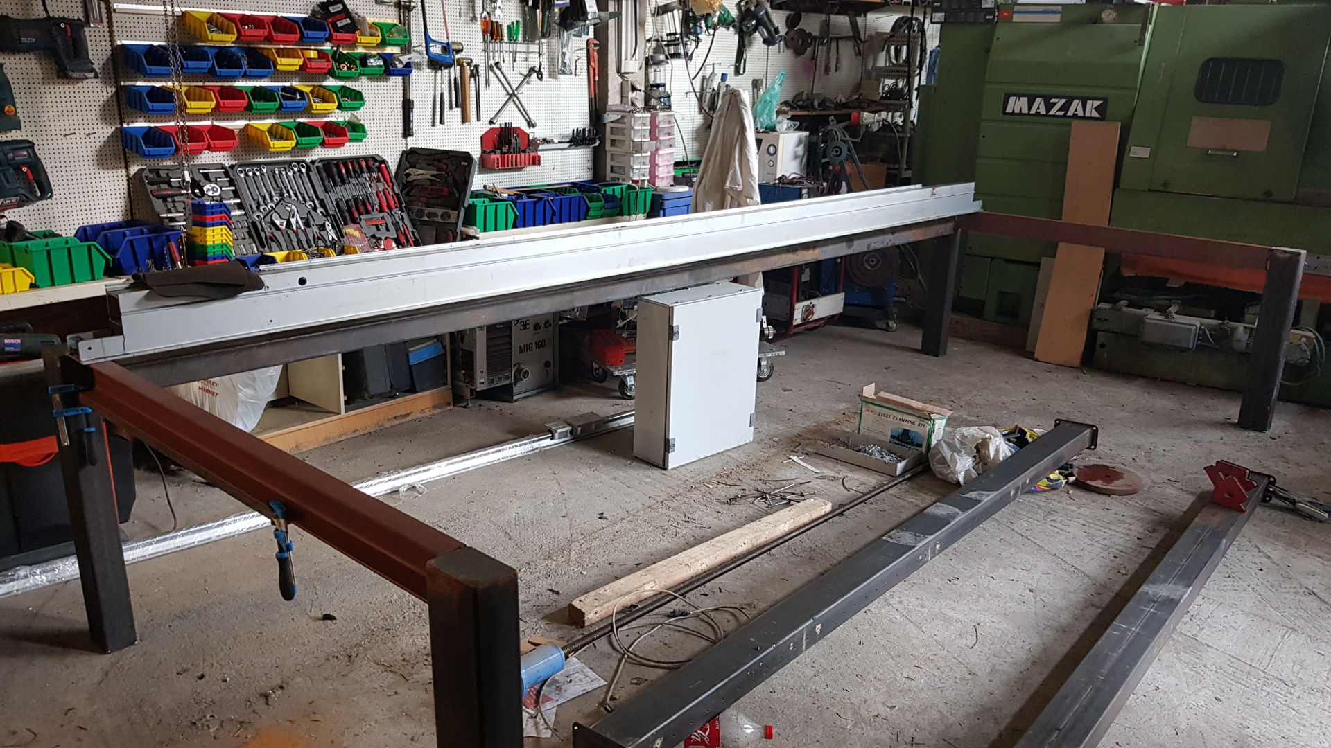

This is how the frame looked yesterday:
Another shot of the reduction in place:
Other side

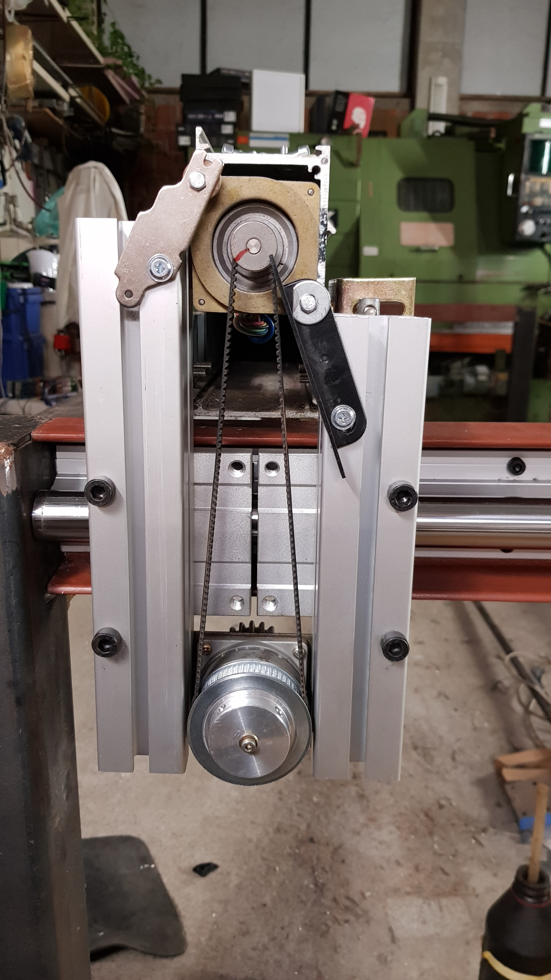

slightly bigger than what i have going on and it probably took you a week to toss it together compared to my 3 months of building
i'm amazed by the ability to toss it together so quickly.

Took me 5 days to make room for it as i had to rearrange the shop, to many things, waayyyyy to many things to move and clean !
This is my right hand after two days of drilling and taping hundreds of holes:
Back to work, no slouching allowed !

2 and a quarter days so far, full days from 10AM to 1AM!slightly bigger than what i have going on and it probably took you a week to toss it together compared to my 3 months of building
