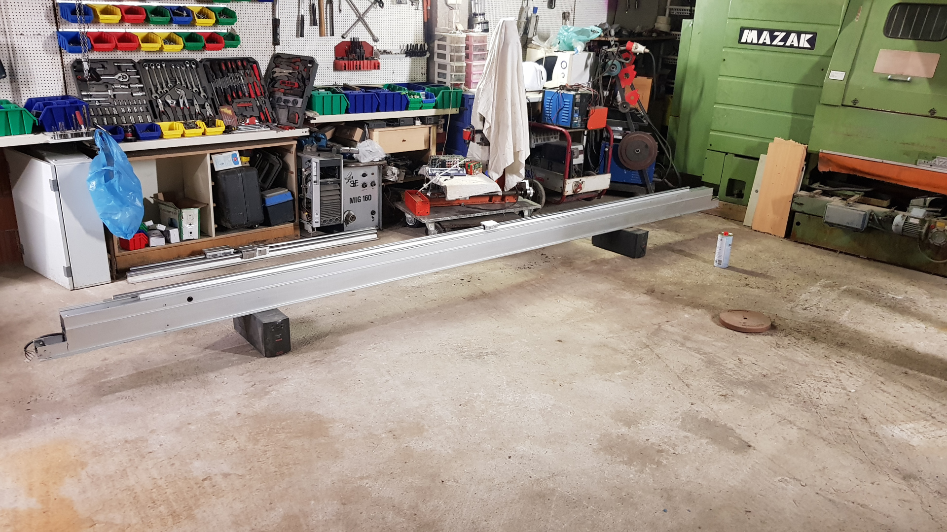

Replied by tommylight on topic 3.5X1.5 Meters cnc plasma cutter

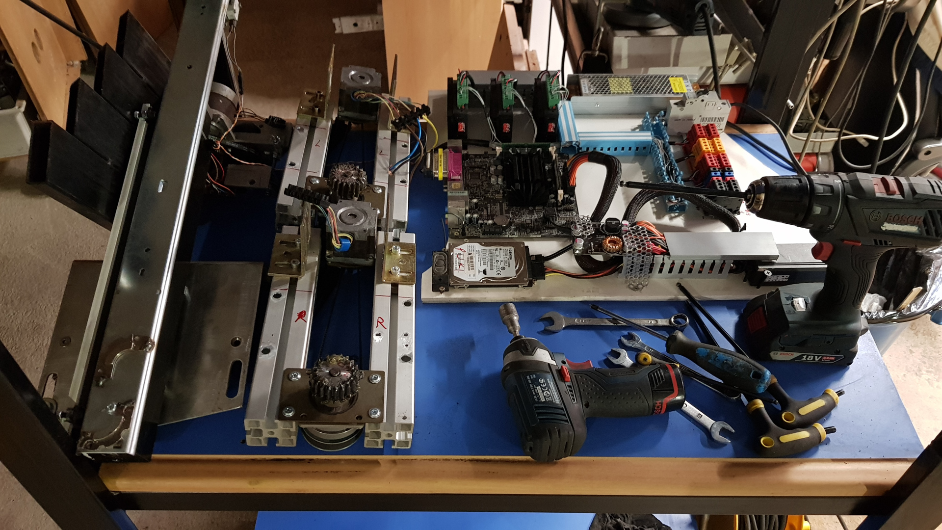

As ZZTop would say "the thrill is goneeeee", well the machine is dismantled and waiting to be painted tomorrow, hopefully. Oh, both machines are waiting to be painted.
The good thing, now the shop look's big and empty! Not for long, for sure.
Now we have a lonely and empty, dare i say "naked" gantry waiting patiently to have a lot of stuff bolted to it:
And here are some of the parts to be glued to it:
Will try to take pictures as much as possible, but i might forget while i am working on it, i usually do!

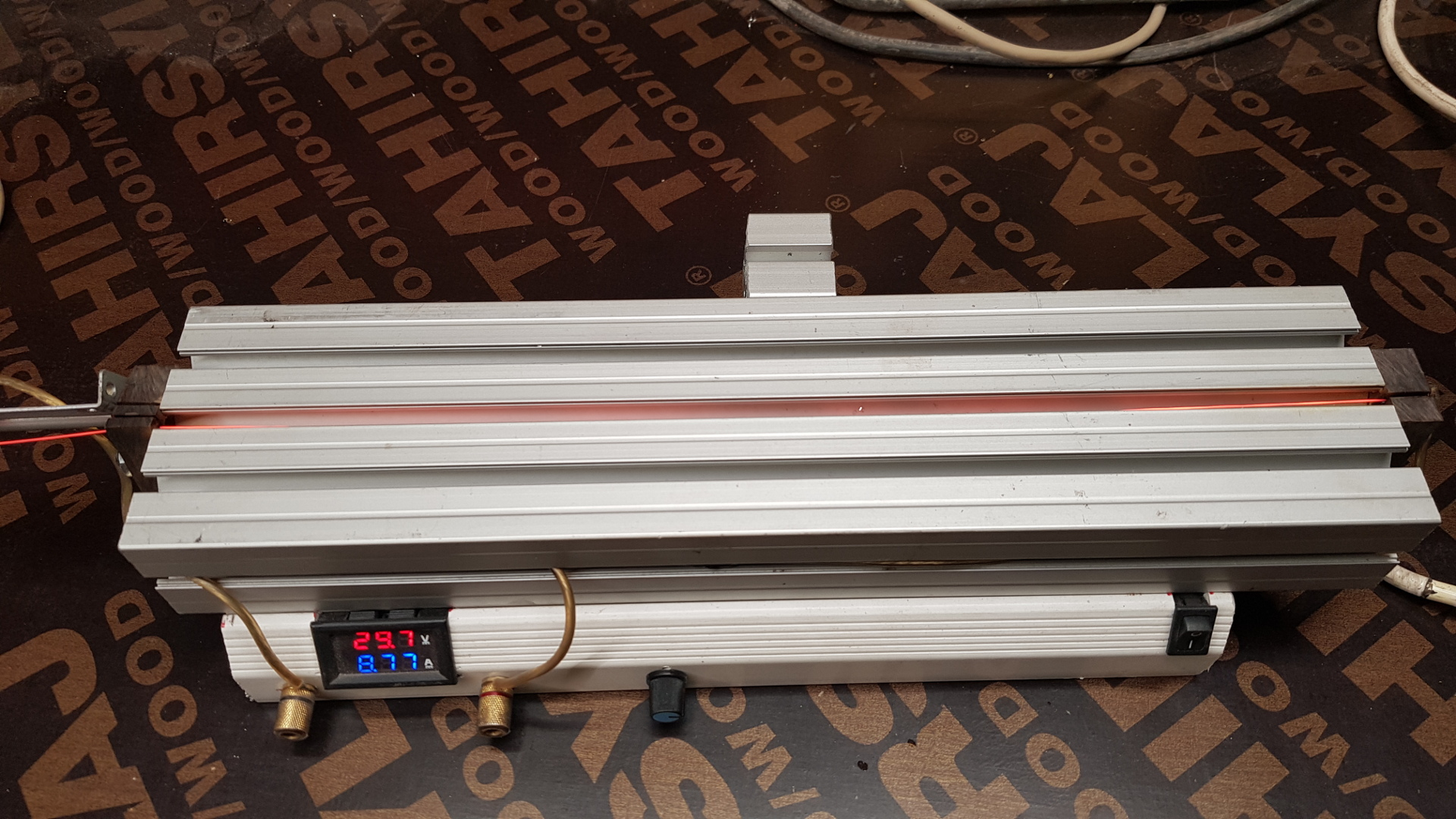

Supporting properly a plasma table is a must, after repeated dumping of metal plates it tends to sag and bend, although having a THC negates that quite a bit.
Those Dell's are really nice, had plenty of them and they never fail, but for some reason i can not find them anymore, they just vanished !
It was sunny till 2 days ago, now it feels like winter already and it gets dark a smudge after 5PM but i do not heat the shop, i get used to it, well till it gets to bellow -11C outside, inside is still above zero due to some computers that are on 24h/day.
Still waiting for painted parts, did some other things today, mounted permanently one of the rails on the gantry, did some modifications to the Z axis holders, modified a bit the reduction and changed the motor for a new one, checking everything again to make sure there is no point of failure lurking, etc.
Also built a small heater on an aluminium profile for bending plastic, used some thin guitar strings as a heating element, will come in handy when assembling the machines to make them look good.
Started building 4th axis for this machine as i found some nice gears and chain with a ratio of 1:5.6, should do nicely powered by a 3NM stepper motor for cutting round tubes. Need two more of these as i already did one such reduction last year and it did work properly up to 200mm diameter. The only thing i do not like is that i have to use lathe chucks and they are bloody heavy so the acceleration has to be quite low.

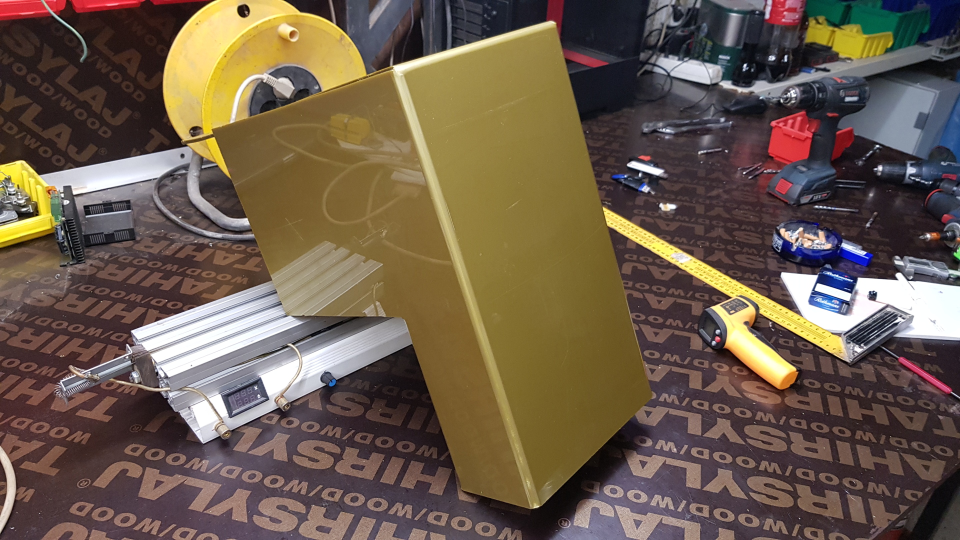

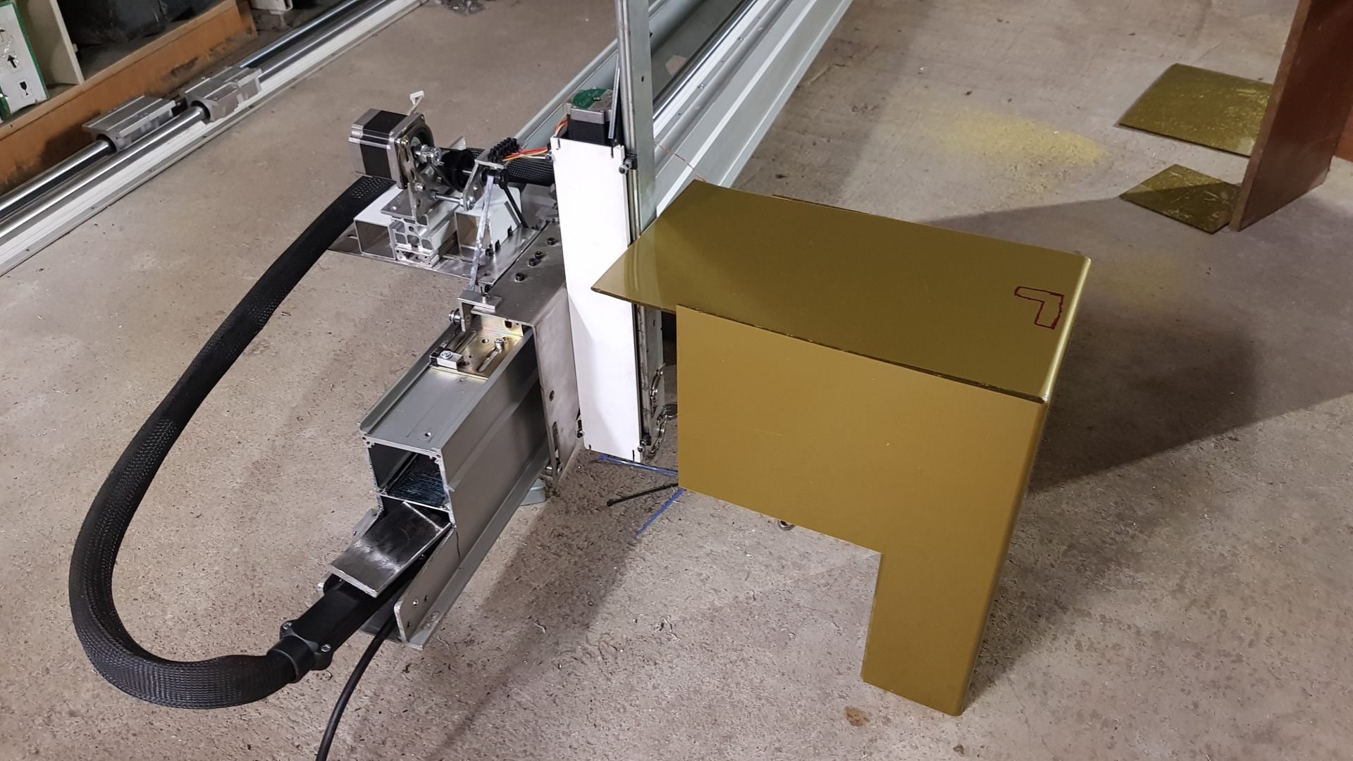

Evening was much more productive and painful as i burned both of my hands a bit working with plastic, remember i made a heater for bending plastic a while back ? Well i put it to good use today and here are the results:
Made out of a single piece of 5mm thick plastic, as fate would have it, that was the only piece big enough, i do have some white 2.5 and 3mm thick in smaller sizes, more on that later.
Back side of with flanges for mounting.
This is the "Machine" that does the heating, basically an adjustable power supply, a piece of aluminium 50X100mm and two thin guitar strings. Worked like a charm, as my hands can testify !

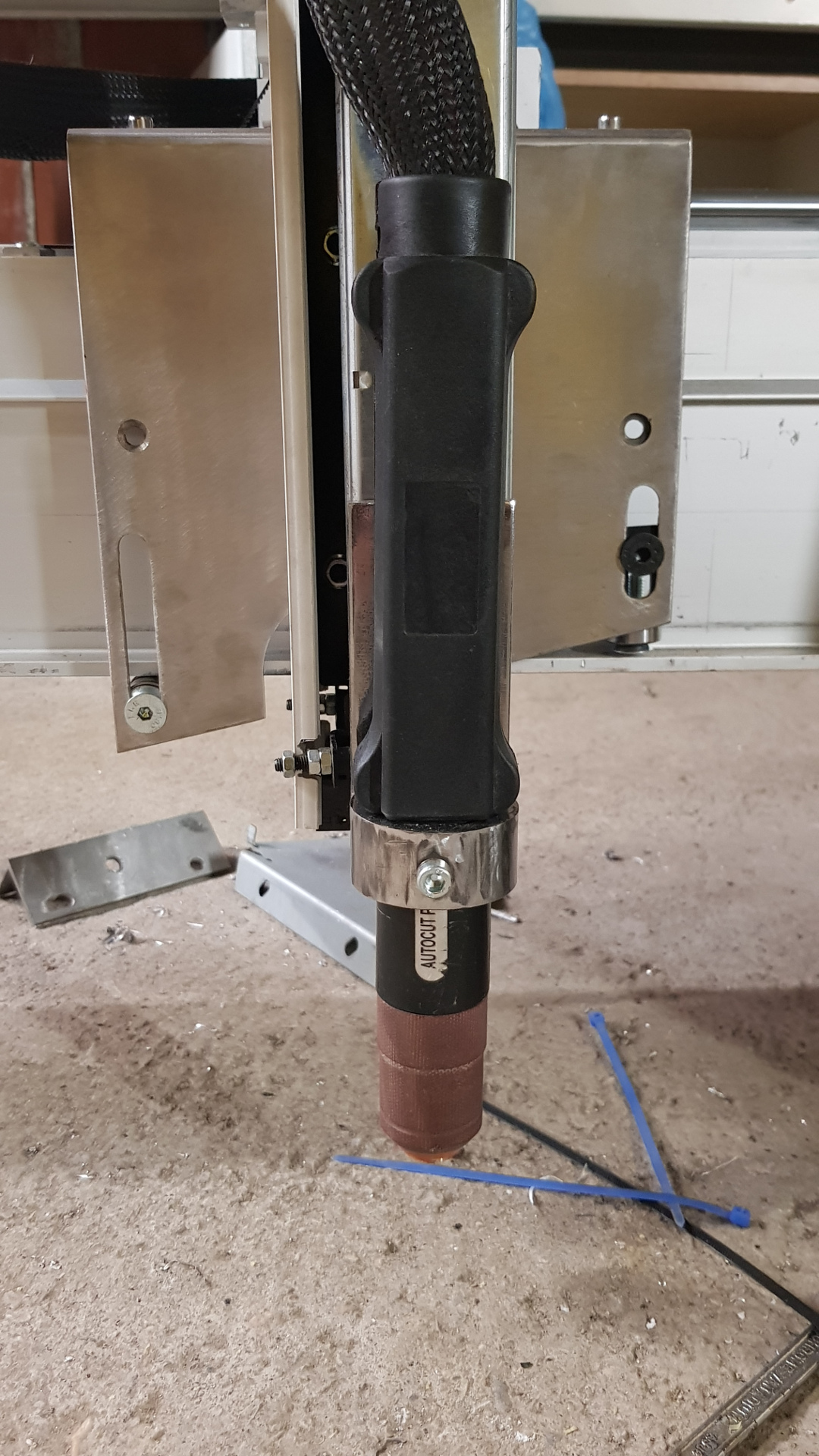

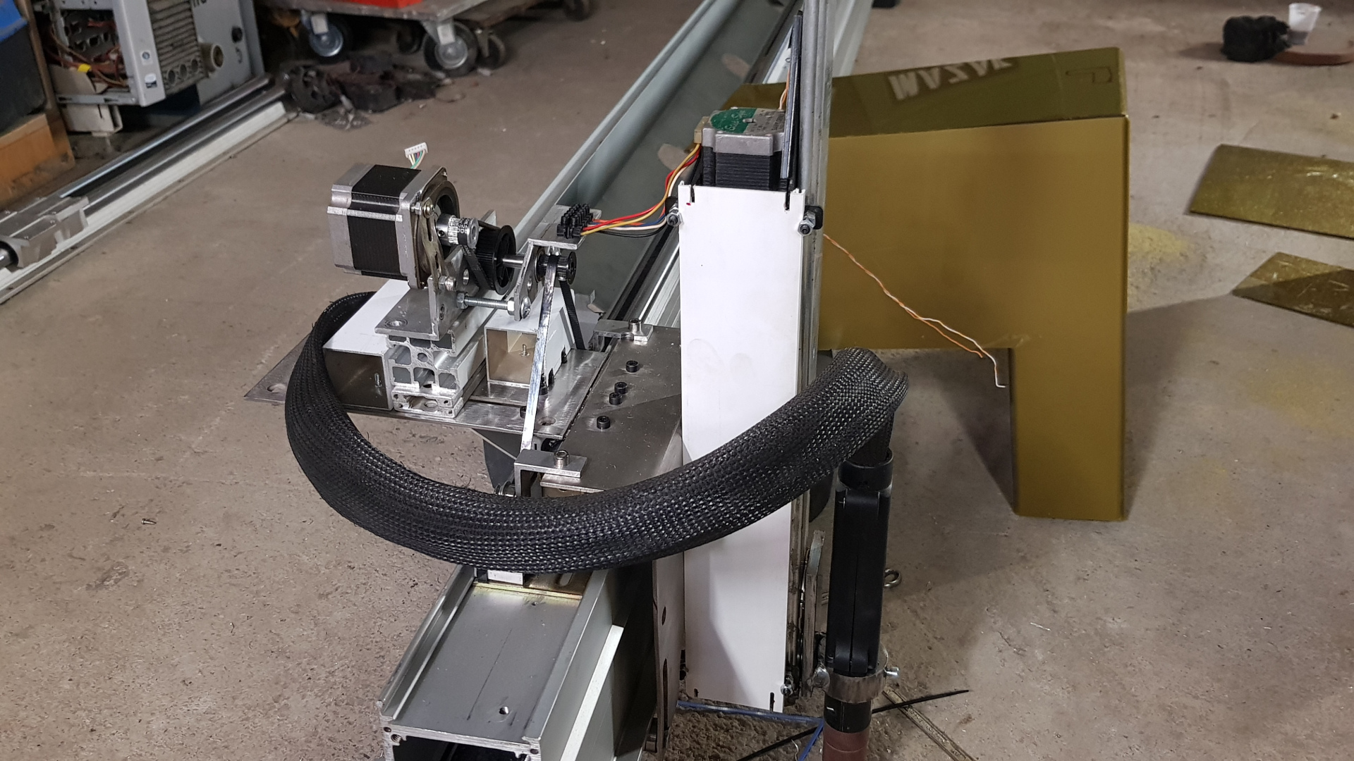

Some preliminary test fitting and marking for the protruding part.
New Trafimet autocut A141P torch. The body is from a cheap welding torch.
That same torch in it's rightful place.

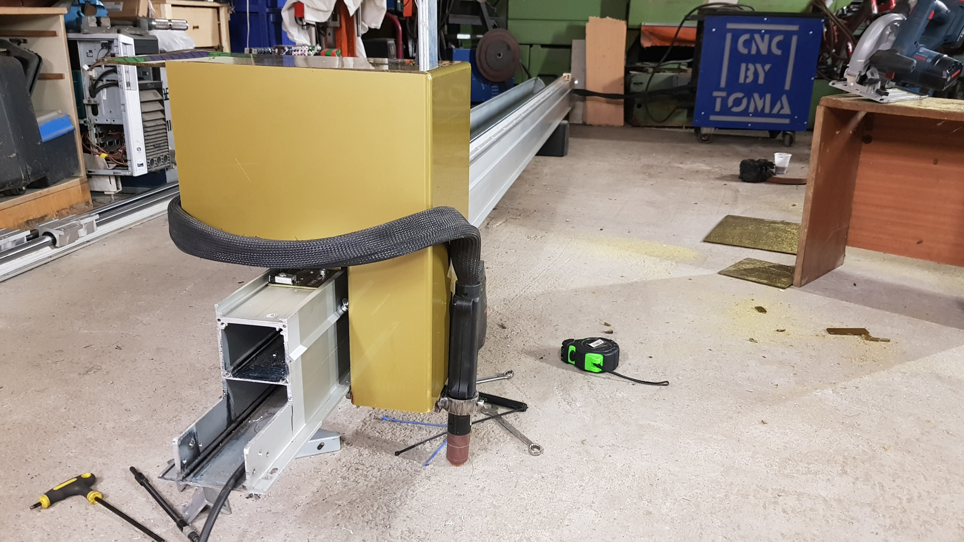

Next post, it is 6 picture limit i think.

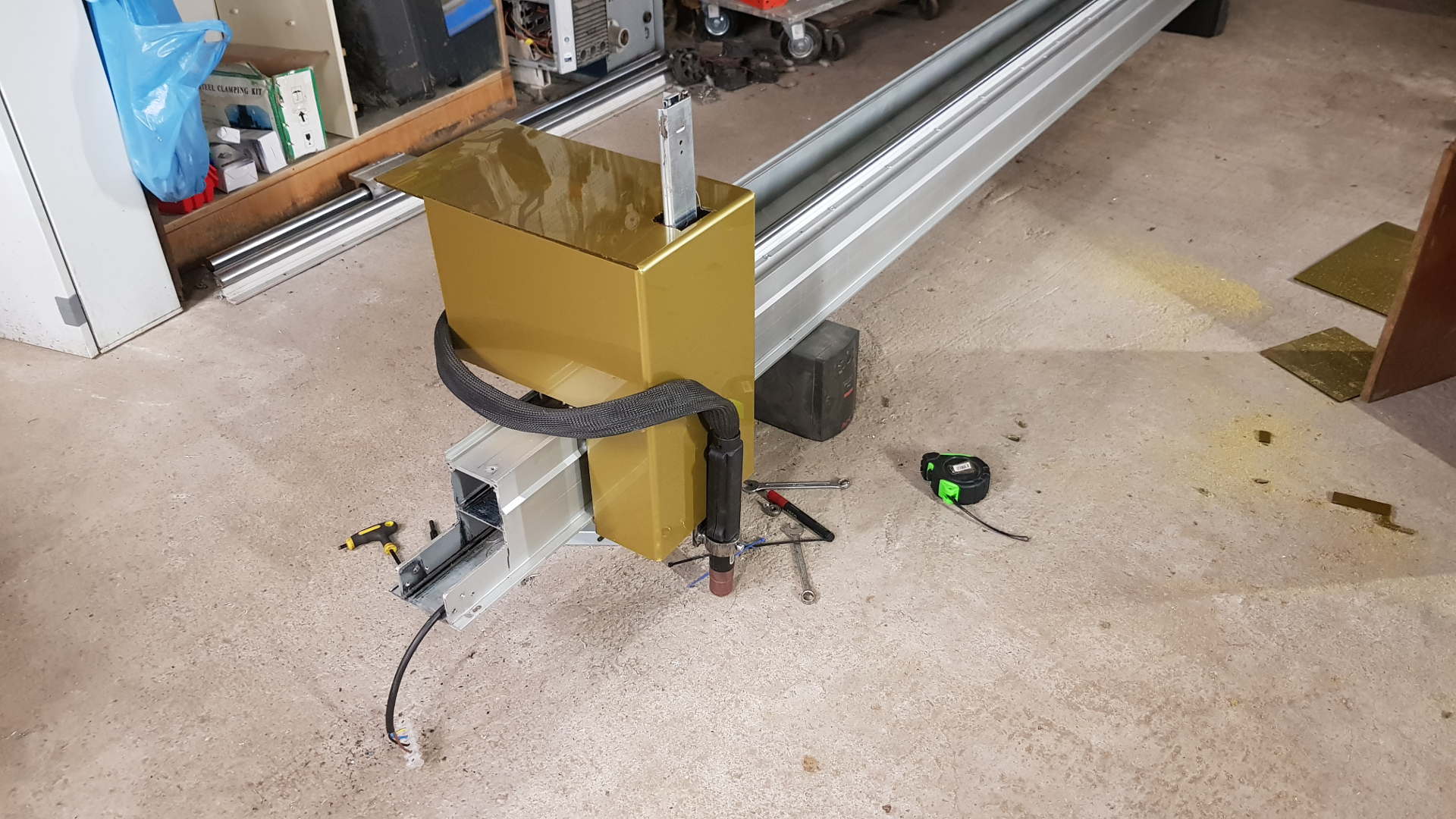

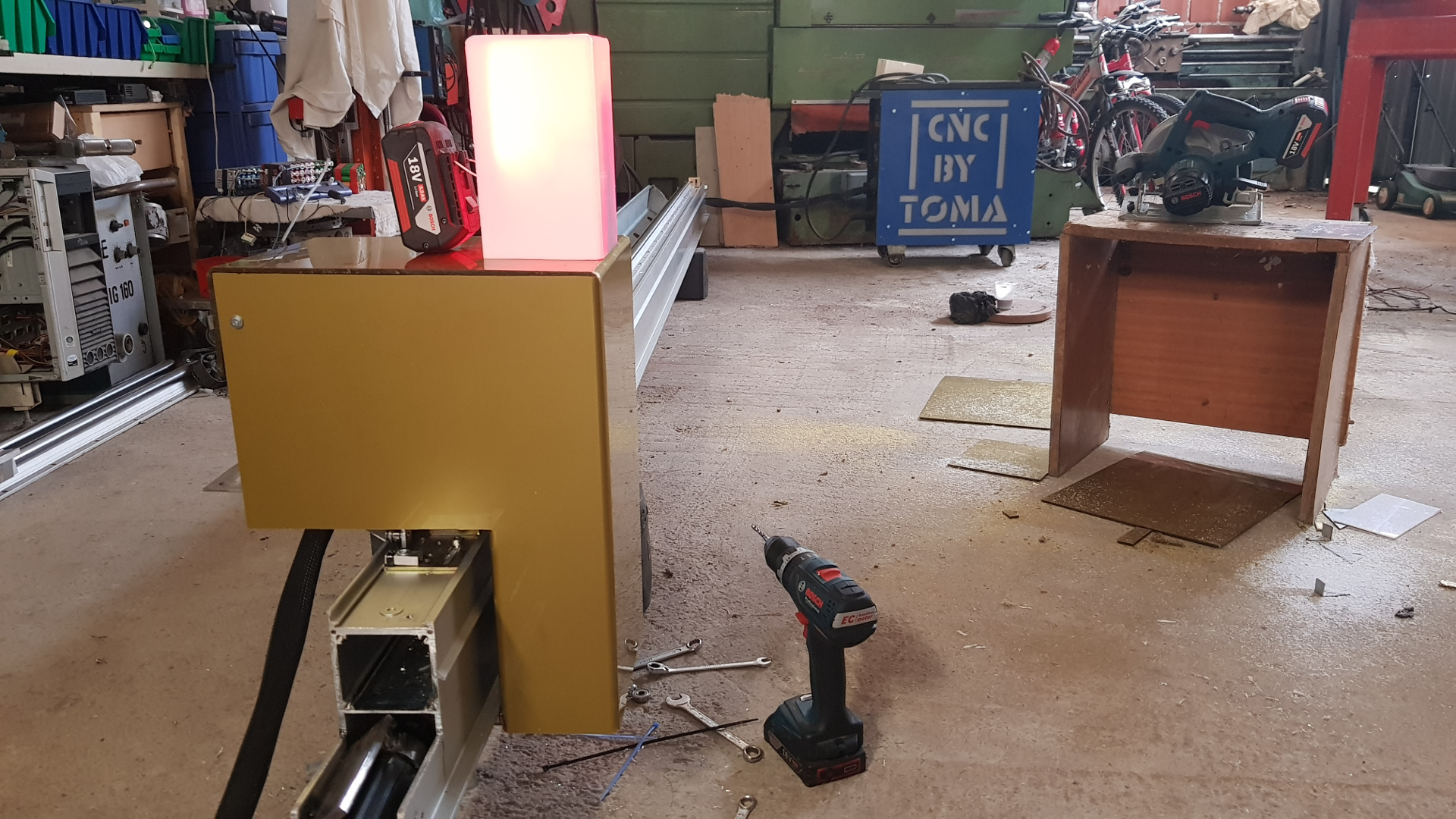

A sip of Coke and a cig later, i am back,
And this is how it looks now:

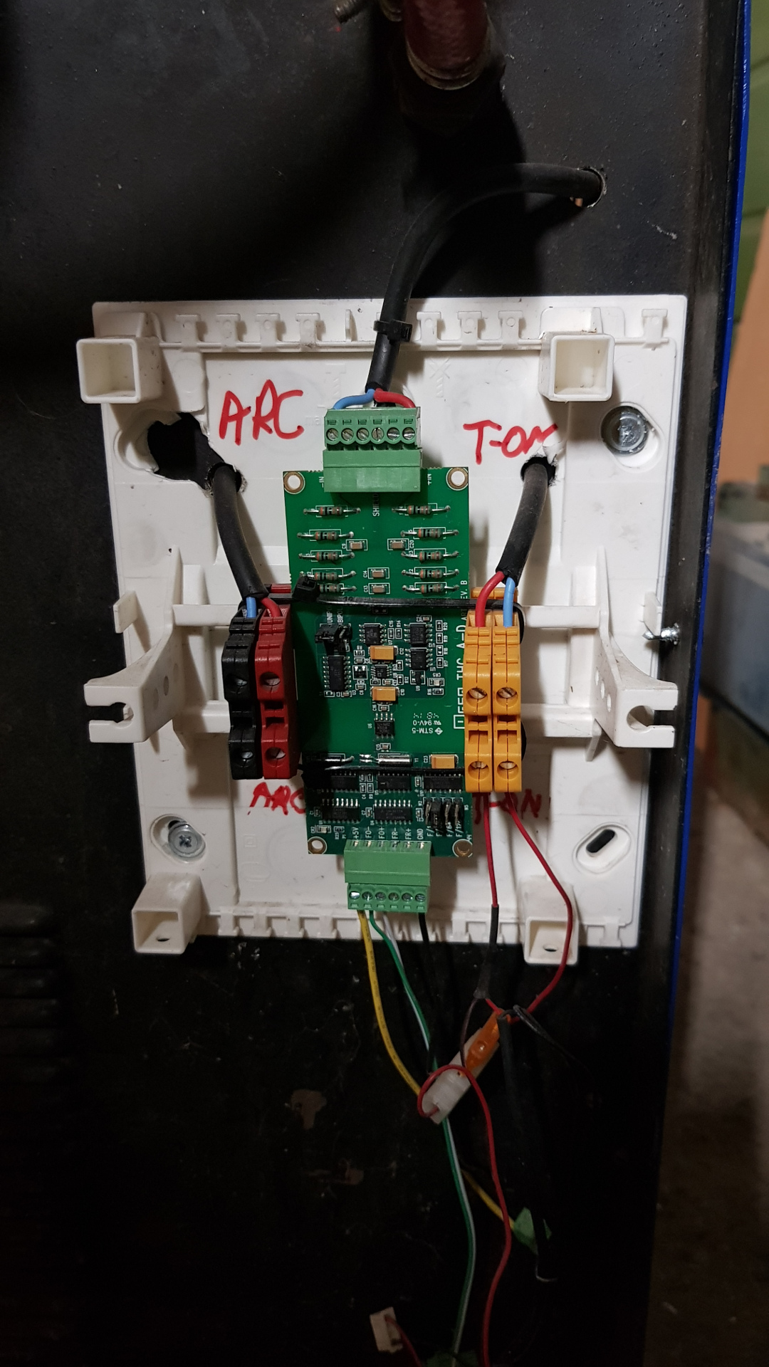

And this is the Mesa THCAD waiting eagerly to be put to use:
Now i need to find some shielded cable as i ran out of it a while back and i can not find any.
Oh, remember the protruding part mentioned above?
Well that is where a box with white plastic should reside, together with some LED lights inside so it glows white while the machine is on and red while in use and running.
2:32AM and i am still in the workshop, next in the agenda: sleeeeeeep !!!
