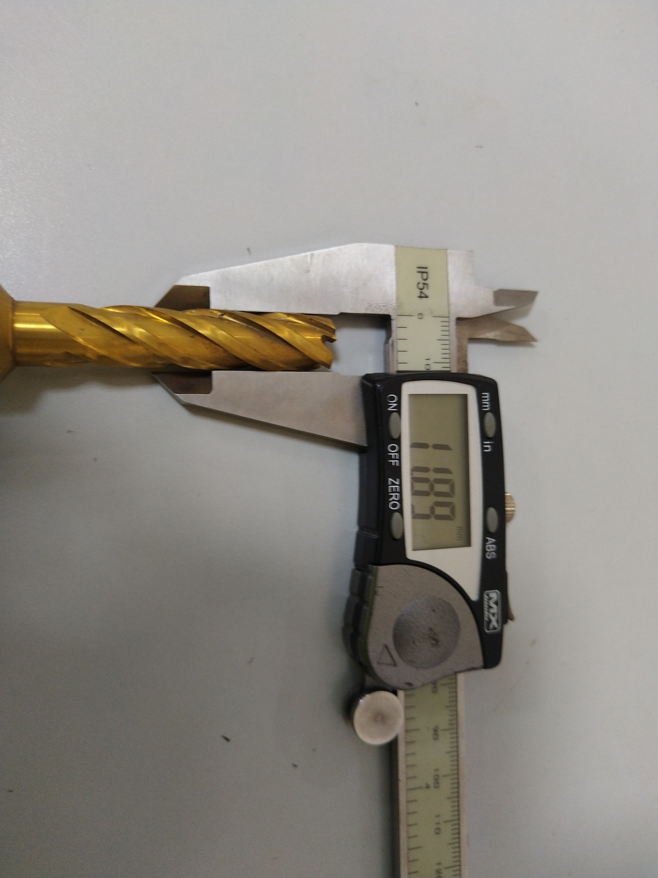

Just a quick thought...I know a guy here in my state that uses the drilling operation and then will use a annular cutter to "drill" the hole. The center pin lines up perfectly on the divot, and the annular cutter is outside of the hardened area immediately around the divot. May not be feasible if the holes are too small.
That is a pretty good idea, and I have used it successfully on larger holes but even some small 10mm holes. I think thats the smallest annular drill I have.
I had to do the imperial conversion to picture that in my head...that's a lot smaller than any cutters I have. I think my smallest is 1/2" (12.7mm). The concentricity is much better than a traditional helical drill bit as well.

Replied by thefabricator03 on topic Center marking options.
You are right, it was 12mm I used. My minds playing tricks on me,

Replied by rodw on topic Center marking options.
Geez Stefan you think you could have at least flick the button to show imperial units for our US based friends!
I did do a google and found that you can get them as small as 8mm (315 thou)
