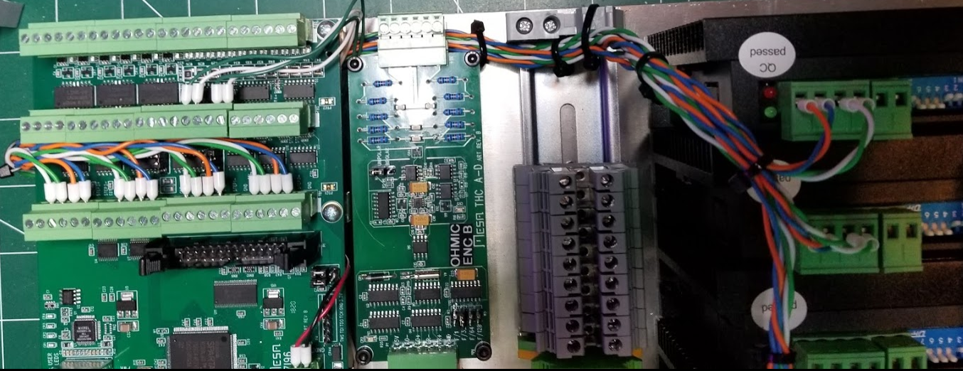

I think I can retire now! Snowgoer has got it nailed. Just keep plenty of air around that 25k resistor as it could get hot!
So with 50:1 divider and a THCAD-5, you don't need any scaling resistor. That gives you a full scale reading of 250 volts and remember the THCAD can handle 500 volts indefinitely. But at 250V it will be really rare for it to hit full scale and it will be at times we don't care about.
On hypersensing, the 390 k resistor is a standard value and gives a full scale of 24.5 volts. This is a bit above our 24V power supply if you adjust it to that value. The THCAD can always see a little bit more than its full scale so if it sees > 24.5 volts, it will turn on the arc-on pin. Its not used for anything but who knows what the future holds?

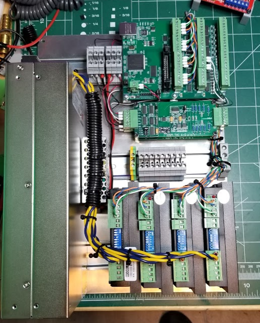

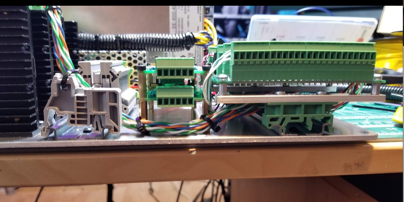

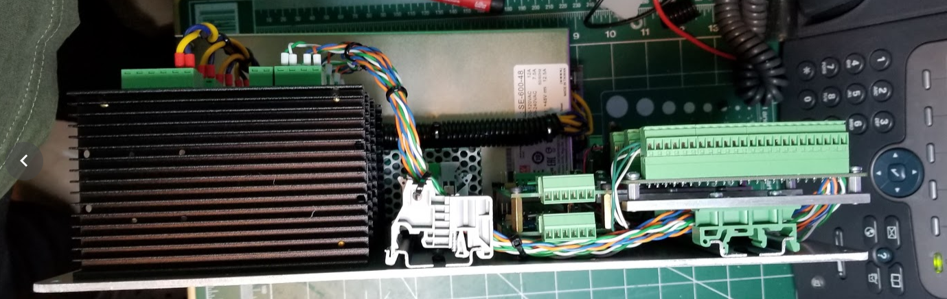

Looks good. I always wondered if it would not pay to mount the 7i96 to a L shaped mounting plate and stand it up on its edge when mounting it to the DIN rail to save space. If I did that, I'd put the THCAD's side by side on a plate mounted the same way.
Replied by rodw on topic Controller build for Plasma
What the heck I had the taller standoffs so I raised it up.

Not so quick, we didn't get your Gold Watch retirement gift in the mail yet! Plus, there's plenty I haven't got nailed... modifying the ohmic comp if it needs it in the future...Hal Scope... The list goes on and on I'm sure.
On that note, ohmic3 seems to work well. I was seeing these false start issues, and weird probe errors that have all seemed to go away. I'll be cutting tomorrow (and testing Phill's Cut Recovery upgrades), so I'll let you know, but so far, so good.
I did get a compare plugin for notepad++, was interesting to see the line you change from ohmic2 to ohmic3.
At any rate didnt mean to hijack the thread. Box looks great!
Replied by snowgoer540 on topic Controller build for Plasma
