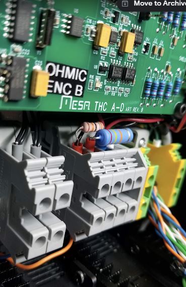

26 Aug 2020 02:59 #179486
Replied by rodw on topic Controller build for Plasma
I'm not sure so I just kept mine off the circuit board I mounted them to. I used 5 smaller resistors cos thats all I could get locally.

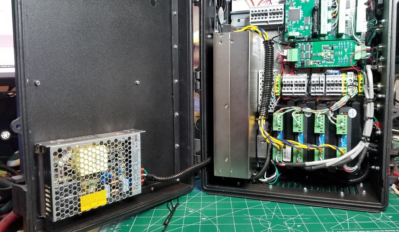

26 Aug 2020 19:49 #179570
by xnaron
Replied by xnaron on topic Controller build for Plasma
Hmmm...
I can't say that I am happy about the proximity of the 24V supply to the top of the stepper drivers when the door closes. It is about 2cm away at most. I guess if I run into any weird issues I can open the door to eliminate the power supply as an issue. It is a mean well power supply so hopefully not as noisy as some other off brands. I could also add a tin shield.
