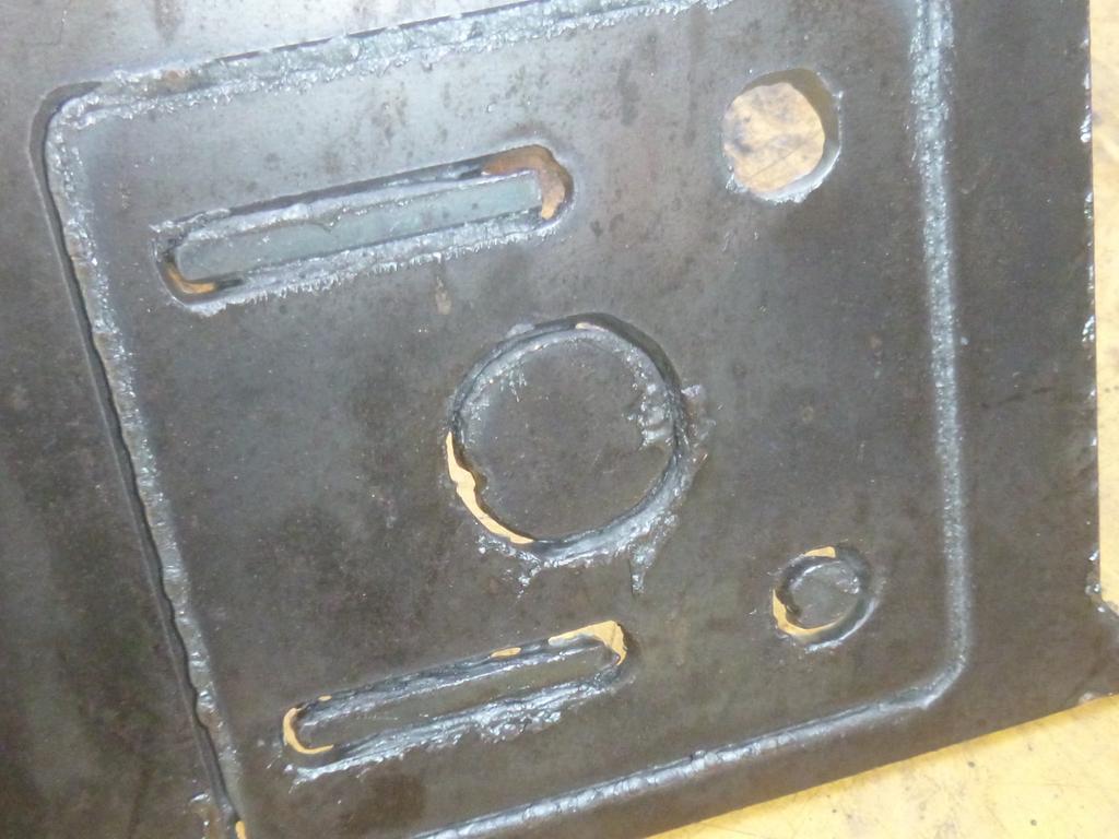

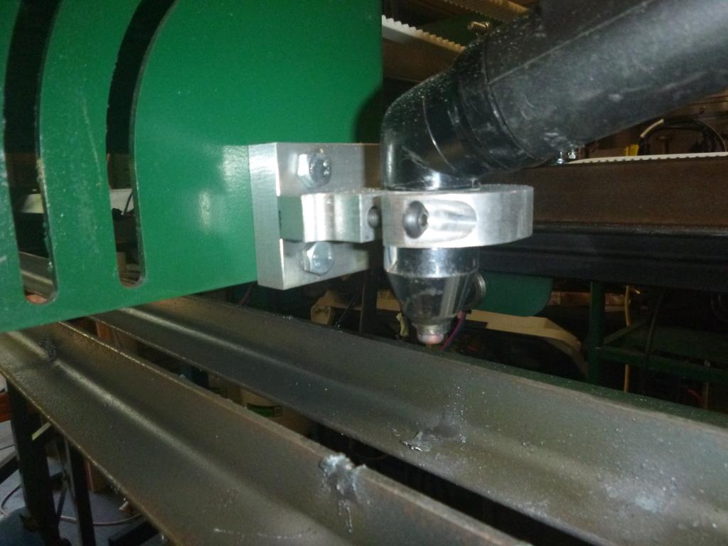

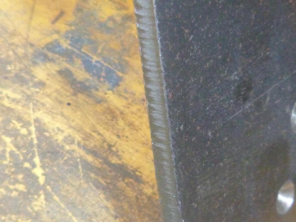

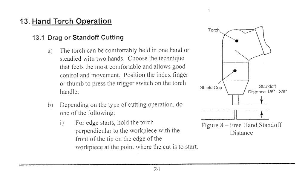

Hi all;
I am at a point where I am stuck with my Plasma CNC build. First a call out to Tommy Light and Fabricator3 for previous guidance and insights. Through their advise/guidance I have got to the point were I have the SheetCAM working and rebuilt my plasma table to have a 4:1 reduction in gearing.
I am using an OOOOLLLLDDD CIG Plasma cutter - bought used 15 yrs ago, and just cannot seem to get a constant cut performance. It will cut thin stuff fine but anything approaching 3mm and it just becomes unpredictable. I have tried differing speeds for cuts as well as maxing out the amps. I have tried fresh consumables and even worked on the air supply to provide dessicated air. All of this to no avail.
I have included some pics to show the set up.
Does anyone have some thoughts because at this stage I am so stymied.
I am using FreeCAD for drawings, SheetCAM for G code and using the LinuxCNC plasma option for post processing and LinuxCNC 2.70 for the machine controller. I am using stepper motors and a Parallel port BoB.
I have tried the 4mm pierce height and 3mm cut height as well as a number of variables and gone from recommended cut speed of 1200mm/min down to 700mm/min with no great success.
I did try to reach out to Jim Colt on settings but the machine isn't a Hypertherm and I am sure he is a busy guy.
I am out of ideas at this stage and hope someone in the community can help give me some fresh inspiration/idea/guidance.

I heard Jim retired so is not so active anymore but you have the experts here to help you
To me, cutting at 3mm sounds too high for a 40 amp machine. Try 1.75mm
from the look of the cuts, I would guess
1, Too fast
2. Too high
3. poor air quality (water in the air)
4. worn consumables.
Where in AU do you live? I had to buy a refrigerated drier in Brisbane.
1, Too fast
2. Too high

Alll of what Rod said above, plus:
1 belts are loose,
are you using PlasmaC ?
If yes:
Do not use "auto volts"
Set the voltage in the "run" panel or tab
Use a welding mask to check the distance from the torch end to the material, it should look like 2 of distance so adjust the voltage till it gets there

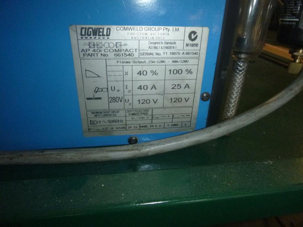

Do not try to cut long cuts at 40A as that plasma source can do that only 40% of the time, so for 4 minutes of cutting it needs 6 minutes of rest, but do make it work properly at 40A.

I think thats something you get with the major brands, all that experimentation behind the cut charts.
Its all trial and error. If its not establishing an arc, I would try dropping by 0.5mm at a time. For my Everlast, I settled on about 3.5mm piercing. Pick a height that seems to work well, check some fine adjustment heights too.
Next, experiment with cut speeds by making a series of straight cuts at different speeds about 100-150mm long, 10mm apart. I cut this piece out as part of the file so i could remove it to inspect the underside. Look at the underside and pick the cleanest cut.
So now to pick a cut height, repeat the same exercise at that same cut speed but at different heights. I did from 1.5 to 2.5mm in say 0.2 increments. Pick a range of 2-3 heights and repeat at 0.05mm. Pick the best looking cut.
Then repeat the process again to confirm the cut speed is still good, Pick a final speed and repeat the height test again.

Hi Rod;
Great to make your virtual acquaintance and it is nice to know there are people out there willing to help.
So to answer your questions, in no particular order.

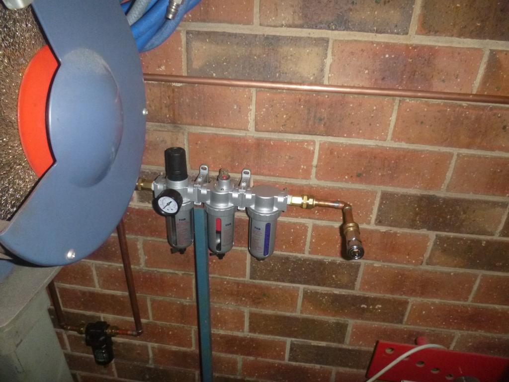

I am located in Victoria, and after having lived in Singapore get your concept of humidity. I am using a three stage air filter that I think was one you has deployed at some stage. (see pic).
I have used brand new consumables on most tests (I think the unit maybe a very old rebadged Thermal Dynamics machinebased on the consumable part numbers).

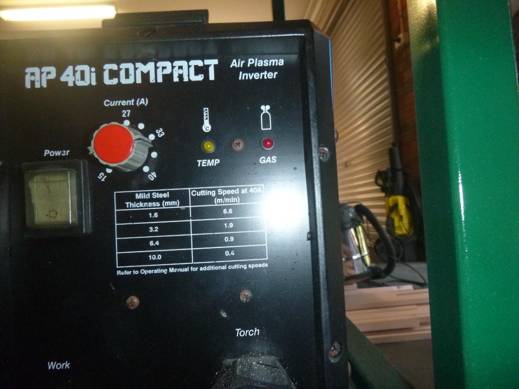

The pierce and cut height were straight out of the manual, but I agree they seem very optimistic and will experiment on height further, but I do not have a THC! (see attached)
The unit says 1900mm/min for 3mm plate but I have slowed it right down to 700mm/min with still no real success.
Thanks again, I really appreciate the assistance.

Without a THC there is no way of getting nice clean cuts consistently.
You can remove the stepper motor from Z axis and add a DC motor wired to a two way switch and a power supply so you can manually adjust the cut height during cutting, but that is tedious and requires staring at that arc all the time.

John, yes, I found that filter woefully inadequate and actually found a pool of water under it one day so bought a refrigerated drier.
Replied by rodw on topic Stuck
Hi Rod;
John
