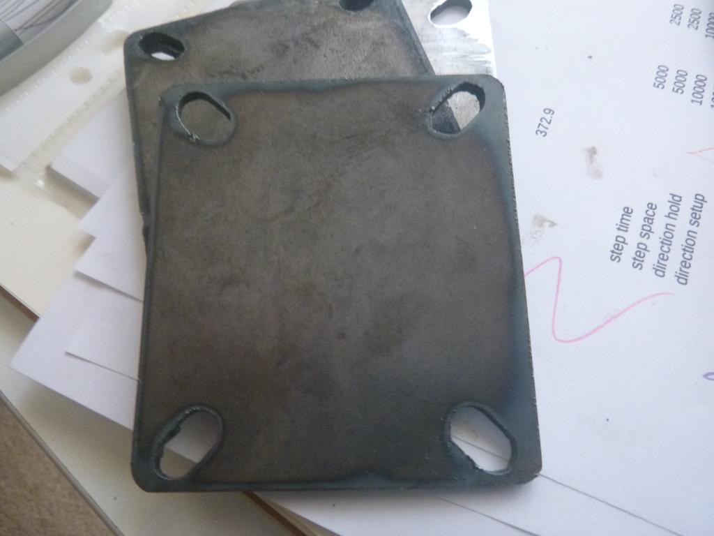

Some success, I cut these castor plates from 3mm sheet.
I had some dross but it came away with a light tap from a hammer.
I think the speed can be increased slightly, it is currently at 700mm/sec but suspect it could go up to about 900mm/sec.
Cheers
John
Cheers
John

if you can knock the dross off you are pretty close to perfect. There should be almost none. Read up on high speed dross and low speed dross.

I have looked it up and I am getting straight lines rather than the slightly S shaped cut lines as described on the hyperthem site. How do those plates look to you?

I'd probably drop your cut height to 1.55mm or .060" and slow down the cut speeds to like 80% of what you are currently cutting at and see what happens
