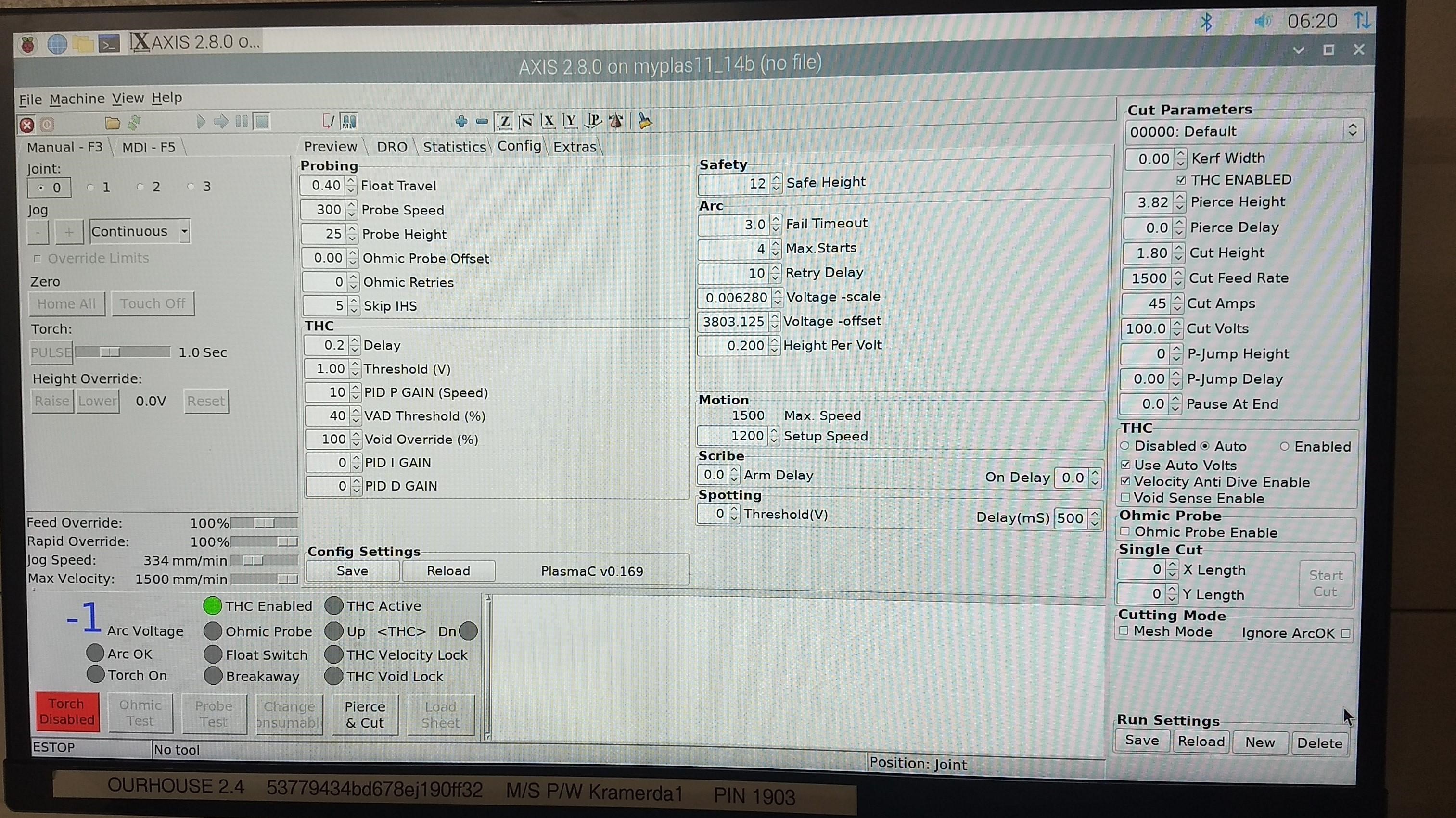

Plasmac cutting beautiful parts - but THC just keeps dropping out due to Velocity Lock as cutting begins.
Running Mesa 7i76e w/THCAD-10, Linuxcnc version 2.8, Axis - see screen shot of Config and .ini Attached. Tried lots of variations of Voltage threshold and VAD Threshold - no luck. ARC Voltage reading about 80 volts with 'Use Auto Volts' during cutting. Read lots of forum posts thinking maybe Max Velocity or Max Acceleration not correct in .ini ????? All feedback much appreciated.

What cut velocity are you trying to cut at?
Your ini file seems to have very low max velocities (1500mm/min)
This could be below your cut velocity so your machine never gets to cut speed.
eg. I cut 2mm steel at 2219 mm/min
VAD might never get enabled.

thanks for quick reply - these THC tests were run on 1/8" steel (3mm+) at either 1500 or 1600 mm/min about 45A

Exactly. Just to be clear. THC Velocity lock (or corner lock) is enabled if the current velocity is a certain threshold percentage below the cut velocity (where cut velocity = book speed). Normally we would set the threshold to be 80%-90%. I think I use 90%. You had it set to 40%
So I saw your max-velocity in your ini is 25 mm/second (1500 mm/min) so how are you going to cut at 1600mm/min? You can't! The Gcode might be accepted but it won't be achieved. Also, the currnet velocity needs to be at or near the feed rate (cut velocity) befor auto sampling and THC enabling is executed.
So your current velocity will always be less than the cut velocity feed rate so the THC can never be turned on.
You need to be able to get up to about 10500 m/min (175 mm/sec) to cover everything in your cut charts.

Sounds like I've got a couple of issues. Let me paraphrase so I understand.....so its just the Max Velocity for XYZ in ini that's wacked.
1. For cutting movements the .Ini variables for X and Y max velocity need to be twice what I'm actually cutting at. i.e. cutting at 1500 mm/min set max velocity to 50 (mm/sec).
2. For Z axis THC same applies but that movement is likely slower (???) but ratio must exceed % threshold set by VAD. i.e. Z axis movement
750 mm/min set max velocity > 25 mm/sec. (2:1).
3. Like you said - set V Threshold % at something like 80 or 90 %.
4. Not sure about my cut chart settings - will have to read up on that topic - for now just testing on the 3mm steel.
Since my system with steppers is 'open loop' speed control I think i'll be OK if I can get the numbers here in line.
Thanks again - we'll give it a go today.

THANK YOU VERY MUCH. That fixed it - doubled all occurrences of max velocity from 25 to 50 mm/sec (1500 to 3000 mm/min). Left accelerations alone.
Attached is new .ini file
is it necessary to also double stepgen velocity if no backlash comp. used??
For future reference --- is the parameter MAX_VELOCITY there just to put a reliable boundary on the stepper motor limits or is there some other reason?
