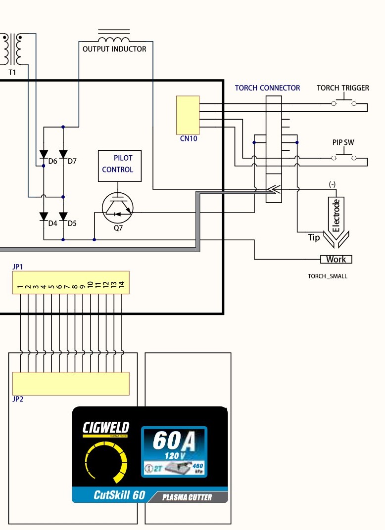

27 Mar 2021 03:54 #203771 by Joco
I have been looking into how to deal with touching off and based on the reading I rather like the advantages of ohmic sensing and the hyper sensing system using a THCAD-5. So I have been testing my Cutskill 60 to see if the tip is always in open circuit to the work or not. Based on the schematic attached and tests done with a meter I think I might be in luck.
You should see from the attached circuit the the path between the torch tip and the work is controlled by a combo transistor and diode (Q7). When the pilot arch is not active Q7 is open so no circuit possible between Tip and Work. When it closes a pilot arch would be possible. Assuming I understand the ideas behind hyper sensing and using relays to control a 24v supply, with the +24V on the Work, the 24v-GND on the Torch Tip, then when the torch is off the only way a circuit can be achieved will be when the torch tip touches the work on a probe.
So looking better all the time for enabling this little machine to operate under a CNC setup.
Cheers - J.
27 Mar 2021 04:16 #203772 by rodw
Hypersensing negates the need for any relays becasue it can handle the torch voltage without any adverse affects.
When I had my Everlast I was all set to implement ohmic sensing, then it ocurred to me it would take the full brunt of the torch voltage so was worried it could jump over relay contacts if you implemented relays for ohmic sensing. I later read you need high current relays to implement it safely.
Then PCW encouraged me to develop hypersensing and there was a lot of help from him in the background. If I still had the Everlast, I would have tried it out by now.
On my machine the ohmic voltage jumps straight to full scale once cutting starts. This was expected as the full torch voltage is on the circuit.
So if you can jury up a simple probe by taking +24V from field power, attaching it to the torch tip and then connecting an input to the material and you can probe WITHOUT cutting, then you will be fine to wire in the hypersensing circuit properly per the diagrams. You don't even need any relays, just power up the isolated power supply in startup.
