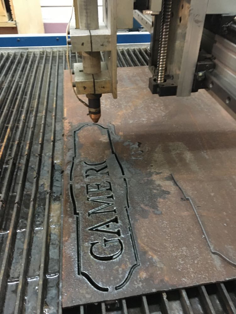

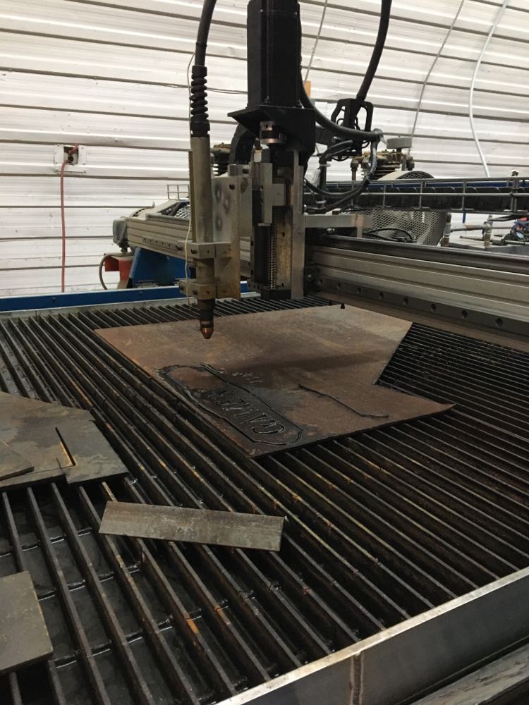

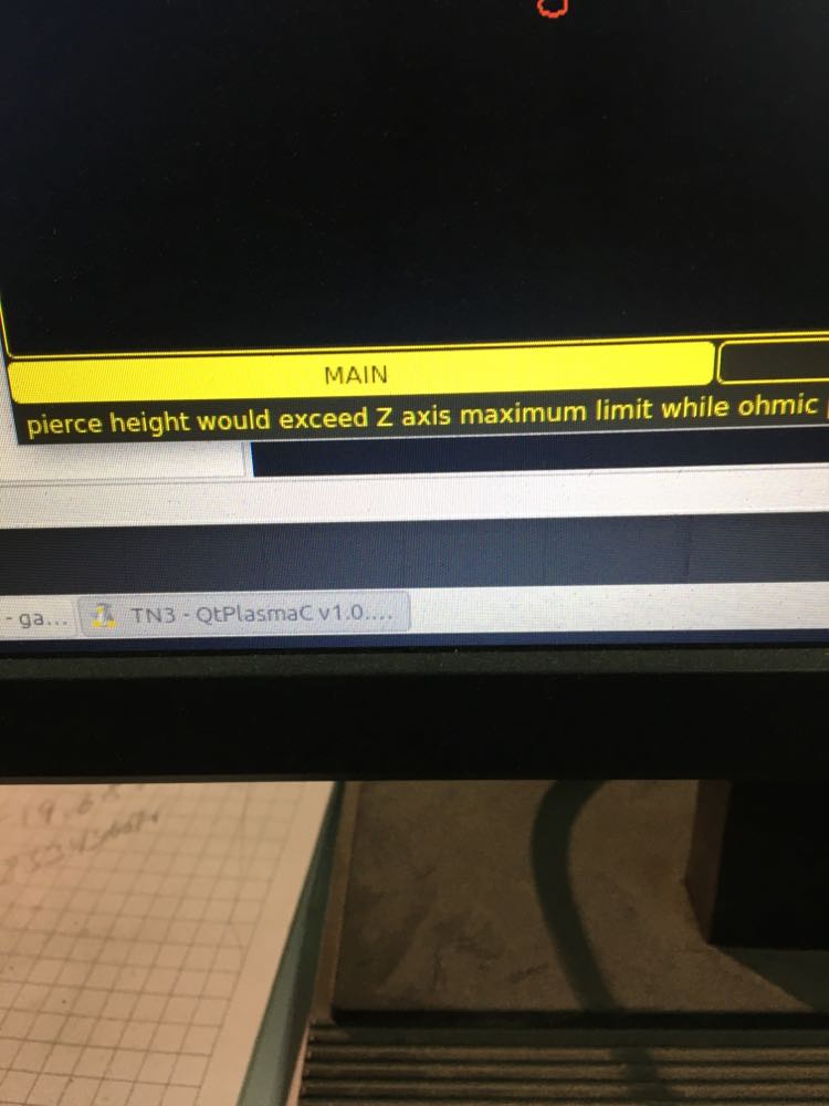

I dont understand why I am getting this. It ran fine 3/4 through the project then this. It is happening alot cutting and I cannot find what is causing this. Why it the touch going all the way up to z limit. I cannot find what parameter to change to fix this.
I attached the config and I am using the latest QTplasmac but it was doing this before in other versions. I just dont know how to rectify it.
Pierce height is at .150 so I don't know what this message is about.

This will explain all of the error messages:
Error Messages
Simply put, the error message means that from where it detected the top of the material, there is not enough room for the Z axis to move to the Pierce height (in this case an additional .150” from where it found the material). If there’s not enough room, it gives you an error rather than running your torch into the soft limit.
Your backup isn’t attached but I don’t think I need it. I’ve seen it where the ohmic probe setup acts like a capacitor and after a bit of cutting hovers around the high voltage threshold and falsely “trips”. You can see this by using Hal meter and monitoring the voltage while cutting.
This can also happen due to noise. You can use the halscope to just do a rolling plot of the ohmic voltage. I found that my thcad was “quietest” with no shield wires connected at all. YMMV
Id guess for this job it didn’t actually detect the material with the ohmic probe anyways due to the rustiness of the material (I only use ohmic on thin, clean metal) and it actually was falling back to the float switch. Its also possible you’re getting water in the torch and during the probe it’s “shorting out” and simulating touching the material at the beginning of the probe.
A workaround until you get it ironed out is to you disabled ohmic probe for this job. Also plot your voltage and check the noise at some point. I suspect the line may be noisy.

I listed a few things to check out in my post above, as well as the suggestion to disable ohmic probe on this material because it appears to be thick and rusted. And in addition, I think your voltage is probably "accumulating" and causing false trips.
Again, G54 Z0 will have 0 effect on anything as far as QtPlasmaC is concerned.

Yes I read that. I selected ignore ohmic probe and still got the message "Pierce height would exceed Z axis maximum limit while ohmic probing"
EDIT: My bad I got it. it worked disabling ohmic and used the float.
Thanks for the tip of using ohmic probing on thin material only.
