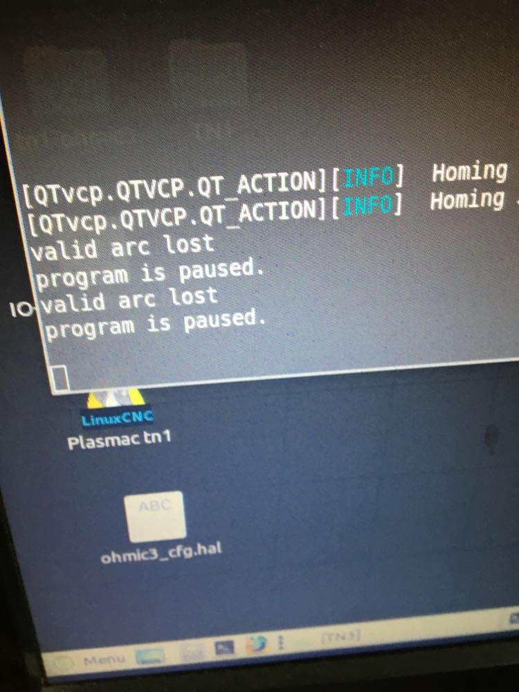

It is using continuity ground energizing a relay not using thcad for the ohmic probe.
I don't have a problem with the dirty metal at all. I still dont understand the issue with the "Pierce height would exceed Z axis maximum limit while ohmic probing". I read the error message. This only makes sense to me iof after the first probe, it knows where the Z is, then for some reason plasmac comp raises the Z all the way up. Can I limit this because that would probably fix the error message becasue it would go no where near the Z max limit.
Replied by bevins on topic Pierce height would exceed Z axis maximum limit while ohmic probing
I am not using ohmic3, I am using Ohmic2. Not the thcad but input into mesa.
I don't understand what you're trying to tell me..?

Since you arent using a THCAD (I thought you were), then I don't understand why you are using ohmic2. Ohmic, ohmic2, and ohmic3 are all components for doing "hypersensing" with a Mesa THCAD.
I've explained the error message. You are getting a false trip during the probe. It then thinks your material is MUCH higher than it is. And because of that, it knows that it has no room to get to pierce height. The message is valid.
I know nothing about your ohmic circuit, so I guess I can't tell you why you are getting false trips, but that's what is happening. You proved that because it works when you disable ohmic probing.
Finally, the torch goes to the top when this happens because you've encountered an error that caused the program to pause. When the program pauses, the torch goes up to the top. That's normal PlasmaC behavior, and has nothing to do with probing.

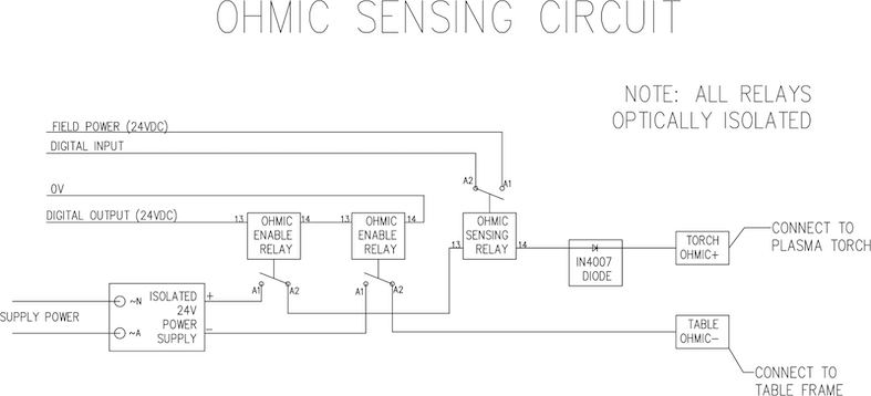

OK so if I get what your saying it gets a false probe say half way down and thinks the material is actually higher than it is and tries to go up.
I am using the one of the first Ohmic sensing circuit's rodw put out.
I will check the validity of this. It happens alot so I should be able to see the ohmic lite go on before it hits the material.
Ohmic sensing circuit.....

Here is another way of wiring relays for ohmic similar to what islander261 was using, it may be worth a try.

Valid arc lost.... I dont get that one. IT was at the end of an operation when it is leading out. Why would I get arc loss. The gcode was M5 cut stop, so why would the program pause? line 102 of gcode

18 Apr 2021 12:11 #206297
by phillc54
this is in units per second, so 60 in/min
Replied by phillc54 on topic Pierce height would exceed Z axis maximum limit while ohmic probing
This line in the [TRAJ] section of the ini file is the reason for your slow velocity:OK I attached the config and gcode where it goes no faster than 60 as it shows in the gui.
MAX_LINEAR_VELOCITY = 1.00
The following user(s) said Thank You: bevins
- bevins
- Posts: 1947
- Thank you received: 338
18 Apr 2021 12:23 - 18 Apr 2021 12:23 #206300
by bevins
Thanks, I stared at the ini for a long time and didnt see it. lol
this is in units per second, so 60 in/minMAX_LINEAR_VELOCITY = 1.00

18 Apr 2021 12:36 #206301
by bevins
I just found that when ohmic probing it was tripped when it started probing. I blew out the nozzle with air and I saw a bit of water came out. Once I did that the ohmic trigger went away, so can I assume this is probably the issue with the ohmic probing?
- Posts: 22006
- Thank you received: 7490
18 Apr 2021 19:53 #206327
Replied by tommylight on topic Pierce height would exceed Z axis maximum limit while ohmic probing
If at all possible, no lead outs on plasma cutting.
By the time the machine reaches the end of a cut the part has already fallen or there is no material left as it was cut already at the start, so avoiding lead outs is a god habit.
And yes, water can cause ohmic issues, hence the ohmic is never used on water tables, but somehow Rod, Phill, Snowwy and some others here made it work reliably using PCW and Mesa THCAD.
