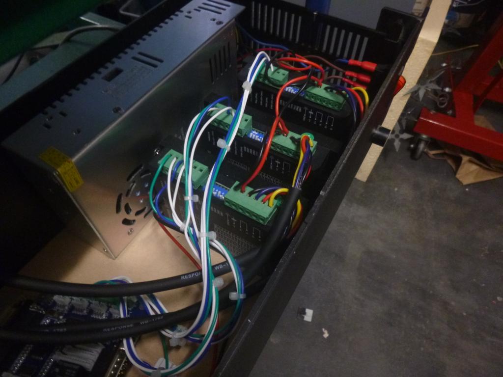

03 Jun 2021 12:39 #211090
Replied by tommylight on topic Apparent Step Errors MKII
Picture of drives DIP switches and settings ?
Motors should do just fine.

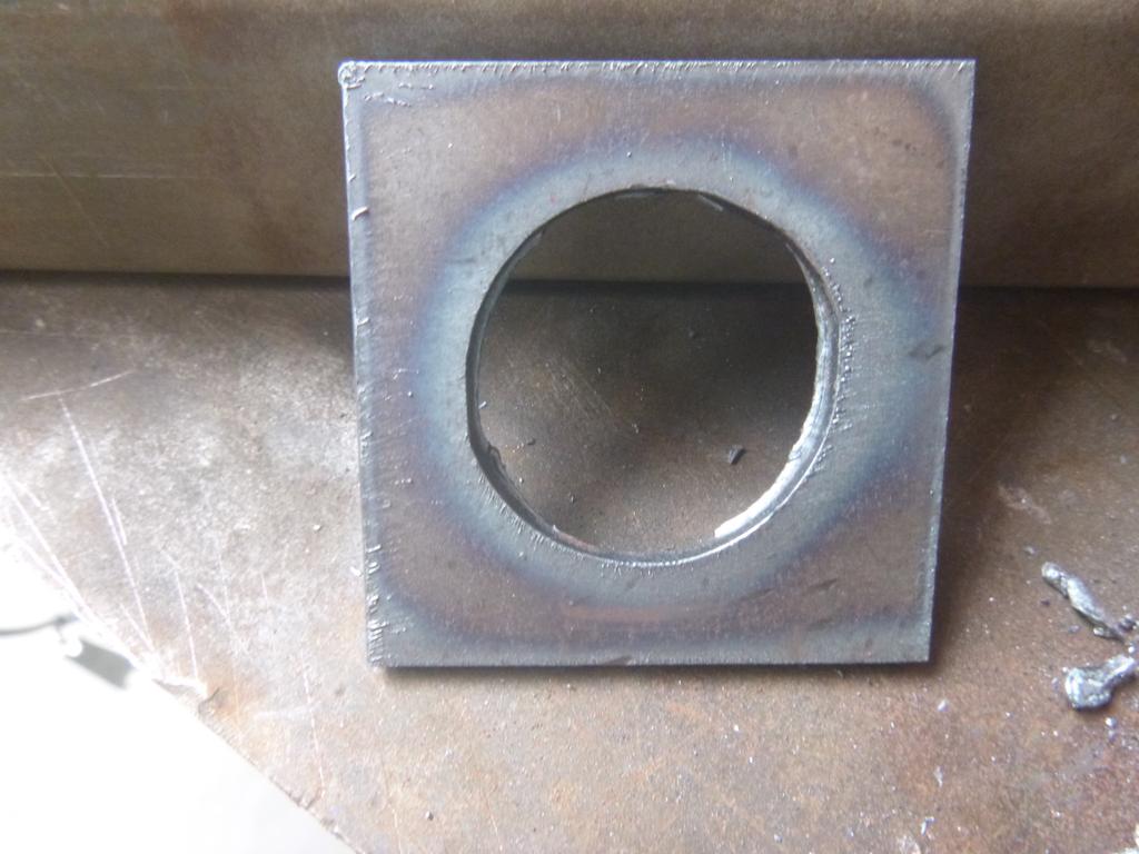

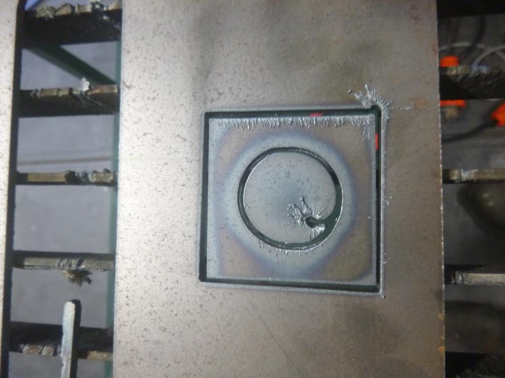

03 Jun 2021 22:59 #211107
Yes and some pictures of the cuts, round and square shapes.
Who, me?Will post some pics later today my time as per Tommy's request.

- jnwinkie
- Posts: 49
04 Jun 2021 02:48 #211122
by jnwinkie
Replied by jnwinkie on topic Apparent Step Errors MKII
Hi Tommy and Sam;
I am using DM542T stepper controllers. They are set to 4.2A for X and Y and set to 400 steps per rev. I tried higher micro stepping (I think there was some pics earlier) and this made no appreciable difference.
Thanks for your help.
John
John
- BeagleBrainz
- Visitor
04 Jun 2021 02:55 #211123
by BeagleBrainz
Replied by BeagleBrainz on topic Apparent Step Errors MKII
Maybe unrelated, but just for good wiring practice, I'd try to have some separation between the signals to the stepper drivers (and any other logic signals) and the output from the stepper drivers to the stepper motors.
