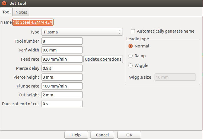

At what speed are those cuts?
Check the motors for heat, if you can hold the palm on them=all is good, if it burns=lower the current on the drives.
To much current will cause missed steps and erratic behaviour.
Check after half hour of machine runing.

Hi Tommy;
Motors are OK to touch, warm but not hot.
I have included the cut speed in a screen grab.
Cheers
John
Cheers
John

Hi Tommy;
Would there be any benefit in reducing the current? If so I can try later today.
Rgds
John
Rgds
John

Replied by tommylight on topic Apparent Step Errors MKII
Not really, upping it might help, but gradually, in small increments and check after each increase. It must be after at least 15 minutes of work.
Run a 2 to 4 hour job really slow, like 20 to 25% slow, but make sure to mark the start point and set the gcode to return to that point at the end.

Thanks Sam;
It is a plasma unit and the highest cutting speed I have at the moment is 3048 mm/min or roughly 120"/min. The slowest is 305 mm/min or about 12"/min.
I am not a production shop more of a tinkerer. I try your suggestion and see ho I go.
John
John
