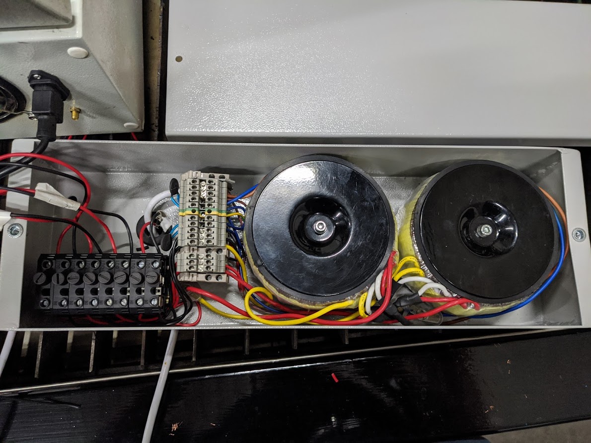

- txtrone
- Posts: 384
- Thank you received: 106
19 May 2021 22:40 #209563
by txtrone
Rod - What motors are you running? Are you using all the same motors and LAM drivers? Or do you have a mixture?
Replied by txtrone on topic Toroidal power supply and Gecko stepper questions
Shown here installed. Here we used 2 x 32 volt toroids because they were available. 64V 20 amp out. No need for any other circuitry.

- thefabricator03
- Visitor
19 May 2021 22:47 #209567
by thefabricator03
Replied by thefabricator03 on topic Toroidal power supply and Gecko stepper questions
I like how the thermistor is installed into the terminal. It makes for a clean installation.
