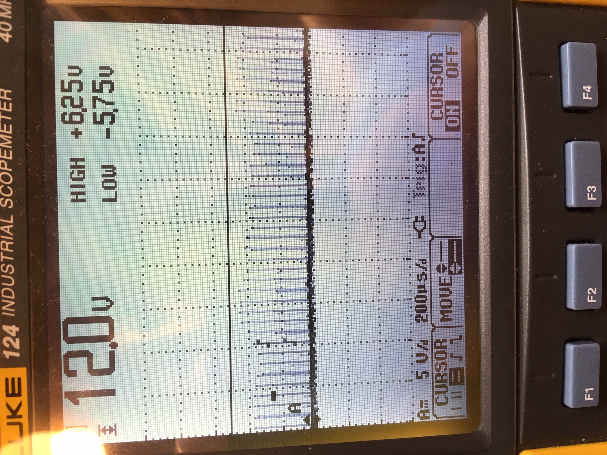

On TB3 pin 2 and 3 I now measure 20Khz and a nicely fluctuating voltage between 0-12V depending on the height of the Z-axis.
So I can easily adjust the power of the laser with the engraving depth.
Now two questions.

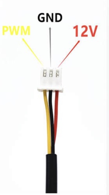

Why 12V? I thought PWM was only 5V. Background: the Borad once had a short circuit. Are that 5V on a healthy board? Because laser has only 5V PWM connection.
And how can I connect the laser to the board? I only have 3 cables on the laser. PWM, GND and 12V
But I'm not sure how to connect it.

The step/dir outputs (being used for PWM now) on a 7I76e are 5V signals
I suspect a measurement error

Laser PWM -> TB3 Pin 2
Laser GND -> -12V Powersupply
Laser 12V -> +12V Powersupply
Or should i better use a level converter between Laser PWM and TB3 on mesa board to not share the ground?
Replied by chris@cnc on topic Laser Advice and Guidance - Mesa Card
Okay i measure now TB3 Pin 1 an 2 and got 5V max. I would wired laser this way but have fear to share thre ground.The step/dir outputs (being used for PWM now) on a 7I76e are 5V signals
