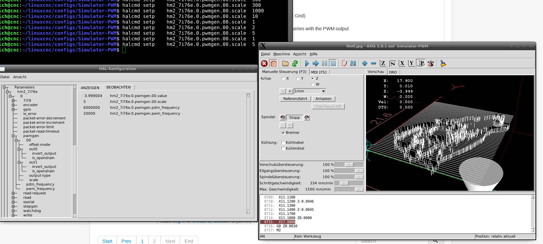

I haven't found any recent implementations. Would it be possible for you to share your *ini and *.hal files when you get it up and working?
Replied by Project_Hopeless on topic Laser Advice and Guidance - Mesa Card
What version of LinuxCNC are you using?For the test, I loaded the PWM bitfile onto my 7i76e simulator.
The following lines are written in the hal.

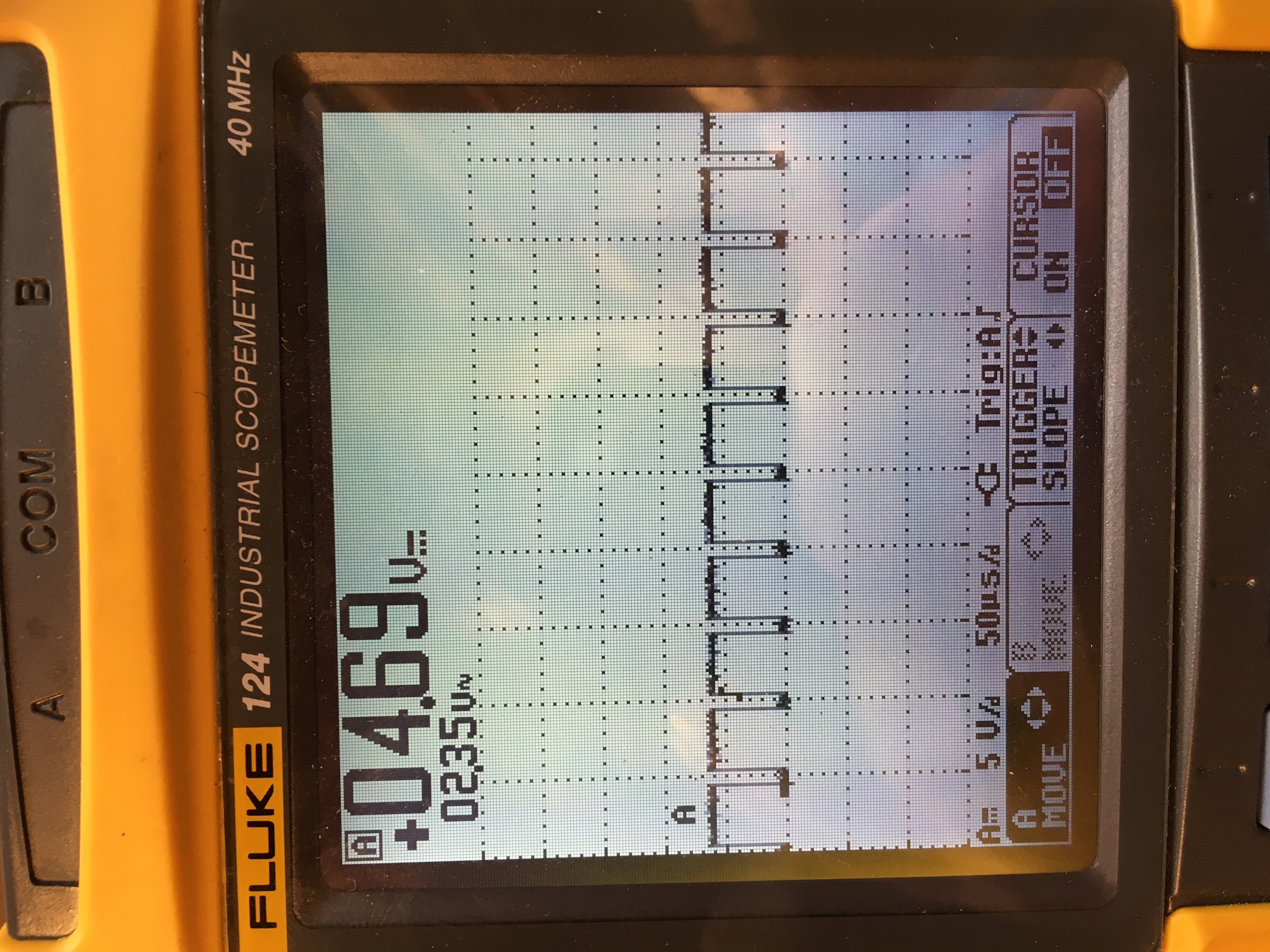

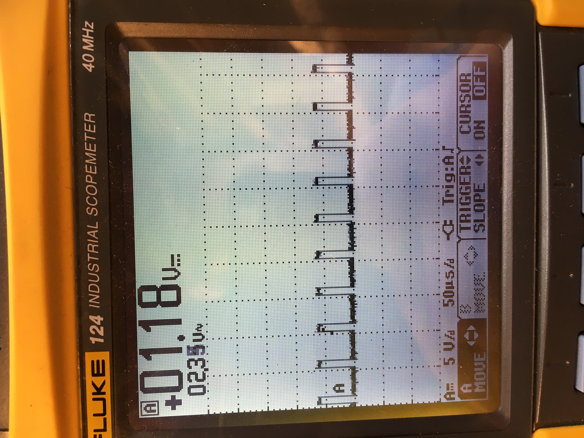

Just for double check. I only have this 4 Pins on laser input card.
I would now connect Laser as follow
+24V --> powersupply same for mesa card
GND --> powersupply same for mesa card
TTL + --> + 220 Ohm resistor -->TB3 PIN3
TTL- --> TB3 PIN 1
If its running i will share my config but for the moment i test only with this 4 lines.
I order the laser yesterday. Maybe delivered next month. I need more time to get it running.
But for today it looks not so bad. I set "halcmd setp hm2_7i76e.0.pwmgen.00.scale 5"
And PWM power now by Z-1.000 1.2V and Z-4.000 4.7V and Z-5.000 5V. So we could adjust laserpower depend on material.

And what ist PDM frequency? I change it but nothing happens on scope...
- Posts: 18060
- Thank you received: 5308
01 Jul 2021 03:08 #213407
Replied by PCW on topic Laser Advice and Guidance - Mesa Card
It only affects PDM mode (output-type 3)

It works now. Important lines.
Hal changes
INI changes
Replied by chris@cnc on topic Laser Advice and Guidance - Mesa Card
Hal changes
# -----------PWM Generator signals/setup---
setp hm2_7i76e.0.pwmgen.pwm_frequency 20000
setp hm2_7i76e.0.pwmgen.00.output-type 1
setp hm2_7i76e.0.pwmgen.00.scale 4
#------------ Laser relay main switch------------------------
net w-enable => hm2_7i76e.0.7i76.0.0.output-15
# -------------laser pwm enable by program cycle start, off by program stop, pause....
net halui.program.is-running => hm2_7i76e.0.pwmgen.00.enable
net w-enable <= joint.6.amp-enable-out
net w-pos-cmd <= joint.6.motor-pos-cmd
net w-pos-cmd => joint.6.motor-pos-fb hm2_7i76e.0.pwmgen.00.valueINI changes
