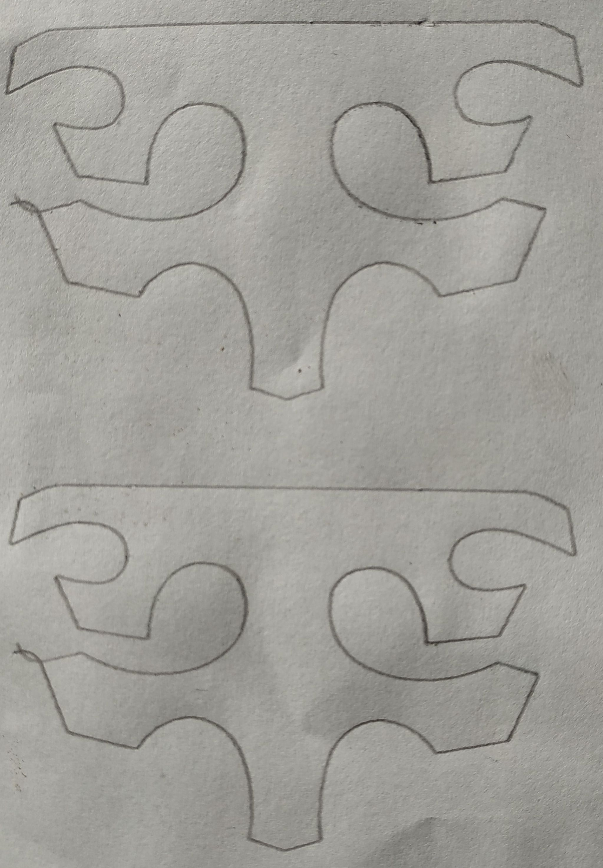

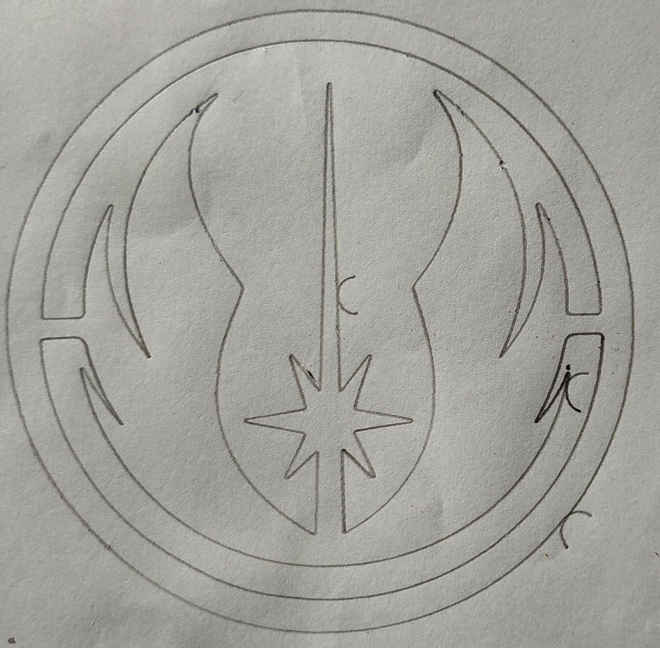

11 Jul 2021 17:26 - 11 Jul 2021 17:27 #214297
by Giuseppe
Replied by Giuseppe on topic New Plasmacutter
I understand. Spring is a bit to much work at the moment. But i can try reducing acceleration.
But please take a look at the samples i make with an pencil.
This look much more better.
Is this why the pencil touch the paper or is the problem a different one?
The first one is with higher acceleration and the second with half speed.
Last edit: 11 Jul 2021 17:27 by Giuseppe.
- Posts: 22006
- Thank you received: 7490
11 Jul 2021 20:36 #214320
Replied by tommylight on topic New Plasmacutter
Pen is touching the surface while the torch does not, so the pen test is not of much use for plasma, except when there are hardware issues.
Test with lower acceleration, it should work better.

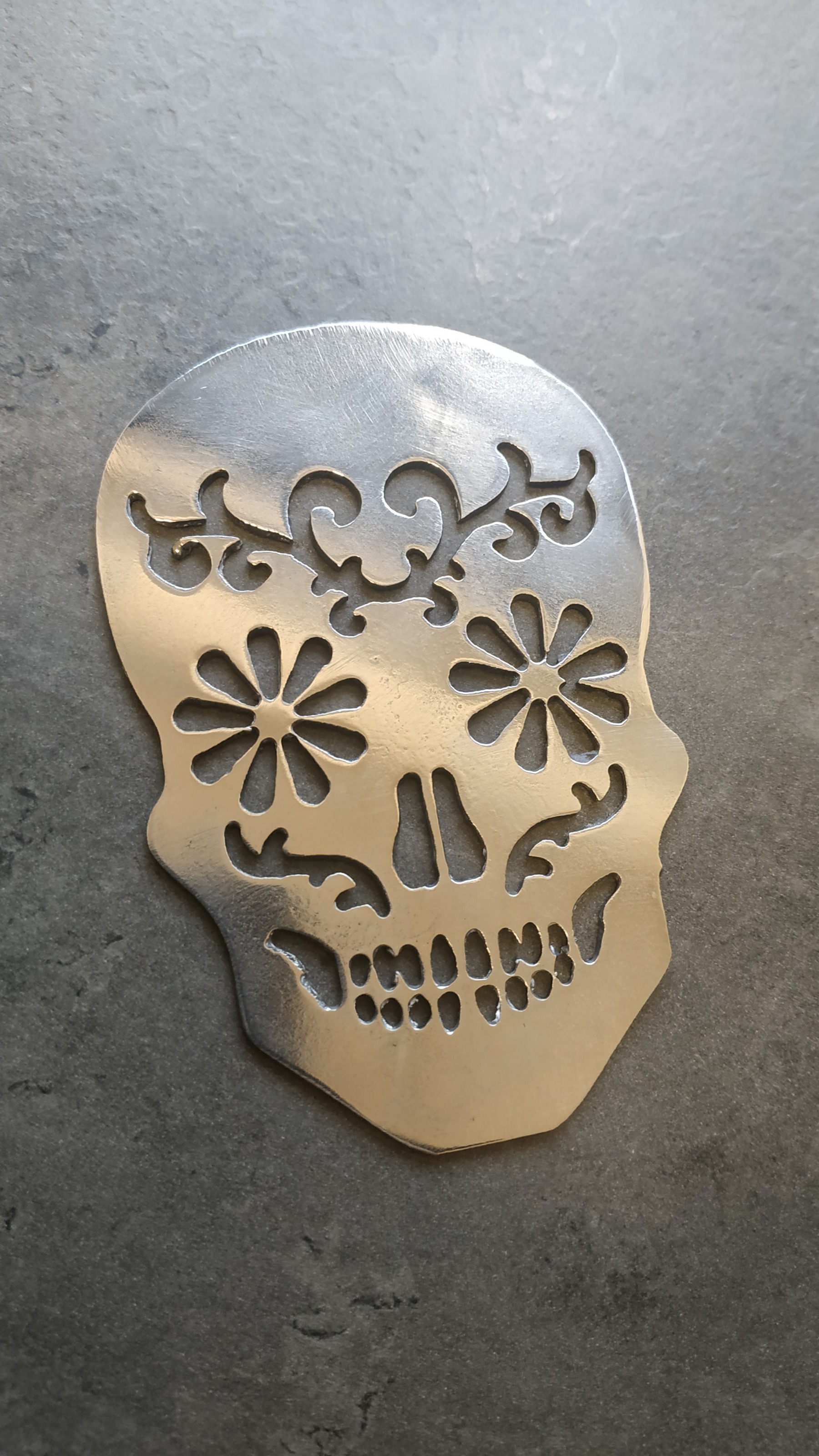

16 Jul 2021 19:30 #215080
by Giuseppe
I bought a new plasma cutter and a cnc torch
www.stahlwerk-schweissgeraete.de/STAHLWE...er-CUT-50-Pilot-IGBT
This cutter works much better for me because it has a pilot ignition.
Today i cut this sample out. It is 110mm high and 70mm wide.
I cut with 1000mm/min and 20 amps 4bars and a cut high of 2mm.
What do you think? Do you have some tips for me?
- Posts: 12163
- Thank you received: 4152
16 Jul 2021 21:02 #215087
Replied by rodw on topic New Plasmacutter
Looks great! Finally your hard work on your build has paid off!
- Posts: 22006
16 Jul 2021 21:25 #215094
Set it at 40A and leave it there, looks like to fast and to low current.
For anything above 1mm, 35 to 40A, and just change the speed while checking the cut.
Do several lines of 20 to 30cm length, start at say 1m/m and check for dross under the cut, then try one faster and one slower, check under what looks better, repeat.

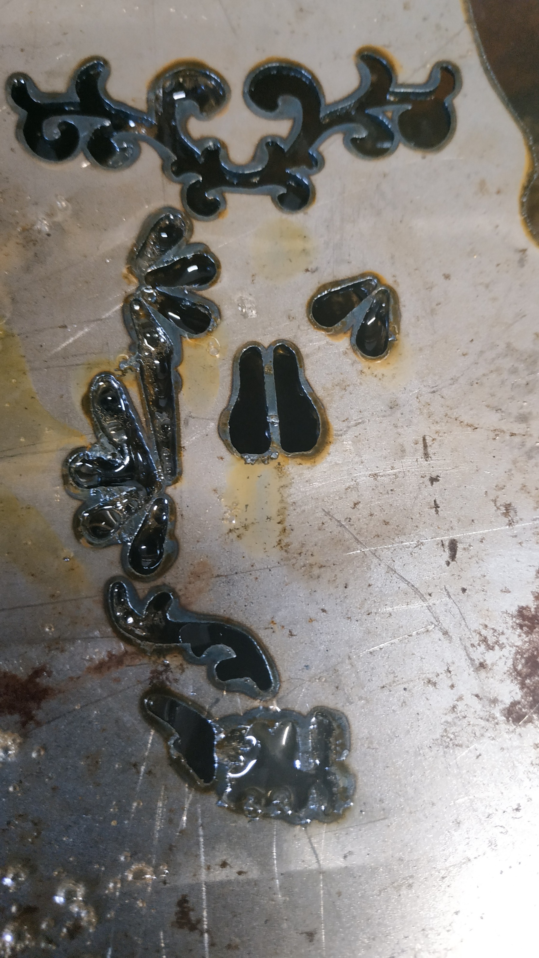

17 Jul 2021 14:42 #215139
by Giuseppe
Why something like this happens?
- Posts: 22006
17 Jul 2021 17:24 #215149
Black around the cut?
Heat.
Cut faster = less black.
Heat.
