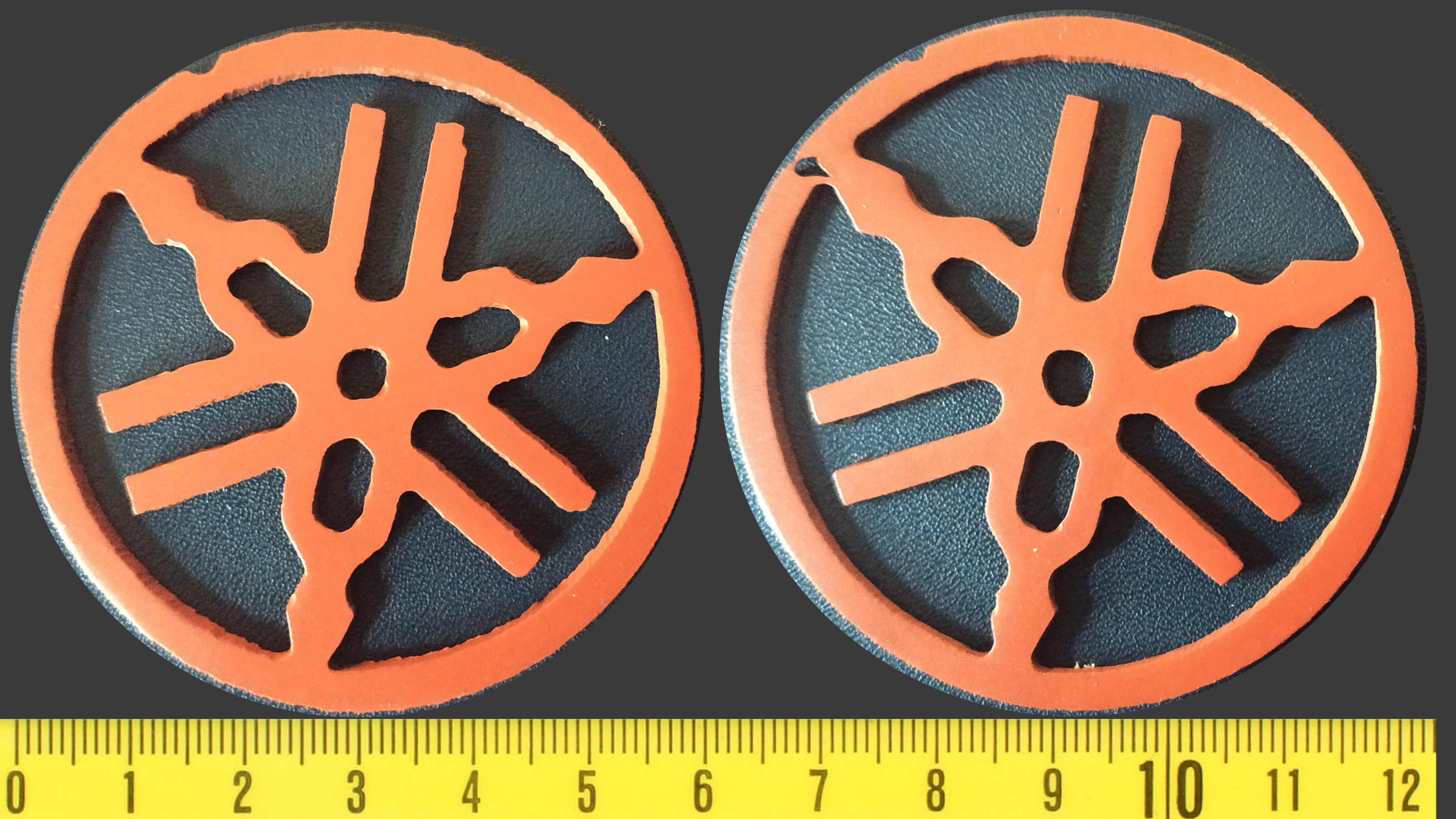

Oh, that is missed position due to steppers loosing steps, or the torch touching the plate and motors skipping due to friction/load.
Also can be due to interference, so move the plasma source as far as possible from the PC and electronics, torch cable also far from other stuff, best hanging from the ceiling.

but at what height does the torch travel? Are the nozzles and electrode new? I did a test with mine days ago with a twisted and rusty metal sheet at f1500 and 25 amps. regards Mauro

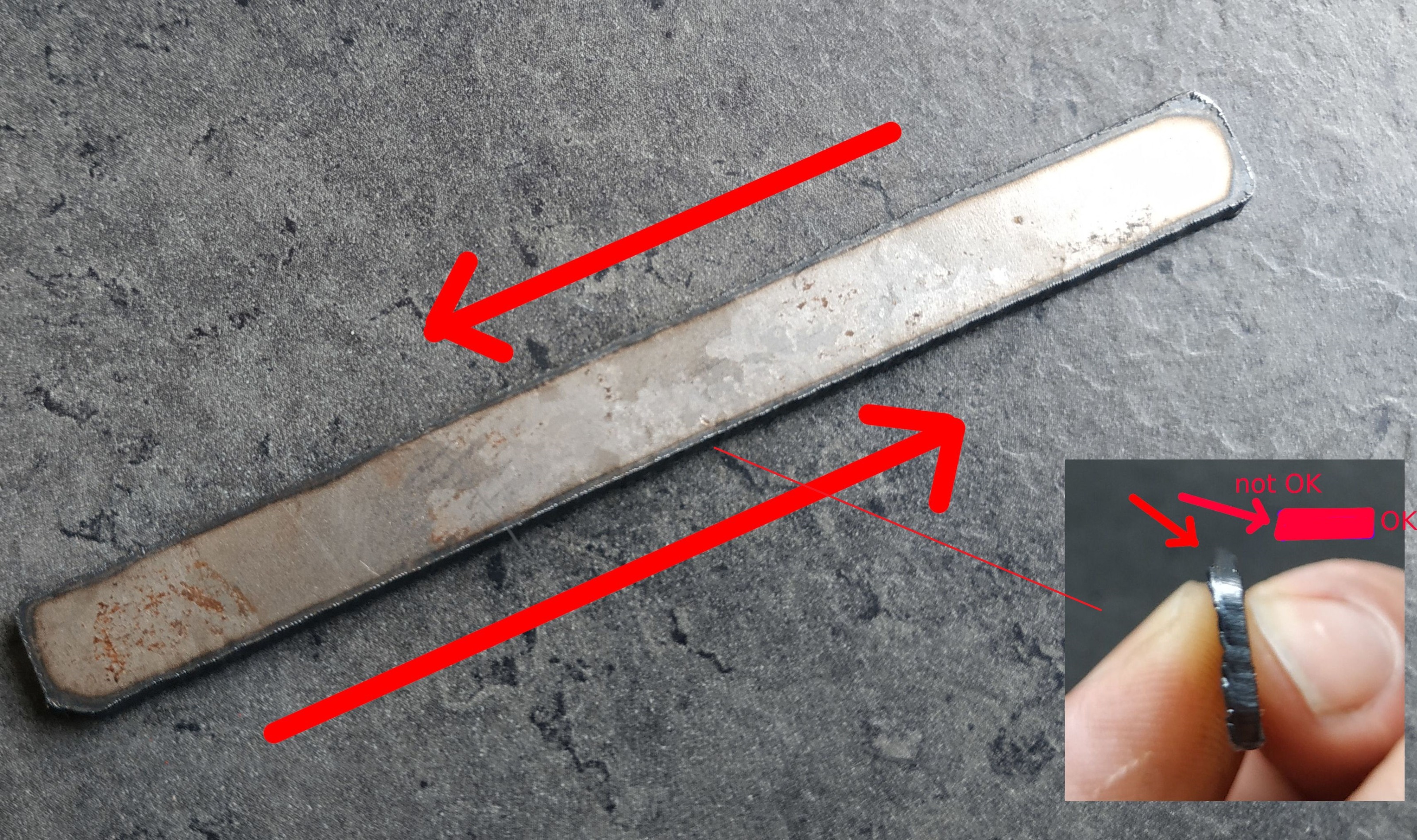

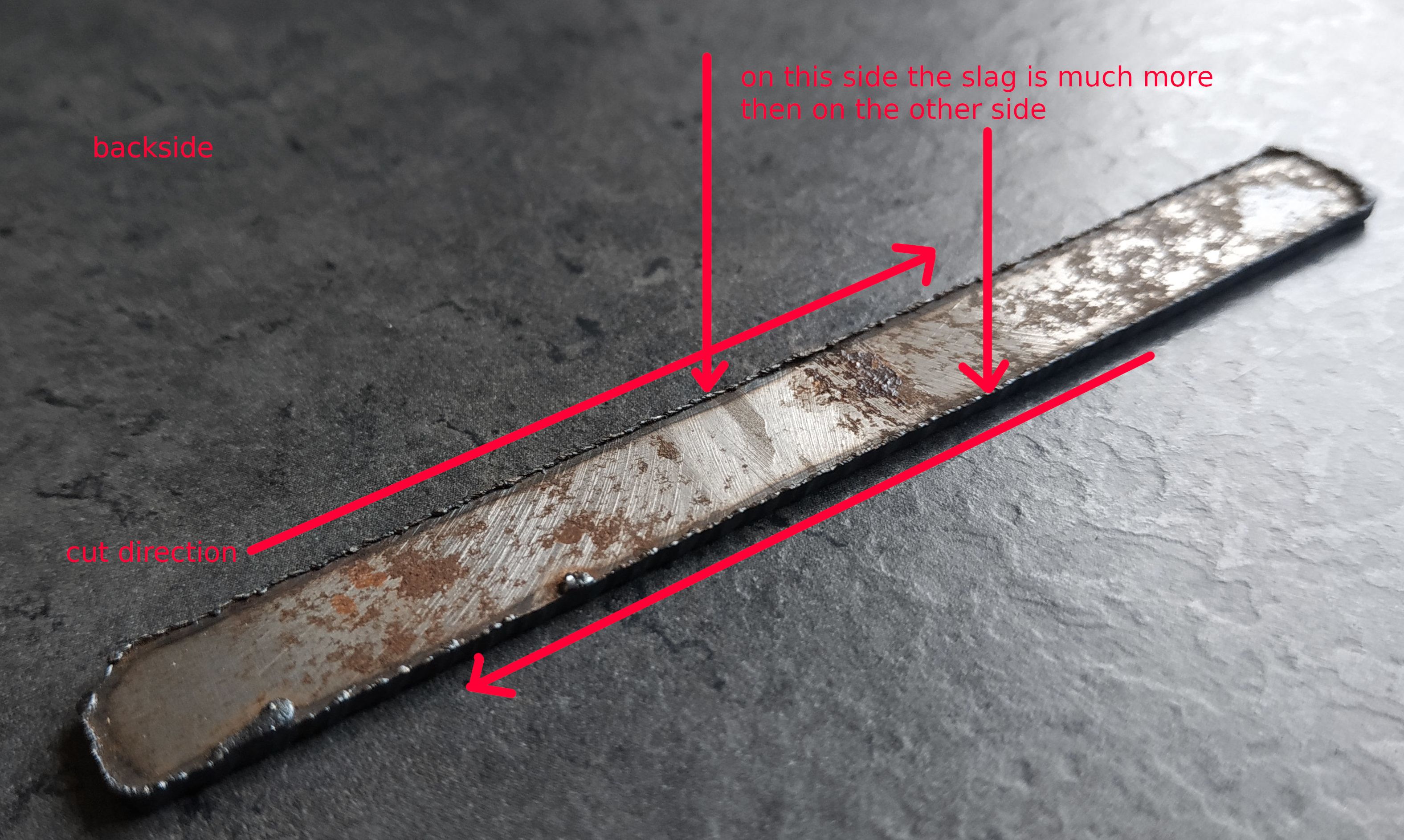

nice result.
all new, cut high 2mm
i try to cut small pieces and filigrant pattern
but slowly i think this is not possible with plasma cutters.
not the ones in this preice range

Plasma is a "brute force" type of machine, so not for small or intricate designs, still a lot can be done with it.
What nozzle are you using?
Why 25A ?
-Set it at 40A and try it faster, see how that goes.
-Also, change the nozzle, set the pierce height to 3 or 4mm and test if it fires consistently, try different speeds...
-25A is not good as the nozzle has to be very close to the material
-Nozzle will have to be changed anytime the material flexes when probing and the torch fires very close or touching the material
-use 1mm or 1.1mm nozzle for 2-3mm @ 40A, 1.3mm or 1.4mm for 4-6mm @ 50A
Why 25A ?

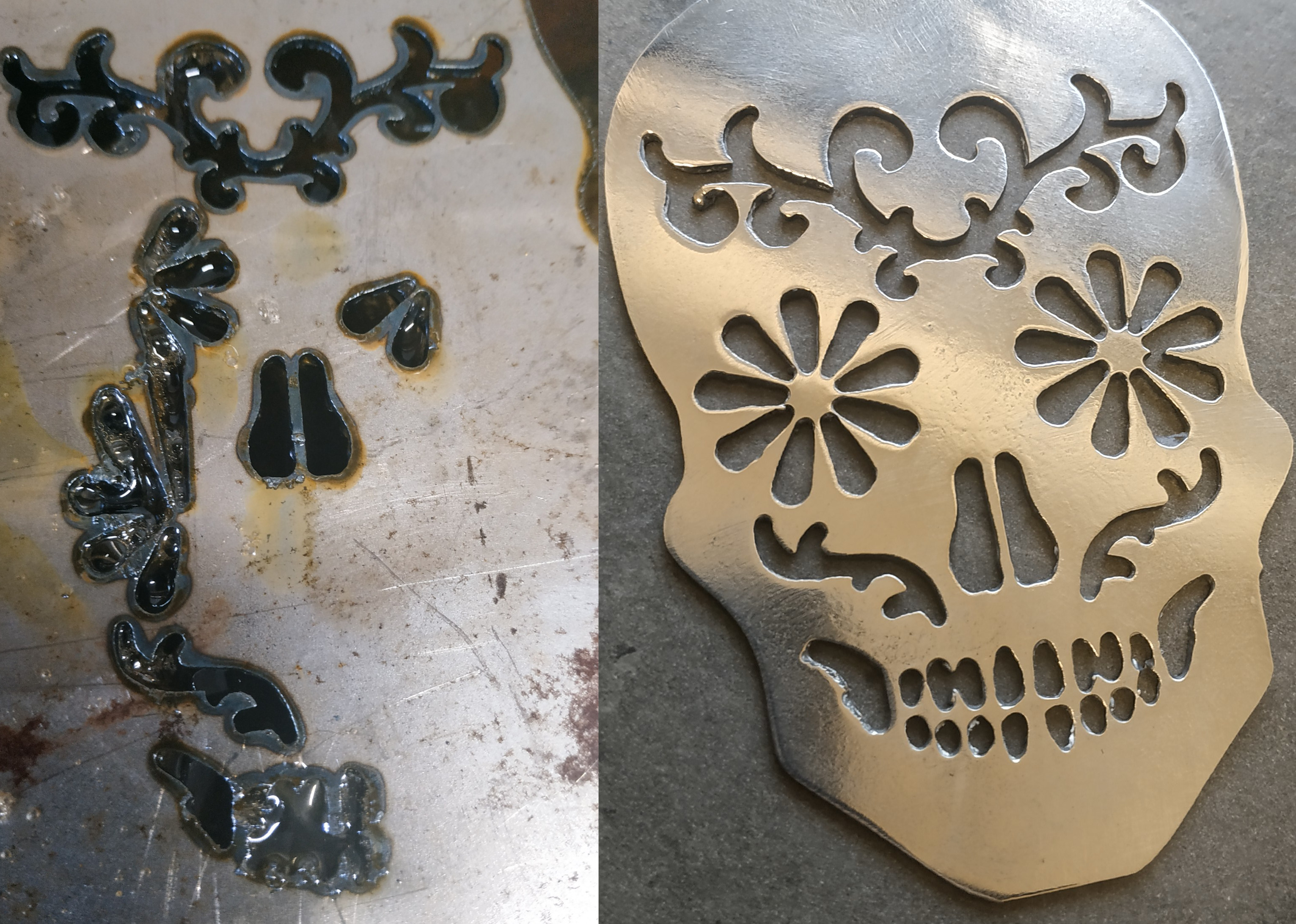

I cut a lot of artwork/signs from 1.2mm or 1.6mm.
I have found that 40A (on my little plasma) with a 0.9mm nozzle is best. I run a pierce height of 3.4mm. Cut height of 1.2mm.
Normally moving around the 2800mm/min mark.

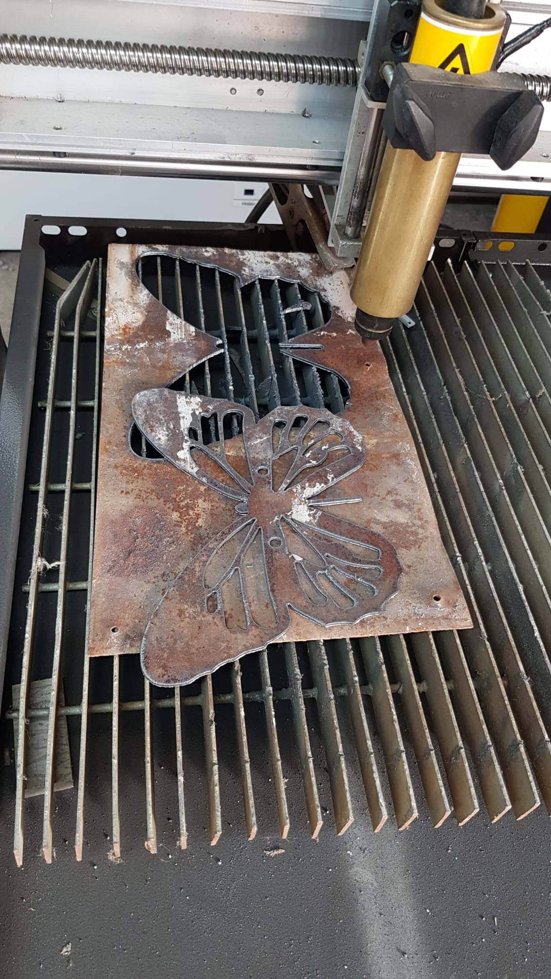

22 Jul 2021 18:53 #215610
by Giuseppe
Replied by Giuseppe on topic New Plasmacutter
thanks for the comments. I will try tommorow. Yesterday i do this little test after optimizing the motor attachment in the x and y axis.
Now it use springs to press motor to the racks.
I think it is a bit better then before.
Second pic is after editing the axis.
Tomorrow i will try with the parameters you tell me.
