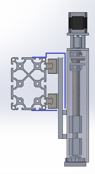

15 Aug 2022 12:46 - 15 Aug 2022 13:54 #249777
by pit34
Replied by pit34 on topic Best rails position on frame in a dusty workspace
Ok, thanks. I have easily founds Kevlar ones in France. So I will go for this solution.

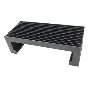

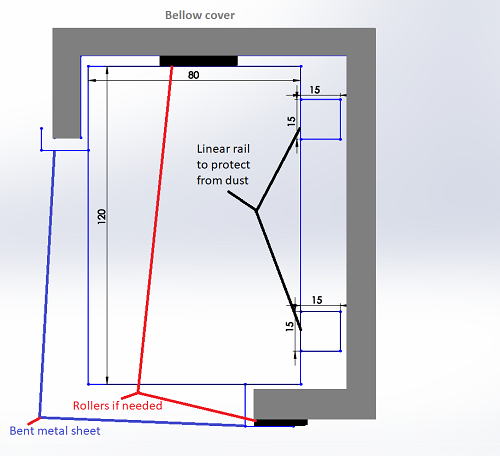

I am thinking since few days about how to protect Y axis rails. I do not want to let rails exposed to dust, so I have found two solutions. The first one is to use "below covers" like this :
Those cover would be placed like on this picture :
The second one is to use a special Z head design with spacer to be able to put fairings on top of rails. Those fairings would be made of bent aluminum sheet and positioned like the violet lines on this picture :
It is cheaper and simpler to install, but I am worried about geometry issues that this solution could cause. The moment created under the rails in particular.
What do you think about these two solutions ?
Currently, the Y rails are the HGR15 ones, the beam is a 80x120 profile like this one :
The whole gantry without Y motor and torch is about 25kg. So I am pretty close to the target weight.

24 Aug 2022 12:31 #250321
The convoluted load path will affect rigidity, more of a concern for a mill than a plasma.
Your design looks good, and could easily be augmented with brush strips if required.
Replied by andypugh on topic Best rails position on frame in a dusty workspace
The moment on the rails depends only on where the force is applied relative to the rails, it does not depend on what the load path is between the two.
