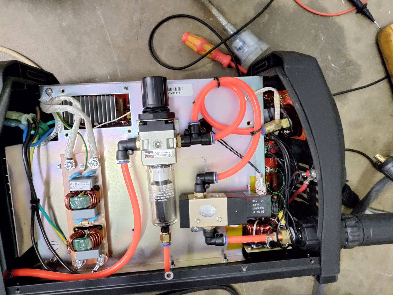

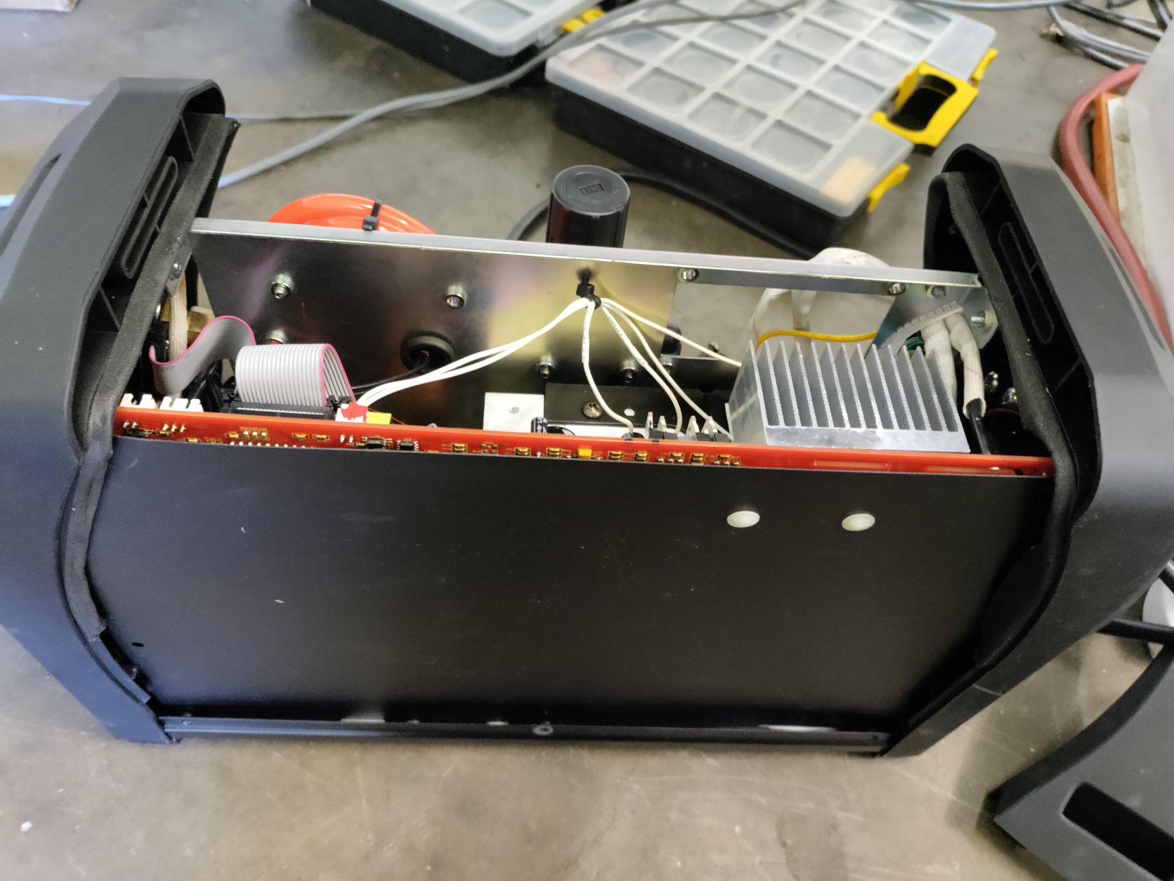

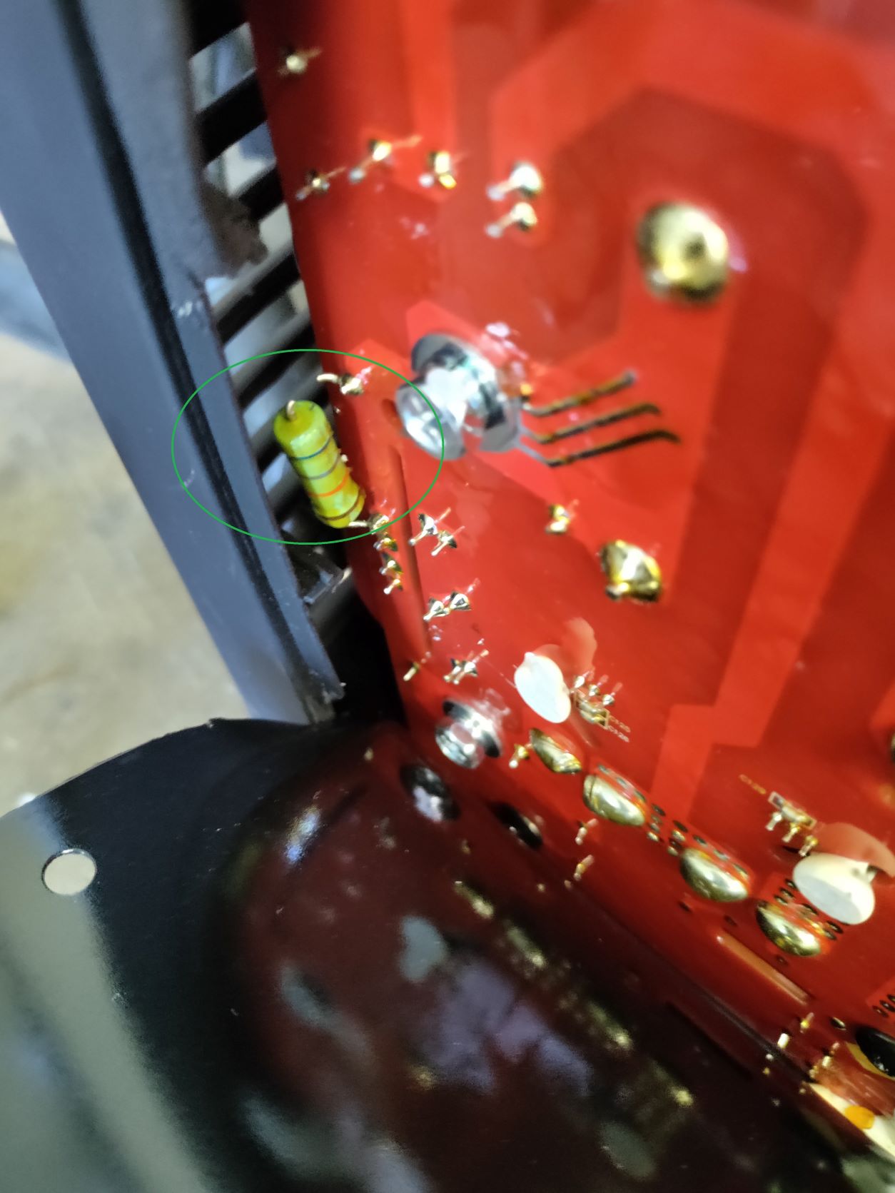

Hi All,
I've been looking for a while for info regarding the Unimig Razor Cut45 mainly the volt divider and cnc port pinout and I have not found much anywhere. So I thought I'd drop this here so it might help someone in the future. It seems that there is a lot of different info getting around, but anyway, this is what I have found with my 6 month old Cut45. I have 2 cut charts that both appear to be very outta whack (for my machine) but I'll attach them anyway.
If anyone else has any good info (manuals, parts lists, cut charts etc) please add it so as to create a bit of a library all in one place, as long as the moderators don't have an issue with this thread.
BTW I am a sparky so I took all the necessary precautions when I had the unit open, you SHOULD TOO which may mean using someone else to do the work.

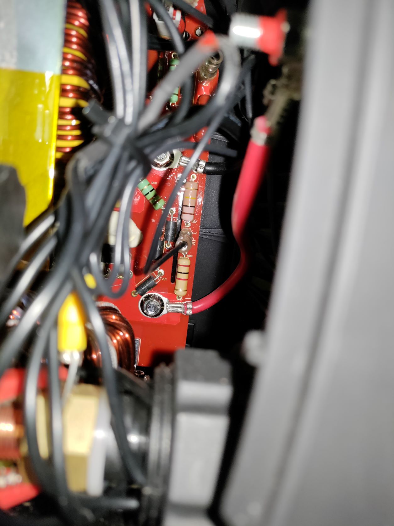

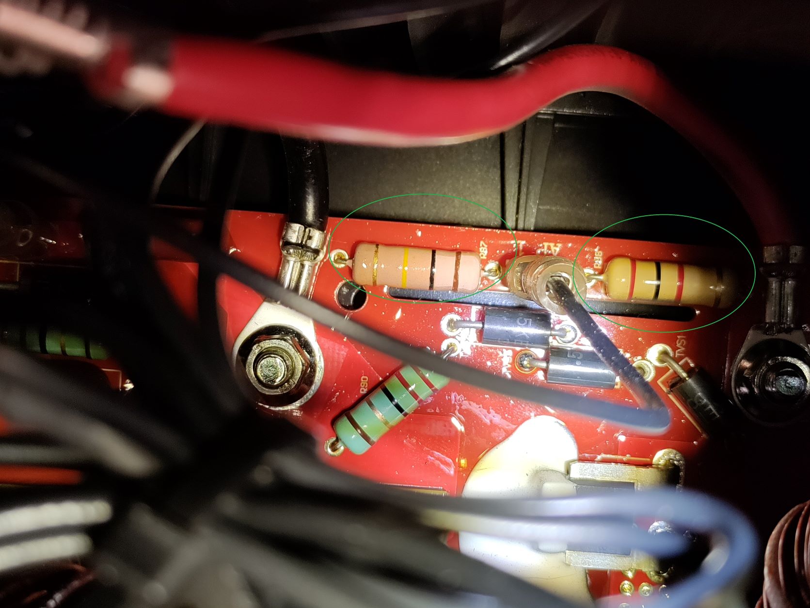

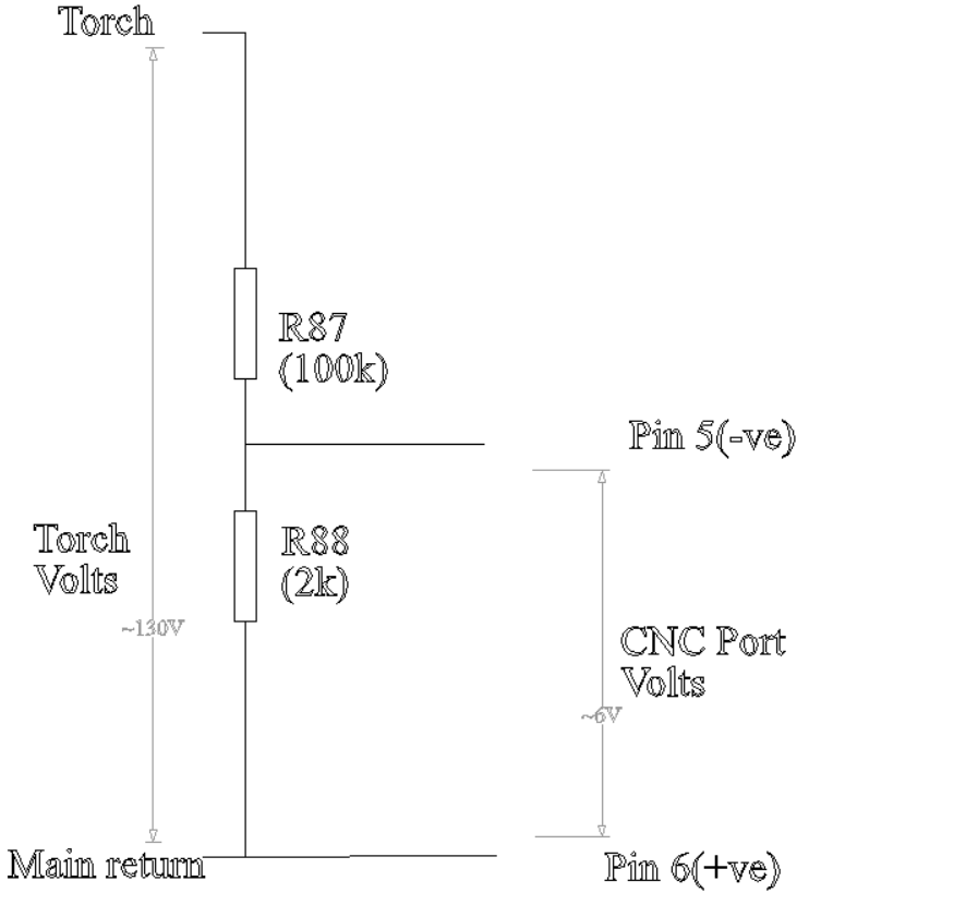

So when I bought the unimig I opened it up and found 2 resistors listed as R87 and R88 which are listed on an attached doc i found somewhere on this forum. R87 is 100k and R88 is 2k ohms which works out to roughly 50:1 (51 actually), so I thought that was the ratio I had. I also proved that the volt divider volts didn't exceed ~6V. When I fired it up with my arduino uno THC attached (with a programmed 50:1 ratio), I found that the torch voltage did not match the THC display.
So I set about proving what the cutter was actually putting out before I went any further. I used 2 multimeters and found that my unit was set up as a 20:1 ratio. I did find on a doc that 20:1 was the default which this test backed up. I did this via the 2 procedures below 'resistance tests' and 'voltage tests'.
Resistance Tests::
I used a multimeter to test the resistance between the following points (please see pic of divider):
- the main return (work clamp +ve) and cnc port pin 6(+ve) -- this was a dead short as expected
- the main return to cnc port pin 5(-ve) -- this showed 2k ohms
- the torch supply to cnc port pin 6(+ve) -- the showed 42.5k ohms (not what I expected)
- the torch supply to cnc port pin 5(-ve) -- this showed 40.5k ohms (not what I expected)
Voltage Tests::
I connected 1 meter on the torch supply and main return and the other on terminals 5 and 6 on the CNC port. I roughly received about 130VDC and 6VDC respectively when activating the torch without cutting. (the voltages fluctuate a bit so that's why the ratio is a little off.)

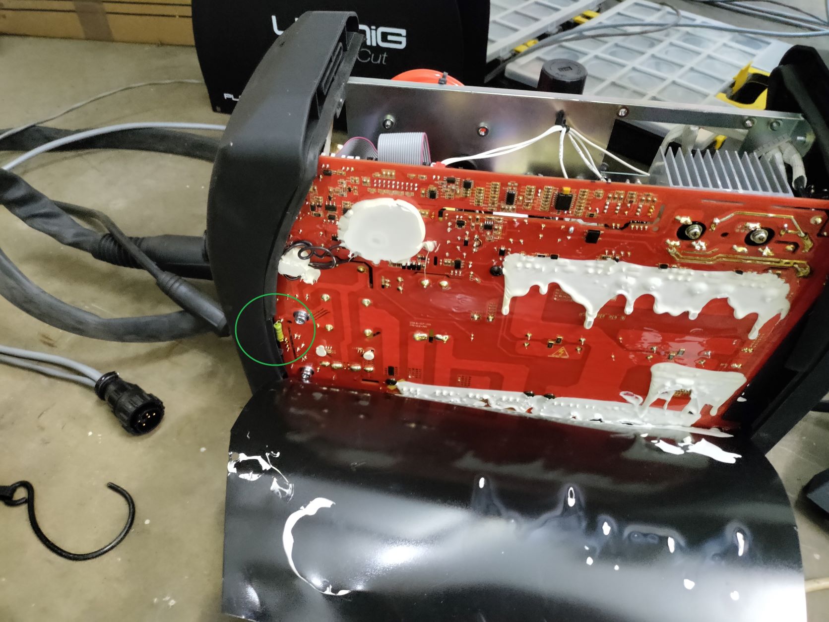

The resistance tests above indicated that there is more resistance in parallel with the 100k ohm resistor. One of the docs shows that a 20:1 ratio requires a 68k ohm resistance in parallel with the 100k and if you calculate the resistance of those 2 in parallel have a guess at what you get..... 40.5k ohm. This is the same reading as the last resistance test above.
So I had a better look (a few times in fact) and I finally found another resistor (68k) with no name on it on the opposite side of the PCB, directly behind the R87 resistor. To get an eye on this resistor you have to remove an insulating plastic sheet that is glued and pinned (nylon pin) to the PCB. Once the 2 nylon pins are removed from the PCB the sheet can be peeled back to expose the glue now holding it on. I used a screwdriver to start removing the glue from the sheet, it came away easily but was stuck in a fair few places. Once I had access I double checked that I had the correct resistor by doing a few more tests back the torch and cnc port pins. Then I cut one leg of the resistor off and did the resistance and voltage tests again and sure enough, I now had a ratio of ~50:1 (51:1 actually). So see below for some pics which hopefully might help someone out.
Hopefully, that wasn't too confusing.

How are you measuring torch voltage to want 50:1? This modification is probably not required.
If you are using a THCAD10, 20:1 is preferred. This means your full scale (10 volt) will allow you to sence 200v and the THCAD overvoltage protection extends to 500 volts. If on piercing the voltage exceeds 200 volts briefly, it won't matter as it is not at a time accurate voltages are required for torch height sensing. eg. before the pierce delay expires.

I suspect your voltage sensing is not calibrated correctly. I ahve not used a Razr but others on the forum have. I would expcect to see the voltage 1round 110 volts.

Potentially. although I have done some testing using a calibrated fluke multimeter alongside the arduino and they were fairly close. But my plan is to run some more tests as soon as I can find some more scrap.
Also the program does not update the arduino display as regularly as it does for the height control.
The unit says it is a max of90V 98v which is obviously not correct but looking at the charts I have found so far, some of them mention 150v cutting. When using the max function on my meter I pick up what I believe are spurious spikes up to 300v, but I only get 135V typically at a max with the meter showing live measurements, so not sure how those charts came about. I'd love to have access to a data recorder/scope to get a better pic. A THCAD would have helped a heap, live and learn. I can't warrant spending the same money on postage as the unit.
