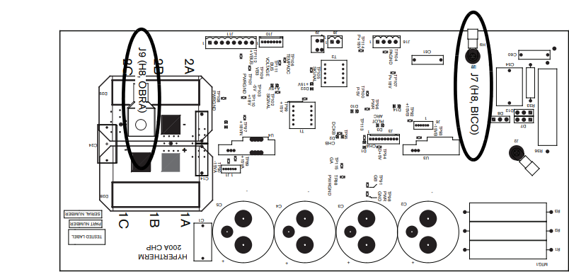

Actually for the MAX PRO 200 we may all be in violent agreement.
Since on that machine the torch voltage is taken across the 350 UF output
capacitor, so no HF. There is no 10KV at the torch terminal since the 10KV is only used
for starting the_ pilot_ arc. This is in contrast to HF start machines that have a
start coil in series with the main plasma voltage.

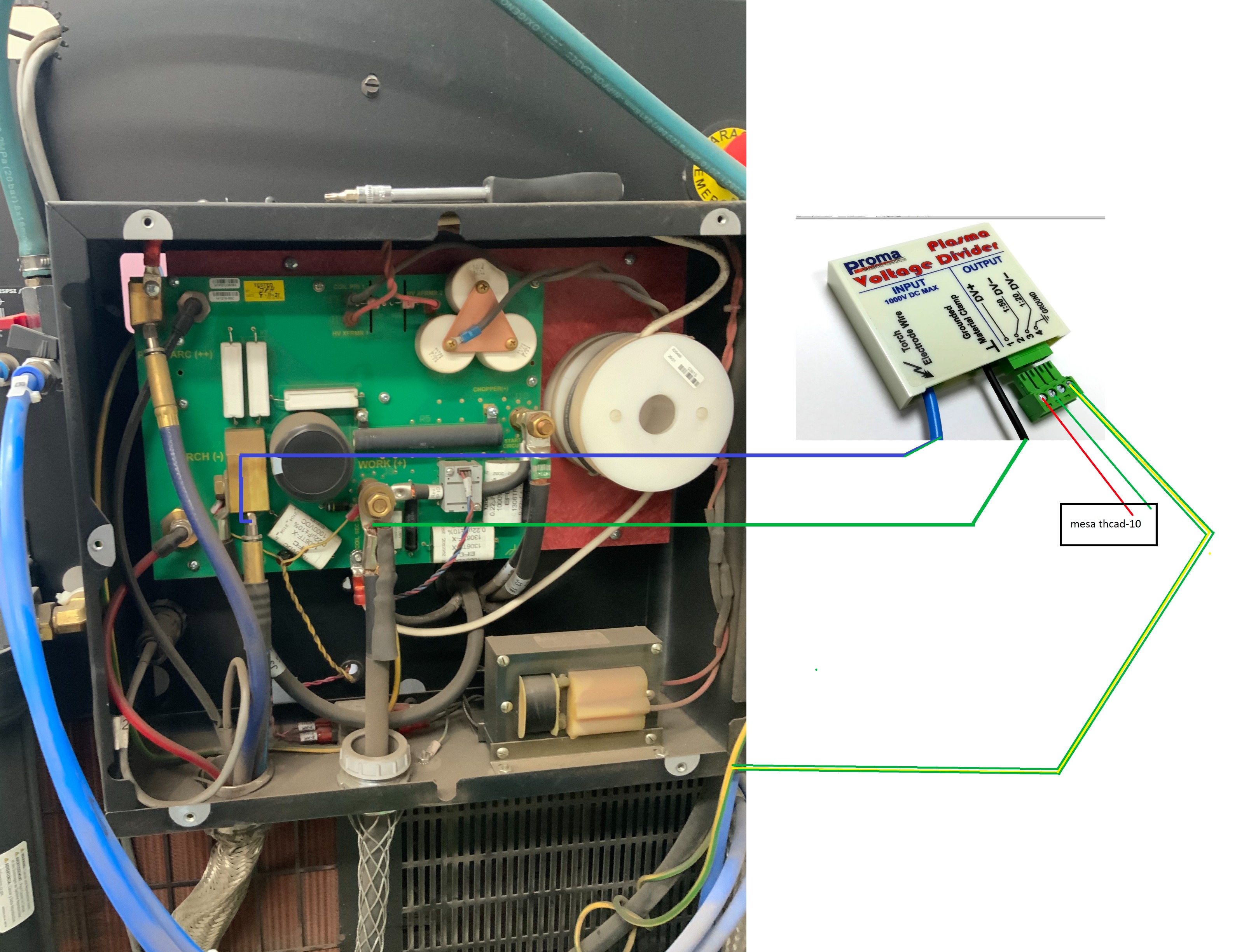

Replied by tommylight on topic Hypertherm MAX PRO 200 CNC Connections - Quick Question
This is the picture OP posted if his machine:
Notice anything strange?
NO electronics!
Reason being those white things are the high frequency coil and the spark gaps, those emit huge amounts of interference over the air, wires, everything that is not shielded.
The electronics are on the other side behind a metal wall.
So again, that is the worst place to wire the THC, and no amount of wishful thinking will change that.
All those Hypertherms have terminals for wiring THC.
NO electronics!

Hello Everyone!
I thank you for your kind replies. I have been away from the PC for a while fixing the machine!
Nothing has happened, and my THCAD is working perfectly actually, cutting on a daily basis with height correction.
the thcad is thcad-10, so im only feeding divided voltage. even if it has 10.000V peak, which would more easily kill the proma (?), on the thcad side it might reach a 200v peak, which i believe it will handle.
I have put the terminals connected to my proma divider, and the proma is grounded. the terminals are not in the place of the picture, they were placed where the manual tells you to place it! ahah
thank you all for your kind help!
