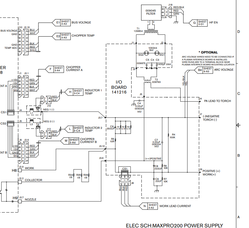

30 Sep 2023 13:26 #281933
Replied by rodw on topic Hypertherm MAX PRO 200 CNC Connections - Quick Question
Tommy knows more than me on this subject so I have included a copy of the drawing but I would have thought J3.6 an J3.7 would be better places to pick up the voltage for a THCAD. That seems to be where PCW suggested.
It does not really matter how long the HV pulse is, it can still damage stuff. I can understand your reluctance to deviate from the manual

30 Sep 2023 14:20 #281935
Replied by PCW on topic Hypertherm MAX PRO 200 CNC Connections - Quick Question
Actually there is no real issue with this type of machine (HF pilot start) since the
arc voltage is always taken across the output capacitor so contains no HV/HF.
That is, only the pilot connection has the high voltage high frequency signal.
The issue is with non-pilot HF start units where the HF start circuit is in series between
the main plasma supply and the torch.
On these machines the arc voltage must be taken ahead of the HF transformer.
(unless you want to make your EMI issues much worse)

30 Sep 2023 16:01 #281941
by RDA
The only thing you need to be worried is, like Tommy said, HF noise, but that's EMI, quite strong EMI. For this reason (similar to ohmic sensing) you would want the resistor network to be pulse withstanding.
The way the pilot arc is ignited with HF, as explained in the maxpro manual, is how all the major branded industrial plasma's are done. The HF is done between nozzle and electrode.
Replied by RDA on topic Hypertherm MAX PRO 200 CNC Connections - Quick Question
Exactly and if Rod looks at the schematic the you want to measure arc voltage between work and electrode, those in the "same" position are in the manual J3.7 and J3.10, you do not want to measure the tip voltage, that would be the 3.7. And if you follow the J3.7 and J3.10 it leads directly to the backwall work and electrode terminals.Actually there is no real issue with this type of machine (HF pilot start) since the

30 Sep 2023 16:37 #281942
Replied by tommylight on topic Hypertherm MAX PRO 200 CNC Connections - Quick Question
See "optional", it literally says the wiring is taken from a terminal block near plasma interface board, not where the drawing shows them.
It also shows:
- 2 of spark gapes rated at 5KV in series (read about it, or you will think this is the max, it is not)
- several 20KV capacitors in parallel to high voltage transformer
-- means the voltage is over 10KV but under 20KV.
And a lot of over 1KV parts on the outputs.
The HF/HV transformer has one side wired to positive, so that would make it's way to THC if taken as shown, but in this case would still be OK as PCW mentioned.
The fact remains, those are the same wires so does not influence readings, but where you wire the THC does matter a lot. As far as possible from HF/HV stuff, and sure as hell not at the torch terminals, not even for blow back start that produces the least amount of interference.
Yet, there are THC wired to terminals and working, but the risk is way to high to tell people it is OK.
Even if the THC survives and works, any personnel working on the machine might have hands touching the THC wires in the control box when the torch fires thinking it is 5V or 10V stuff, most probably will survive blow back and be dizzy for a day or two, most probably will not survive HV or HF/HV, if wired at the torch terminals.
-Examples

30 Sep 2023 16:48 #281944
Homework for you, get a DVM and measure the voltage between nozzle and work piece when the torch fires, it is OK as you say as it is between ..... It is not OK, it will blow your DVM
This has become an exercise in futility.
You really have to stop insisting on this, you keep forgetting the arc is used to make a path for the high current, so it is connecting torch electrode to work piece, sending the full brunt to THC, if connected at the torch terminals.The HF is done between nozzle and electrode.

After looking at the video and still believing that the HF is not done between the electrode and nozzle, I give up. As stated by me earlier, this is how the arc ignition is done byt all the major industrial plasma brands. If a xyz chinese manufacturer does it differently, then they do. But the topic was about a Hypertherm Maxpro.
Edit: If anyone still thinks I am wrong, despite on my drawing (that I deleted on request), my efforts in trying to explain through schematics and even referencing to an old Jim Colt post, please check the youtube video below published by hypertherm:
Understanding plasma arc ignition
Last edit: 30 Sep 2023 20:55 by RDA.
