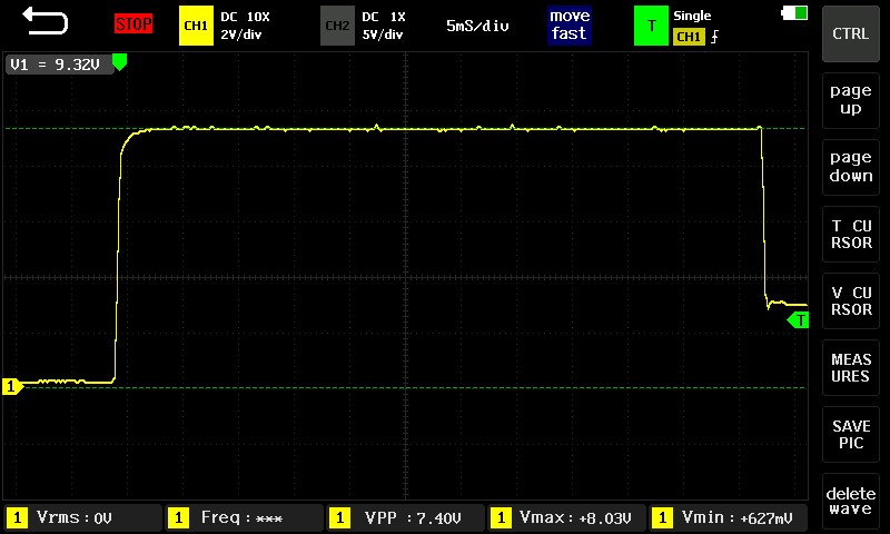

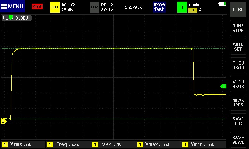

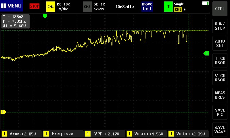

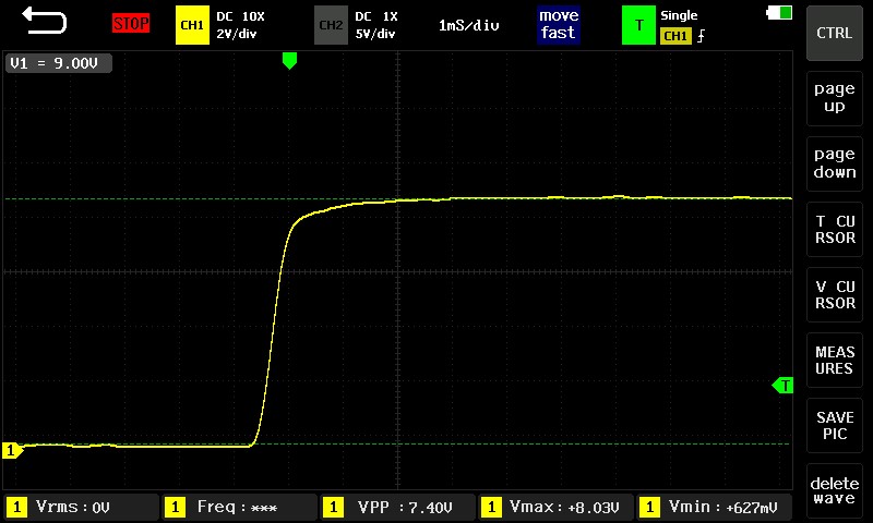

Sorry took a while but I did hook up a scope to a highdef plasma with HF start. Measurements taken directly between electrode and work from the 50:1 output.
I could not capture kerf crossing that well as the change in voltage was so slow and my portable scope is what it is... Closest thing to kerf crossing was running out of plate and that I could capture so I did that.
How I see from these scope captures is pretty much as I though. You can see from both 50A and 100A pierce that during pilot the voltage hits a "ceiling" that is the OCV, then drops when it transfers to plate. Then when you run out of the plate it looks to me that the voltage hits a "ceiling" that is the max DC output of the plasma, 50A and 100A look very similar.
I dont have a current probe, now at least, so I can't capture the current ramp up but in the highdef stuff I would assume this is measure in some hundreds of ms instead of ns again I cant really prove this as I dont have a current probe.

If you measure from the work to signal ground with a GHz capable scope at say 1ns/per division,
You will see fractional ns spikes of significant voltage on the work (or low end of divider)
( arc starting is instantaneous an even if the current ramp is controlled, the plasma wiring
has significant capacitance)
