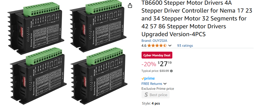

the cheap drives i got are only rated for 42V so i am looking to run them on 36v, this is going to be on the cheap side for builds. i don't do things as pictured by others i just use it for a starting point for planning. i plan on using double shielded wires everywhere with shield drains on everything. i have spent a lot of time reading up on grounding and a lot of it was plasma related for a source. i have seen way too many builds get sideways because of grounding issues

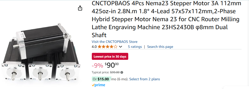

the Nema 23 motors i picked up and dives were only $110 for 4 so nothing very fancy. THCAD is about the cheapest height control on the market, so being able to do that makes me happy

this is what i went with and the cheapest is what drove this decision. Since i have never done a plasma machine before top-of-the-line stuff is is not something i want to do on a first-time build for plasma., these drives are rated for 42V so 36v is safe and should do what i need them to do. i plan on keeping the gantry very light, plasma should not need anything to rigid. my thought is 11-gauge square tube should do fine, i honestly don't think you need much more than 1 linear rail on the gantry maybe 2 on the Z but 1 there too would probably be enough.
i will be doing my planning in fusion 360 to work out a final game plan, i might try to design things so i can add a rotary later down the road if i want to get into than later. This straight torch is pretty long so a z with lots of travel is probably something i will factor into a design. Z height is something i would avoid in a milling application but with plasma it should not matter much.
Replied by machinedude on topic Black Friday Deal got me :)

I have those drives, they are good, they have issues, and for sure will die at 42V!
Those use the TB67S109 chip (IIRC) that has the absolute max rating of 40V or 42V, and a working rating of 24V, i have them running at 27V without issues for years, but i would not go any further than 32V.
They have good microstepping, have some protections, and do not die like TB6600, also less sensitive to EMI than TB6600.
Also cheaper than TB6600.
Max current is 3.5A, should be plenty.
