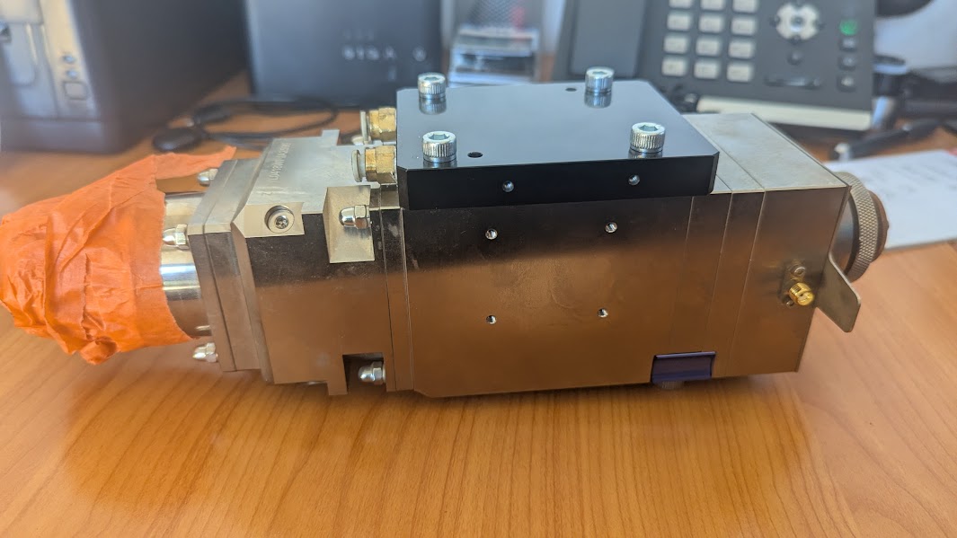

Hello everyone!I have completed the design of a laser head height sensor. While it was originally developed for systems other than LinuxCNC,
I would like to extend its compatibility to this popular and highly capable control system.Is there anyone here who could help me/ be a beta tester? I have no experience with LinuxCNC.Available output configurations:
- Direct processing: capacitance/voltage 0-10V (nonlinear)
- Linear processing: 0-10mm → 0-10V (reversible)
- Linear processing: 0-5mm → 0-10V (reversible)
- USART 57600, 0.00-10.00mm with 0.01mm resolution
Last edit: 27 Feb 2025 07:03 by prokopcio.

27 Feb 2025 10:35 #322800
Replied by rodw on topic Laser Head Height Sensor – Looking for a Beta Tester
If you get stuck, I am in Australia and have a 500W laser head I need to buy a BCL-AMP for.

27 Feb 2025 14:43 #322818
No, the system will be linuxcnc, the head does not yet have a BC-AMP but there is provision to mount an amplifier to existing tapped holes. So at this stage I don't measure anything!
Your unit should fit and it would be up to me to adapt linuxcnc to read your system and interpret the results for height control.
I have previously beta tested some hardware for Mesa and developed an ohmic sensing component for linuxcnc, which is now part of linuxcnc that enables the hardware I tested.
linuxcnc.org/docs/stable/html/man/man9/ohmic.9.html

28 Feb 2025 02:34 #322856
by prokopcio
Replied by prokopcio on topic Laser Head Height Sensor – Looking for a Beta Tester
fantastic.
There is still a possibility of implementation, so I would like to adapt it to LinuxCNC as much as possible.
I am not sure if it makes practical sense to process data multiple times, which loses measurement accuracy and introduces additional errors at each stage C/f -> U -> f ...
i can made frequency output directly in sensor.
I see that the THCAD5 card processes voltage to frequencies in the range of 100 kHz - 1 MHz, but I can adapt to any frequency (lower frexuancy could be directly monitored in many "less efficient" controllers and send via cable easyer ), it can also be a PWM output or serial communication, which I can send a ready-to-use height without the need for the CNC system to process the signal, which in my opinion would be the best option.
In your opinion, what would be the best option?

28 Feb 2025 03:39 #322860
Great! Let's move ahead.
Let's talk about 0-10 volt range first.
The Mesa THCAD is a voltage to frequency converter. The THCAD10 has a 10 volt full scale. The THCAD 5 has a 5 volt full scale. The newer THCAD2 can be configured to either have a 10v or 5v full scale range. For your hardware, the 10v range sounds best.
We read the frequency using an encoder A input (usually on a Mesa card) and then scale it internally back to a voltage. Usually we set the THCAD's on board frequency divider so we read 1/32 of the frequency when sending it to Linuxcnc.
To receive a frequency, we would simply connect your hardware direct to an encoder A input and not use a THCAD.
It would be easy to apply a mathematical function to the encoder frequency to convert to a voltage in a real time component written in C.
There are other options to read both voltage and frequency. For example, appropriate Ethercat slaves for both voltage and frequency are available.
I think for Ethercat I would prefer 0-10 volt.
Finally, I might mention that for plasma torch height control, we adjust the height using external offsets (this offset is external to the motion controller). A scaled count (much like a MPG) allows us to take the input and output a height adjustment of the error. But because you output a distance, it might be possible to manage height control via one of Linuxcnc's PIDS.
Anyway, if you have a contact us option on your website, let me know, and I will reach out to take things further.
