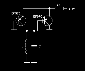

I would be happy to buy your sensor, but delivery to our country does not work. If possible, share basic information about your developments (source code is not needed), this is very interesting and can motivate many to develop their own sensors. From simple ideas, study the BCL-AMP circuit and create on one board together with a fast microcontroller (like on BCS100) and EtherCAT on LAN9252.
Several people have analyzed BCL-AMP circuits – these are very simple LC generators built from just a few basic components like here:
BCL-AMP
Someone even posted a example schematic like the one below (not the same device but simply).
I tested it, and it works, but as you correctly pointed out, it requires advanced processing, like in BCS-100 controllers, for example, which is not a small cost. I had to look for other methods, and measuring the charging/discharging time of a capacitance with a very small variable current turned out to be a more effective approach, so I pursued that direction. The output interface is a completely separate matter – I chose a simple 0-10V signal and a variable frequency range of 20 kHz - 70 kHz.

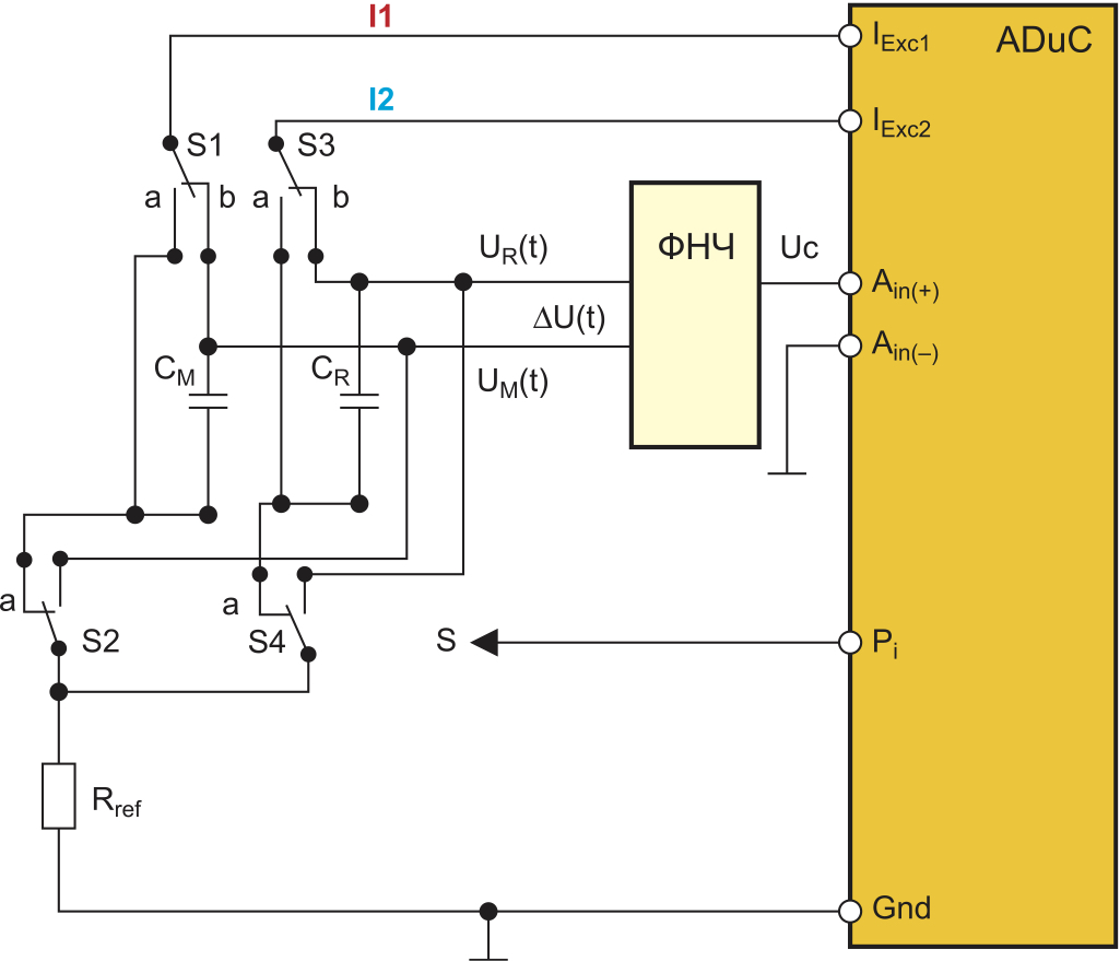

Having studied the information a bit, I think you are using something like this. This is an interesting method, but it has a number of its own shortcomings. In addition to 7745, there are many more successful chips (for example, ZSSC3123AA2R, MAS6513, PCAP04, or the simplest   cav424 with an external ADC).
I will reveal the details that I found out on my own and were hard to find on the Internet:As for AD7745/AD7746, I tried to use it as a controller for gas burners. It was not easy because it worked on the desk, but during cutting, the gas changed the parameters very much and the AD7745/AD7746 measurement method was not suitable.1. It is not suitable for lasers because the reading is too slow 90Hz.To make sense for Lasers, the absolute minimum sampling is 500Hz (2ms), I have 3650Hz sampling but I do not want/cannot reveal why this value is chosen and it should be selected for a specific type of processing.2. AD7745/AD7746 have a measurement range of 17pF (60pF tollerant), which is definitely too little because the parasitic capacitances on the wire, head, etc. are 50-200pF3. The useful measurement range of the distance is 0.1pF - 30pF, although for some types of nozzles the range may be wider4. I chose the method of measuring the capacitance charging time, although I also experimented with measuring the frequency as in BCL-AMP BCS, which was a bit less stable but also very good.5. Unfortunately, I did not find any ready-made circuit like AD7745/AD7746 that would be suitable, and I had to design everything from scratch.

14 Mar 2025 07:51 - 14 Mar 2025 08:05 #323919 by prokopcio
Yes, this is one of the methods that I tested with great success, eventually I added a large coil in series to stabilize the charging current.
You have a very lot of knowledge so I think that you will be able to create such a open-source sensor using any of basic methods. The easiest way is to use one of ready to use CHIPs that you gave as an example ( now i haven't time to analise it / *conversion time should be fast ) or add any converter to good and very cheap BCL 1-3MHz generator.
I everything projected handly without use ready to use external chips but it required a huge amount of time for experiments and optimal selection of component values. It was not easy.

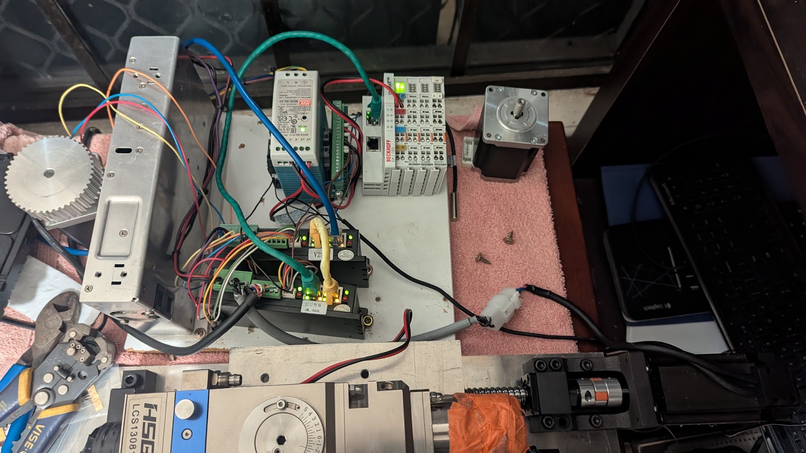

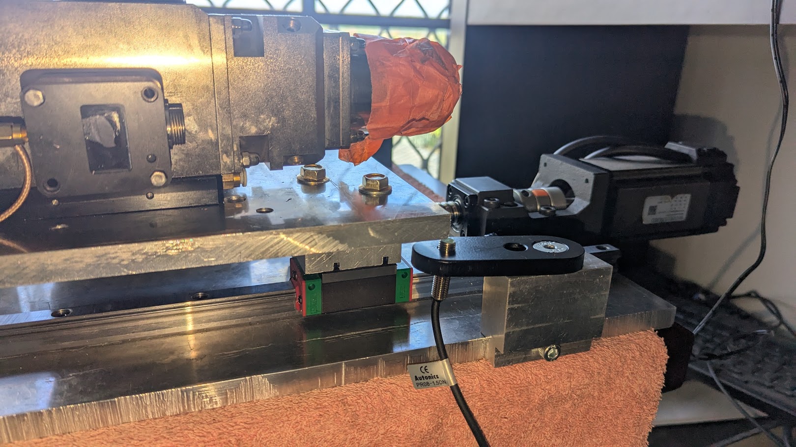

17 Mar 2025 08:23 #324112 by rodw
Beautiful! Nowhere as near exciting here. But I have reworked my ethercat lab and have some beckhoff slaves installed for the first time (after I found an ethernet cable was faulty!)
I still have to get the homing switch working. The 8mm sensor does not see the aluminium so it needs a strip of steel fitted :(

27 Mar 2025 05:16 #325039 by prokopcio
smapp progress but still not too perfect.
But it's simply stepper motor only ;)
27 Mar 2025 06:05 #325042 by rodw
That is crazy! Still waiting for a 0-10v beckhoff module to arrive here. But just tonight I found a metal shim from a DRO mounting kit and some 3M decal self adhesive mounting glue strip panel beaters use. Press part on, glue peels off onto it then press it on where you wanted. So now my home switch triggers. The 8mm prox sensor would not see 12mm thick aluminium!
