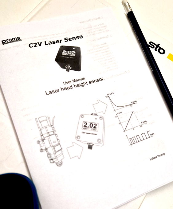

03 Mar 2025 12:29 #323098
by prokopcio
If in your opinion square signal 20kHz = 70kHz for 0-10mm distance ( 0.05kHz / 0.01mm resolution ) is good idea ?
And 10kHz for colision.
Replied by prokopcio on topic Laser Head Height Sensor – Looking for a Beta Tester
Hi PCWI would say a couple hundred KHz so pretty much any encoder interface could work.
Also better if its a square wave so it asks the least of the frequency/period counter.
An offset frequency is good also so you don't lose bandwidth near 0 frequency.

03 Mar 2025 13:37 #323107
Replied by PCW on topic Laser Head Height Sensor – Looking for a Beta Tester
Yes, 20 to 70 KHz should be fine as it will work with general encoder/counter inputs
and always high enough frequency so the control bandwidth is not affected.

04 Mar 2025 13:23 #323172
Replied by tommylight on topic Laser Head Height Sensor – Looking for a Beta Tester
That did not take long! ?
This makes it usable with Mesa boards and even parallel ports as they can easily count encoder signals

05 Mar 2025 05:51 #323250
by prokopcio
I think it's a good time to send it to you for testing. You'll receive the package next week.
I wonder if it will work as you expect.
Criticism is welcome because it drives me to work properly

05 Mar 2025 06:10 #323251
Replied by rodw on topic Laser Head Height Sensor – Looking for a Beta Tester
Tou must be psychic! I just sent you an email! I havea Beckhoff EL5151 encoder on its way and hope to put a Mesa order together soon too so we can test both environments.I think it's a good time to send it to you for testing. You'll receive the package next week.

08 Mar 2025 11:01 #323532
by prokopcio
I have completed the preliminary version of the documentation.
proma-elektronika.com/download/c2v_laser_sense_en.pdf

08 Mar 2025 13:25 #323537
Very well prepared
