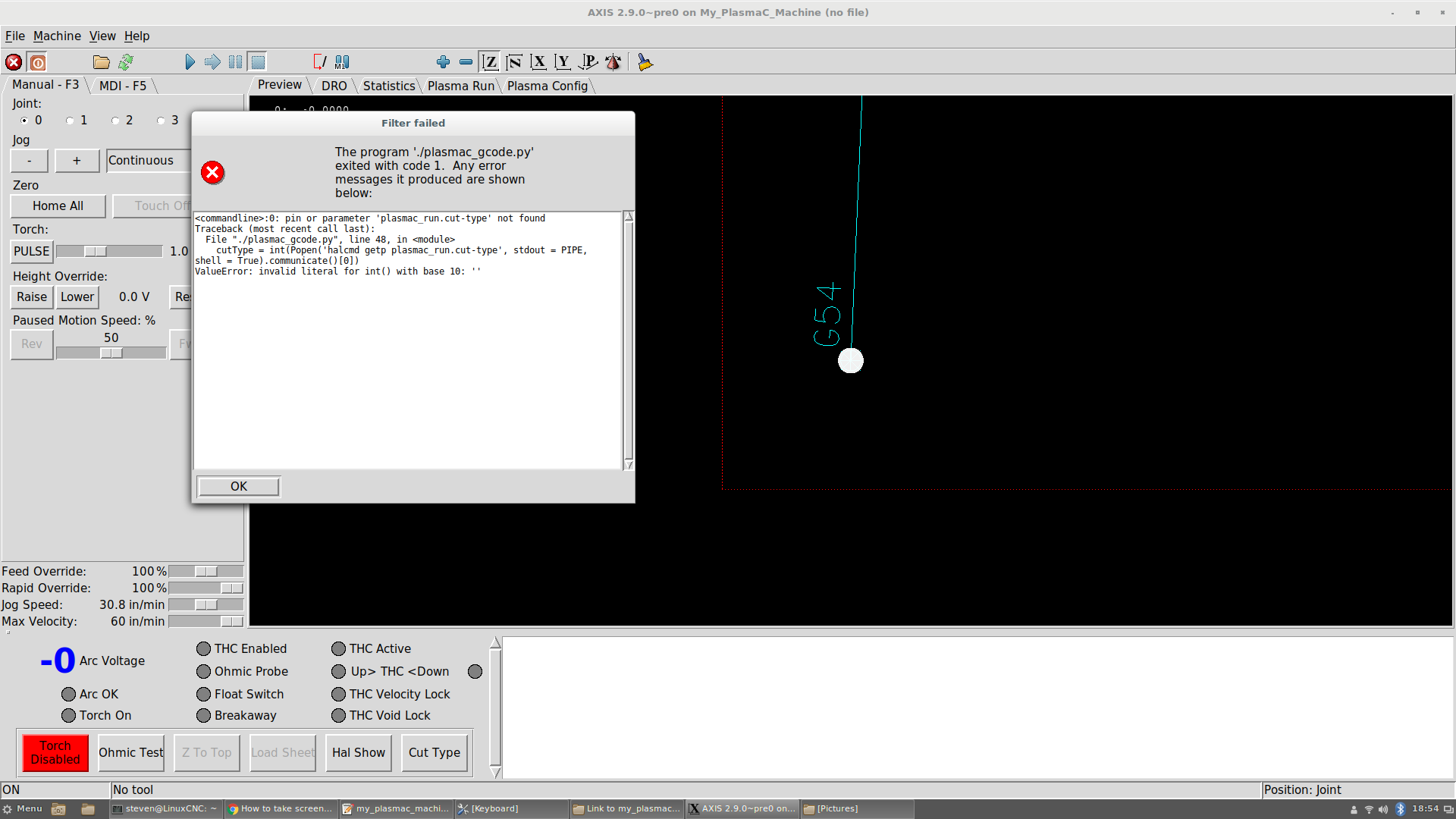

02 Sep 2019 23:47 - 02 Sep 2019 23:55 #143977
by docwelch
Replied by docwelch on topic Trouble changing from Gmoccapy to Axis
With that change, there is no reported error; however, in Hal Show, there are no plasmac_run pins.
When I try to load a file, I get the same error.
Last edit: 02 Sep 2019 23:55 by docwelch. Reason: Added screen shot

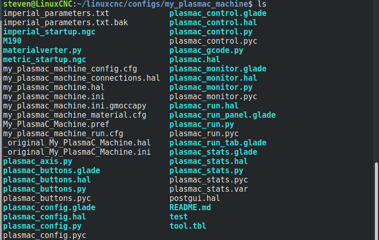

Could you post a directory listing of your config directory.

- docwelch
- Posts: 58
- Thank you received: 25
03 Sep 2019 00:29 - 03 Sep 2019 00:34 #143983
by docwelch
Here it is
