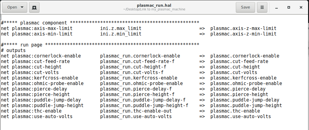

Sorry - I edited my post but no, the run panel is blank.

Does plasmac_run.hal have any content?

Yes. See attached

OK, for some reason that panel and/or HAL file is not loading.
Edit the INI file and swap the comments.
From:
To:
From:
#GLADEVCP = -c plasmac_run -u ./plasmac_run.py -H plasmac_run.hal plasmac_run_panel.glade
EMBED_TAB_NAME = Plasma Run
EMBED_TAB_COMMAND = gladevcp -c plasmac_run -x <XID> -u ./plasmac_run.py -H plasmac_run.hal plasmac_run_tab.gladeTo:
#EMBED_TAB_NAME = Plasma Run
#EMBED_TAB_COMMAND = gladevcp -c plasmac_run -x <XID> -u ./plasmac_run.py -H plasmac_run.hal plasmac_run_tab.glade

That did fix it. The run panel is populated and the plasmac_run pins are showing up in Hal Show. I can run it this way - I actually like the run panel to the side better than being a tab.
