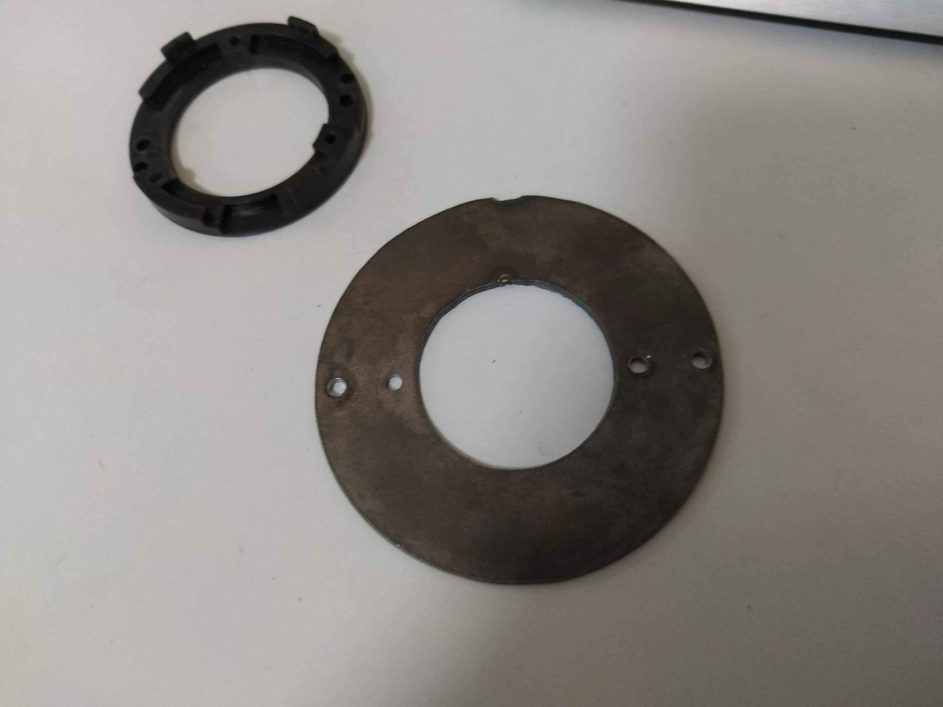

12 Sep 2019 05:37 #144906 by thefabricator03
Replied by thefabricator03 on topic Center Spot Sheetcam Post
I got it to work for my job by stopping and starting the program at each point,
Attachment not found
The spot pecks are very accurate, I drill out the peck and all my holes line up perfectly,
