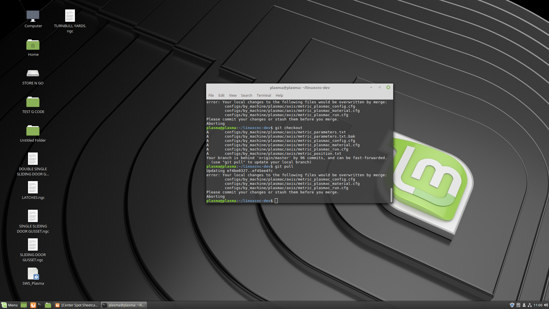

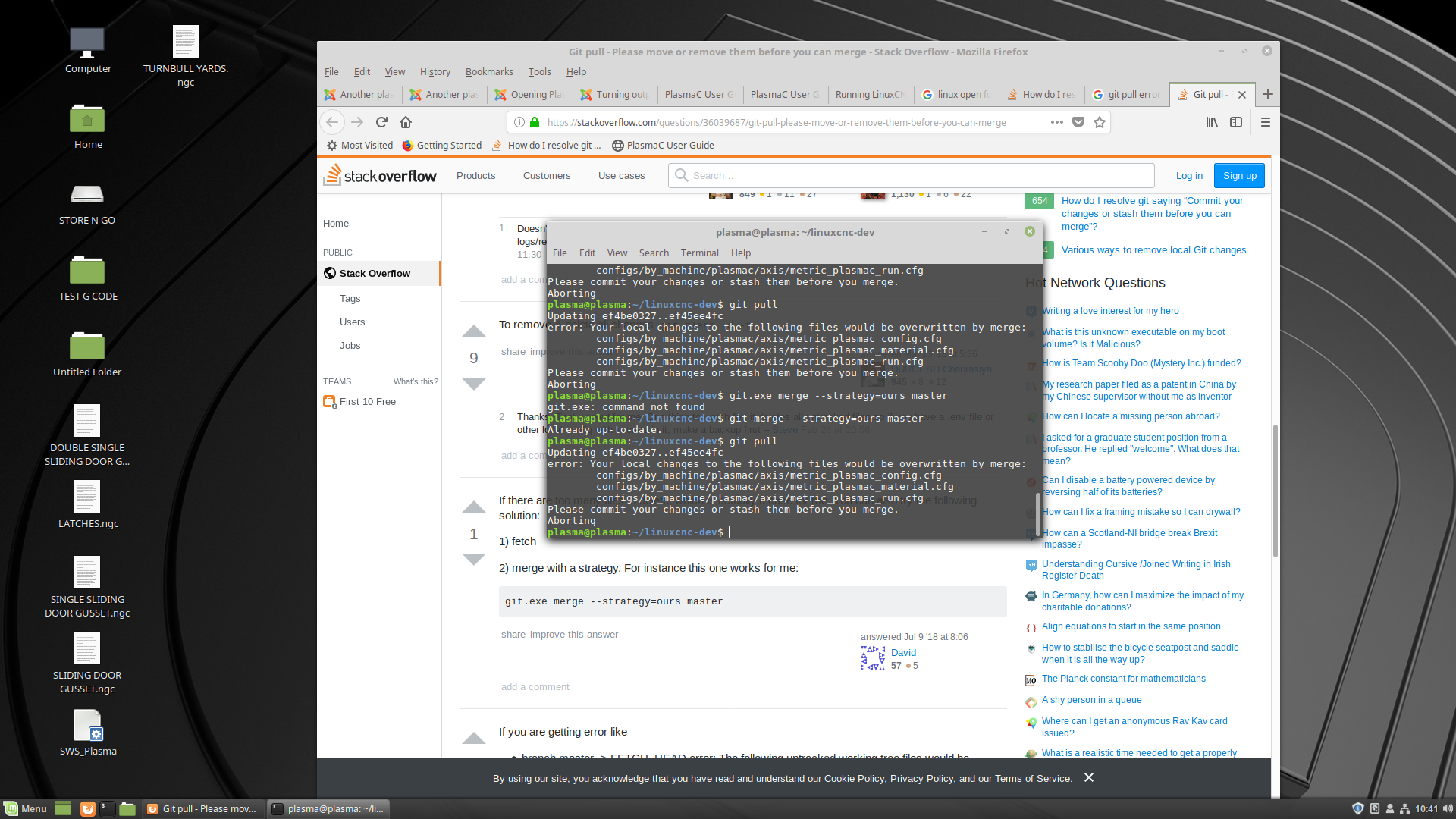

12 Sep 2019 00:43 - 12 Sep 2019 00:49 #144853
by thefabricator03
Replied by thefabricator03 on topic Center Spot Sheetcam Post
Hit a bit of a snag updating my run in place config,
Usually I when I get that error I do git reset --hard and it works but not this time,
Any ideas Phil?
Any ideas Phil?
Last edit: 12 Sep 2019 00:49 by thefabricator03.
- phillc54
- Posts: 5711
- Thank you received: 2100
12 Sep 2019 00:53 #144854
by phillc54
Replied by phillc54 on topic Center Spot Sheetcam Post
It looks like you have used the Sims and saved config changes.
If you don't need them do
git checkout .Please Log in or Create an account to join the conversation.
- thefabricator03
- Visitor
12 Sep 2019 01:01 #144855
by thefabricator03
Did not work,
What next?
What next?
- phillc54
- Posts: 5711
12 Sep 2019 01:04 #144856
by phillc54
Did you leave out the space dot after checkout.
I am on my phone and can't see clearly
- thefabricator03
- Visitor
12 Sep 2019 01:05 #144857
by thefabricator03
I did but when back and did it again and still no luck.
