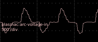

HI! It's me again with this config.
I'm trying to use THC THCAD-10, as it was use before. I did not rewire anything from last year.
So it worked before.
Now if add "setp plasmac.lowpass-frequency" 100 or 50 system crushed.
The program runs a few seconds, and I have time to see that the voltage now shows 0 volts stable. Then the screen smokes with stripes and that's it.
Not linuxcnc crushed, but system.
is very similar to trying to write to a protected area of the operating system memory. seen this before.
plasma@cncplasma:~$ last
plasma tty7 :0 Sat Sep 4 21:25 still logged in
reboot system boot 4.19.0-17-rt-amd Sat Sep 4 21:25 still running
plasma tty7 :0 Sat Sep 4 21:14 - crash (00:11)
reboot system boot 4.19.0-17-rt-amd Sat Sep 4 21:12 still running
plasma tty7 :0 Sat Sep 4 19:25 - crash (01:47)
reboot system boot 4.19.0-17-rt-amd Sat Sep 4 19:22 still running
plasma tty7 :0 Sat Sep 4 19:19 - crash (00:02)
reboot system boot 4.19.0-17-rt-amd Sat Sep 4 19:19 still running
plasma tty7 :0 Sat Sep 4 19:12 - crash (00:07)
But without this line Arc Voltage is +/- 9 V
Please help me. All configs are the same. Just added this line to .hal
setp hm2_5i25.0.encoder.05.scale -1
setp hm2_5i25.0.encoder.05.filter 1
setp hm2_5i25.0.encoder.05.counter-mode 1

05 Sep 2021 00:34 #219642
by phillc54
Replied by phillc54 on topic PlasmaC Will Not Activate Torch Pin on My 7i96
I don't see any issues when I change plasmac.lowpass-frequency, that is weird...
I would think that you may have some sort of grounding issue to get the voltage fluctuation that you have.
You could possibly hide the fluctuation to show zero volts by using the zero window setting:
linuxcnc.org/docs/devel/html/plasma/qtplasmac.html#_zero_window
I would recommend trying to find why you have the fluctuation rather than hiding it.

05 Sep 2021 02:40 #219646
by pkasy
Replied by pkasy on topic PlasmaC Will Not Activate Torch Pin on My 7i96
I moved encoder.05 to encoder.04 and now have not errors.
Now voltage is 0 (+3/-1) V
