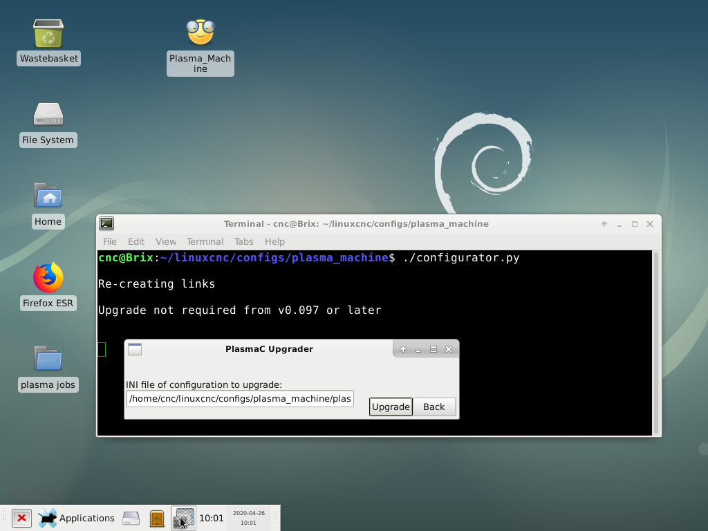

26 Apr 2020 04:21 #165639 by Clive S
Replied by Clive S on topic Update Plasmac?
Phill
I am having trouble updating plasmac. It is saying update not required from version 0.097 or later. I have attached my configs.
File Attachment:
File Name: configs.zip
File Size:497 KB
it might need changing the extension to 7z
What am I doing wrong?
26 Apr 2020 04:27 - 26 Apr 2020 04:32 #165640 by phillc54
Replied by phillc54 on topic Update Plasmac?
Sorry Clive it can be a bit confusing...
All that message means is that the Configurator does not need to do anything.
The last Configurator run required was 0.097.
I probably should reword the message so it makes more sense..
So long as "man plasmac" agrees with the last update on the updates page on the forum all is good.
EDIT: I forgot to add that updates have been automatic for some time now unless you disable it in the ini file.
So if you do a LinuxCNC update then PlasmaC will update itself if it needs to.

02 May 2020 07:13 #166401 by Clive S
Phill
Edit: how to I check what version PlasmaC I have "buildbot"
In a terminal enter:
man plasmac
then compare it to the latest version number here
I want to try and sort out this update problem I seem to have.
My system does not do the Plasmac upgrade automatically
I can only get to the upgrade tab with ./configurator.py running a terminal in my config dir where my ini files are.
A terminal on the desktop will not do it.
When running the upgrade it still tells me it is V097 (I know you said you might change this message)
Running "man plasmac" from a terminal either on the desktop or my config Dir give me the latest version No.
It would be nice to see this version number on the plasmac gui or in the ini file
What file do I need to move to get it to auto upgrade.
02 May 2020 07:44 #166402 by phillc54
Clive,
It is probably that I am not describing it correctly.
Plasmac can only upgrade if you have upgraded LinuxCNC. You have a Buildbot install so you need to update LinuxCNC from a terminal with:
sudo apt update
sudo apt dist-upgrade or sudo apt upgrade
Then all Plasmac application files will be upgraded at the same time. When you next run LinuxCNC, PlasmaC will check to see if it needs to upgrade any .ini .hal or .cfg files and will do so automatically. If needed it will run Configurator in the background and inform tyou that you will need to restat LinuxCNC. This automatic upgrade will not be performed if you have MANUAL_UPGRADE = 1 in the [PLASMAC] section of the ini file, so in that case every time you upgaded LinuxCNC you would need to manually run Configurator. I probably should remove that option as it would be a bit odd to upgrade LinuxCNC on not upgrade Plasmac at the same time.
If you do run Configurator manually and it says "Upgade not required from Vnnn or later" then you installation is at the latest LinuxCNC version downloaded.
Having said all that, the Buildbot has been a bit flakey lately and the latest stretch 2.8 package date is 2020-04-29 whereas the latest stretch maser package date is 2020-05-02.
You can check Buildbot packages here and compare the dates with the latest PlasmaC upgrade dates here
If this ramble makes sense then let me know and I will put something like this in the docs and also on the upgade notification page on this forum.
