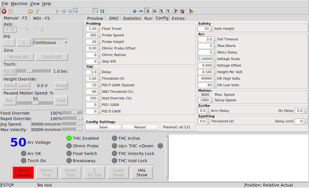

05 May 2020 05:49 #166737 by phillc54
Replied by phillc54 on topic Update Plasmac?
It would be nice to see this version number on the plasmac gui or in the ini file
How about this:
05 May 2020 07:01 #166745 by rodw
Replied by rodw on topic Update Plasmac?
Took me 5 minutes to find it!
