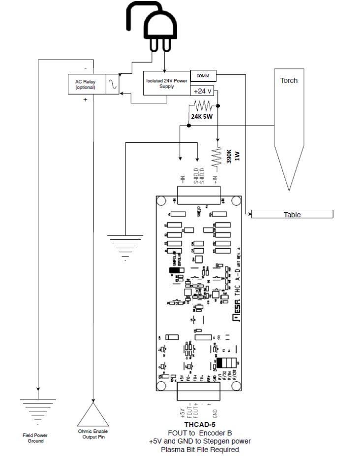

Is there docs on this? I've read the whole thread and I am more confused than before reading it.
I think I have the wiring of it setup but making it work in LCNC will prove to be difficult unless I can read some docs somewhere.

Replied by rodw on topic Hypersensing questions
Use the circuit with the 24k resistor shown
Use ohmic3.comp here
forum.linuxcnc.org/plasmac/38848-hyperse...ons?start=210#175839
Create a new hal file and edit your ini file so it is loaded that contains
Once installed, man ohmic3 should give you some docs. You will need to edit the volt-divider pin if you are using a THCAD-10. I chose the 390K resistor to give a 24.5 volt full scale with a THCAD-5 (per the formula in the THCAD manual). I wanted to make sure the THCAD could see a bit past 24 volts.
You may need to spin up halscope to review your thresholds of a wet torch and edit these thresholds to suit.Ohmic3 does not really use the low threshold as once the voltage starts to fall, it will trigger so it may sense an ohmic off signal above the low threshold
WARNING: Plasmac now uses motion.motion-type so some changes may be required on this signal.. eg. To use Plasmac's pin..
Output-11 is the pin that enables the 240V relay. I think I have mine disconnected...
loadrt ohmic3 names=ohmicsense
addf ohmicsense servo-thread
setp ohmicsense.thcad-0-volt-freq 140200
setp ohmicsense.thcad-max-volt-freq 988300
setp ohmicsense.thcad-divide 32
setp ohmicsense.thcad-fullscale 5
setp ohmicsense.volt-divider 4.9
setp ohmicsense.ohmic-threshold 22
setp ohmicsense.ohmic-low 21.5
setp ohmicsense.mode 1
setp ohmicsense.num-readings 10
net ohmic-vel ohmicsense.velocity-in <= hm2_7i76e.0.encoder.02.velocity
unlinkp debounce.0.2.in
net ohmic-true ohmicsense.ohmic-on => debounce.0.2.in
net plasmac:ohmic-enable plasmac.ohmic-enable
net plasmac:ohmic-enable => ohmicsense.is-probing
#net plasmac:ohmic-enable plasmac.ohmic-enable => hm2_7i76e.0.7i76.0.0.output-11
net ohmic:type <= motion.motion-type
net ohmic:type => ohmicsense.motion-type-in
net ohmic:power <= ohmicsense.power-on
net ohmic:power => hm2_7i76e.0.7i76.0.0.output-11Once installed, man ohmic3 should give you some docs. You will need to edit the volt-divider pin if you are using a THCAD-10. I chose the 390K resistor to give a 24.5 volt full scale with a THCAD-5 (per the formula in the THCAD manual). I wanted to make sure the THCAD could see a bit past 24 volts.

Thankls, I'll see if I can get all this setup.
I though comps were suppose to be compiled.
This is the comp?
So if using a thcad-10 then use a 24K resistor instead of the 390K you used as shown in the attached pdf?

By my calculations, a 147k resistor will give a 24.7 volt full scale which would work well instead of 390k

18 Mar 2021 12:11 #202729
by bevins
OK noted. Where do I put this comp file and how to reference it?
Replied by bevins on topic Hypersensing questions
- Posts: 12094
- Thank you received: 4132
18 Mar 2021 12:23 #202731
(sudo) halcompile --install ohmic3.comp
Then include the provided hal file in my spoiler which unlinks anything required except motion-status as mentioned
sudo is not required for a rip build
- bevins
- Posts: 1947
- Thank you received: 338
18 Mar 2021 12:44 #202734
by bevins
OK but is that file going to compile with all those .br in there? and uncommented comments?
- Posts: 12094
18 Mar 2021 12:52 #202736
Try it, it worked for everybody else. I gave you a link to the file to download
There is a lot of documentation in there for the man page that requires other halcompile switches.
