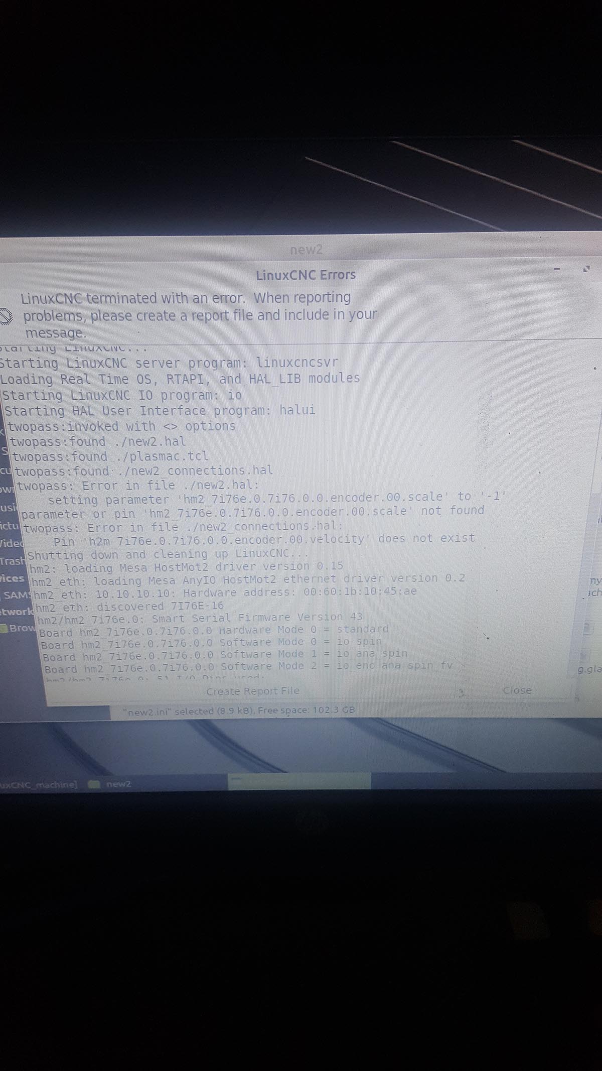

Okay I edited my base hal file so this is now at the bottom
setp hm2_7i76e.0.7i76.0.0.encoder.00.scale -1
setp hm2_7i76e.0.7i76.0.0.encoder.00.filter -1
setp hm2_7i76e.0.7i76.0.0.encoder.00.counter-mode 1
and then run configurator
I still get errors:
I'll go ahead and try to attach my config files:
I still get errors:

09 May 2020 21:14 #167220
by phillc54
Replied by phillc54 on topic Help with adding PlasmaC to base config + 7i76e
Maybe it is just:I don't have one handy and am just guessing...
You can verify pin names in the menu Machine > Show Hal Configuration > Pins >
You will need to comment out those error lines so LinuxCNC starts
hm2_7i76e.0.encoder.00You can verify pin names in the menu Machine > Show Hal Configuration > Pins >

09 May 2020 21:44 - 09 May 2020 21:51 #167224
by Plasmaguy
Replied by Plasmaguy on topic Help with adding PlasmaC to base config + 7i76e
Tried it both ways (three if counting when I had too many periods in there) with the same result. If I put those lines in my working hal file and then try to start LCNC up it crashes right away with this same error. Also I can't seem to locate the encoder pin anywhere in my show hal config and if I search for "encoder" in my hal file I find a statement saying " num_encoders=0 ".
I was able to locate my float switch and spindle on in show hal config...not sure where the encoder is hiding.
What does this entail? Hate to ask, but I don't know.

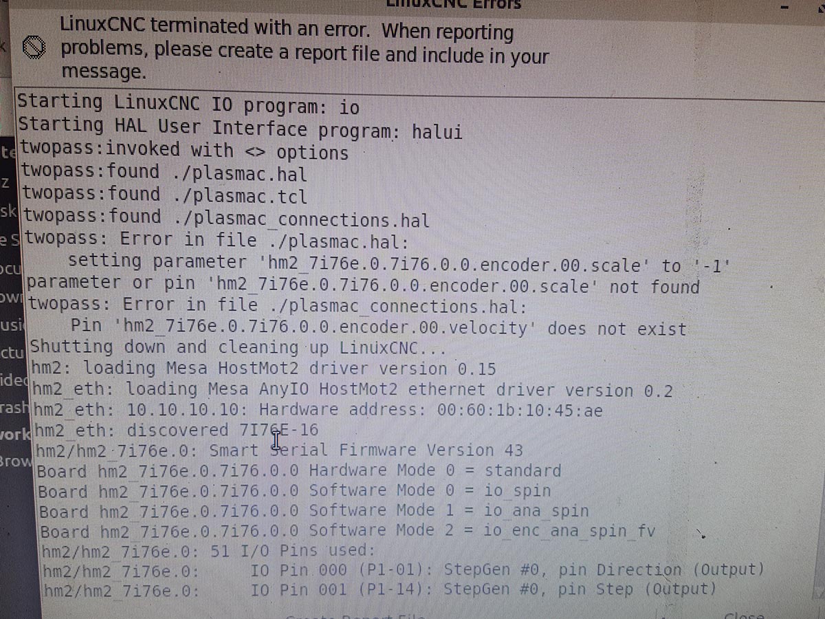

09 May 2020 21:51 #167225
by phillc54
Sorry, I mised that:
This:Should be:
This:
loadrt hm2_eth board_ip="10.10.10.10" config=" num_encoders=0 num_pwmgens=0 num_stepgens=3 sserial_port_0=00xxxx" loadrt hm2_eth board_ip="10.10.10.10" config=" num_encoders=1 num_pwmgens=0 num_stepgens=3 sserial_port_0=00xxxx"
The following user(s) said Thank You: Plasmaguy

09 May 2020 22:22 #167227
by phillc54
I don't know where it is getting "concat" from, can you post the hal file you edited.

09 May 2020 22:34 #167228
by Plasmaguy
# Generated by PNCconf at Fri May 8 18:45:28 2020
# Using LinuxCNC version: UNAVAILABLE
# overwritten when you run PNCconf again
loadrt [KINS]KINEMATICS
loadrt [EMCMOT]EMCMOT servo_period_nsec=[EMCMOT]SERVO_PERIOD num_joints=[KINS]JOINTS
loadrt hostmot2

- Plasmaguy
- Posts: 76
- Thank you received: 9
09 May 2020 22:53 #167231
by Plasmaguy
It's in the picture in
this post.forum.linuxcnc.org/plasmac/39045-help-wi...i76e?start=10#167226
Something about encoder scale and encoder velocity.
- phillc54
- Posts: 5711
- Thank you received: 2100
09 May 2020 23:14 #167233
by phillc54
They should be like this:
setp hm2_7i76e.0.encoder.00.scale -1
setp hm2_7i76e.0.encoder.00.filter 1
setp hm2_7i76e.0.encoder.00.counter-mode 1
net plasmac:arc-voltage-in hm2_7i76e.0.encoder.00.velocity => plasmac.arc-voltage-inPlease Log in or Create an account to join the conversation.
