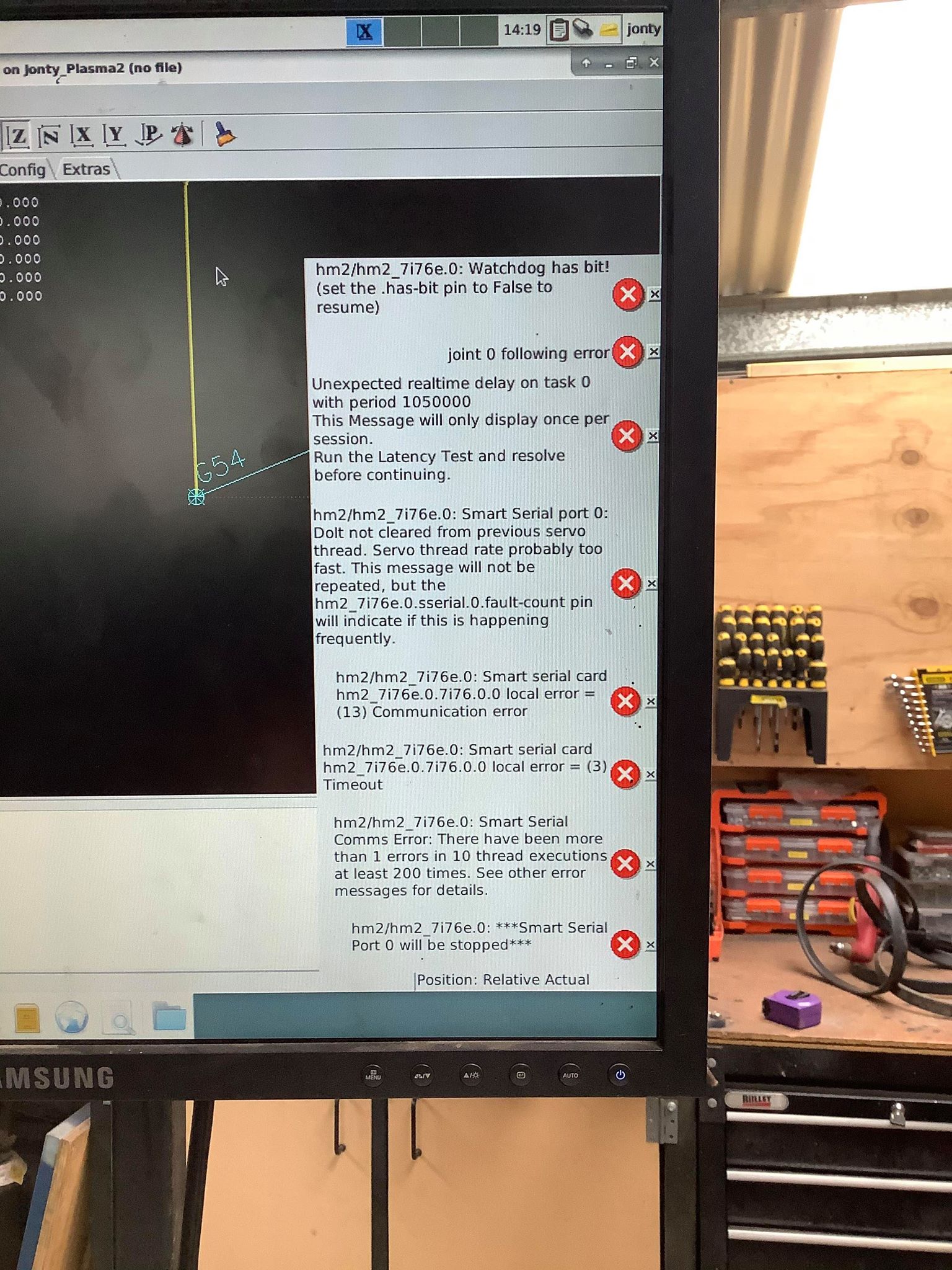

not sure if this is a Linuxcnc based error or PlasmaC but I had this watchdog has bit error come up before when I was using my machine as a router and now that I am finally running PlasmaC this error has come up again. Im not sure if its anything to do with plasmaC or just a coincidence but does anyone know how i can fix it?
Could it be an issue with my mesa card or is it definitely my computer?

That is usually an issue with latency on the host but a few other possibilities are
1. Watchdog timeout too short
2. Some other cause of communication dropouts
3. Host PC has Intel Ethernet chip but IRQ coalescing left on

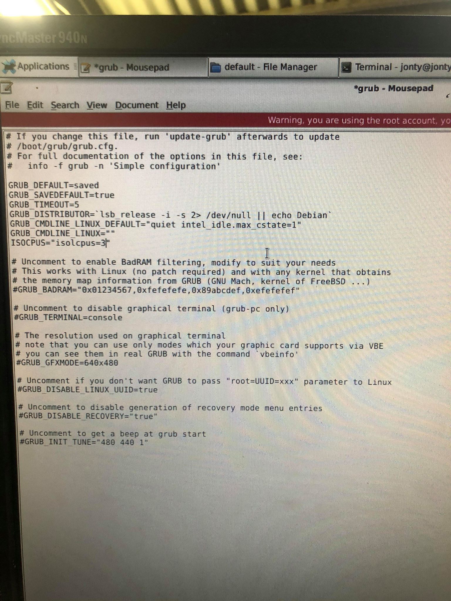

What is your host CPU?
isolcpus sometime helps. but not always
Normally the watchdog time is set for 5 to 50 ms if you have a 1 ms servo thread
Increasing the timeout value may avoid the watchdog biting but
just masks the real problem: You have a real time error.

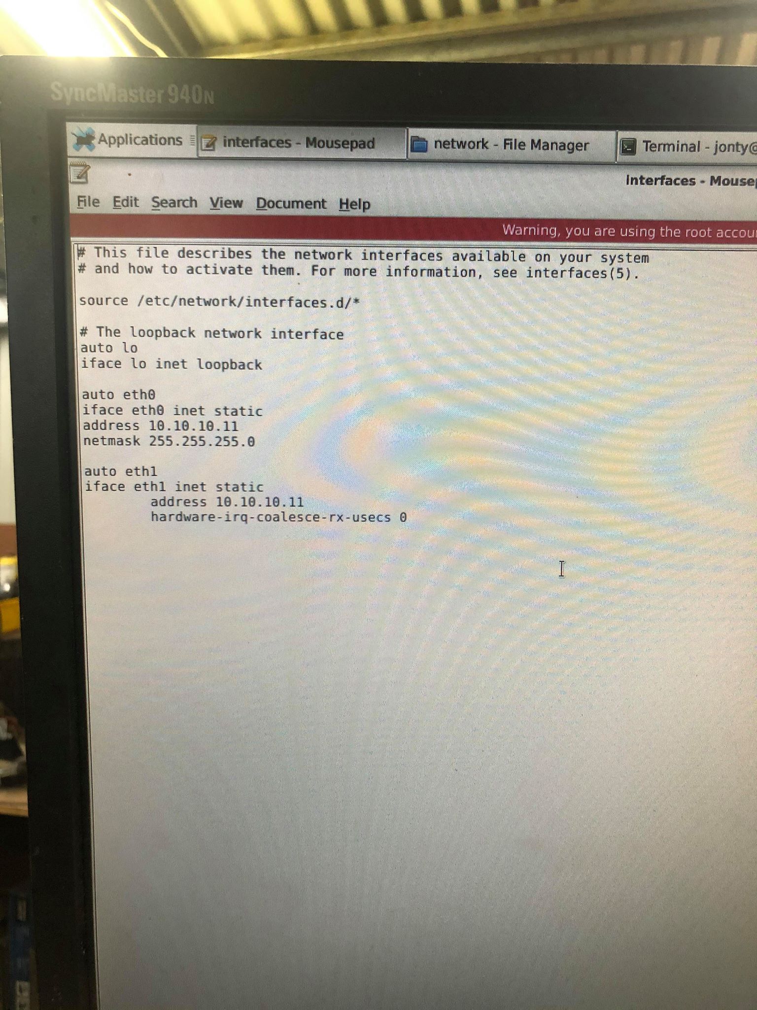

I checked my /etc/network/interfaces file and it appears i have IRQ coalescing turned off.

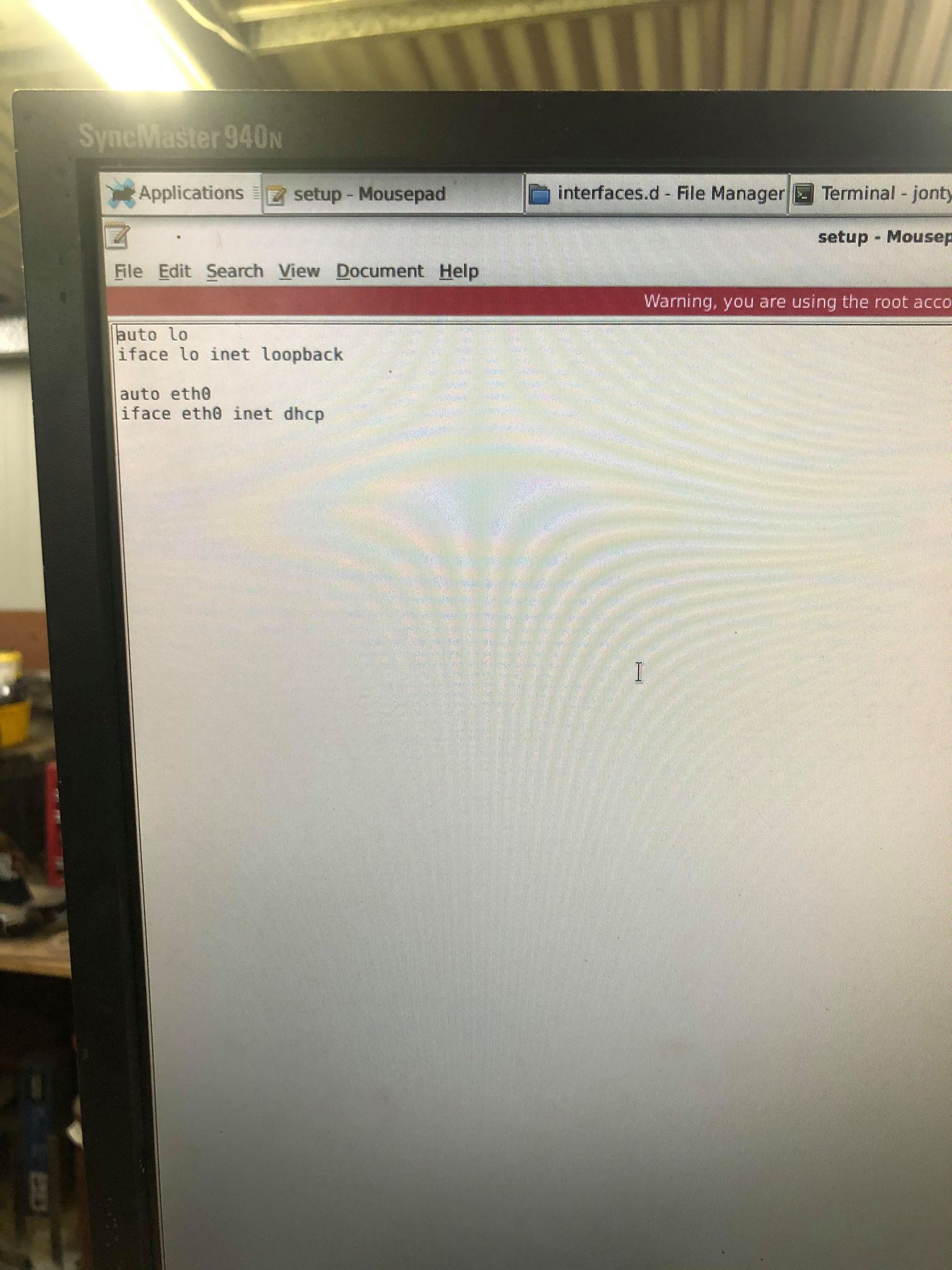

I also looked into my interfaces.d/setup file and it looks pretty blank, should this have coalescing in it too?
I have also changed my isolcupus to isolcupus=3, i am running latency to see if this changes anything.
In this same file it has cstate=1, should this equal 0?
Files are attached.

You must not have eth0 and eth1 the same adress

As pcw proposed you already switched of irq on eth1 so stick to that.
Just for completeness give it a mask of 255.255.255.0.
And make a direkt cable from that port to the mesa card. Nothing in between.
And i would reconfigure eth0 to dhcp and connect to the rest of your network.
