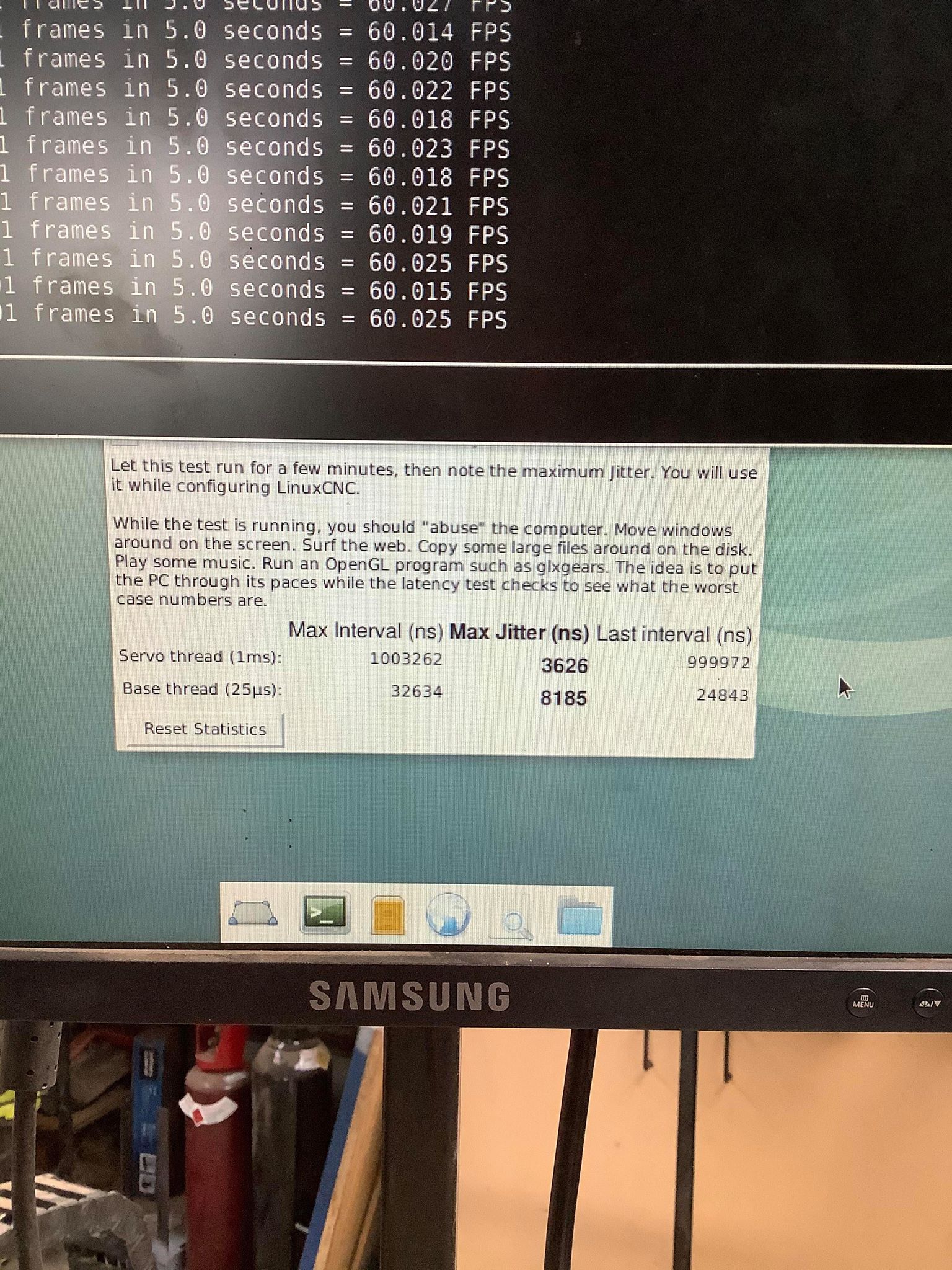

- little_sparky
- Posts: 138
- Thank you received: 17
14 Jun 2020 00:10 #171555
by little_sparky
Replied by little_sparky on topic Watchdog has bit!
some extra information so see if it means anything.

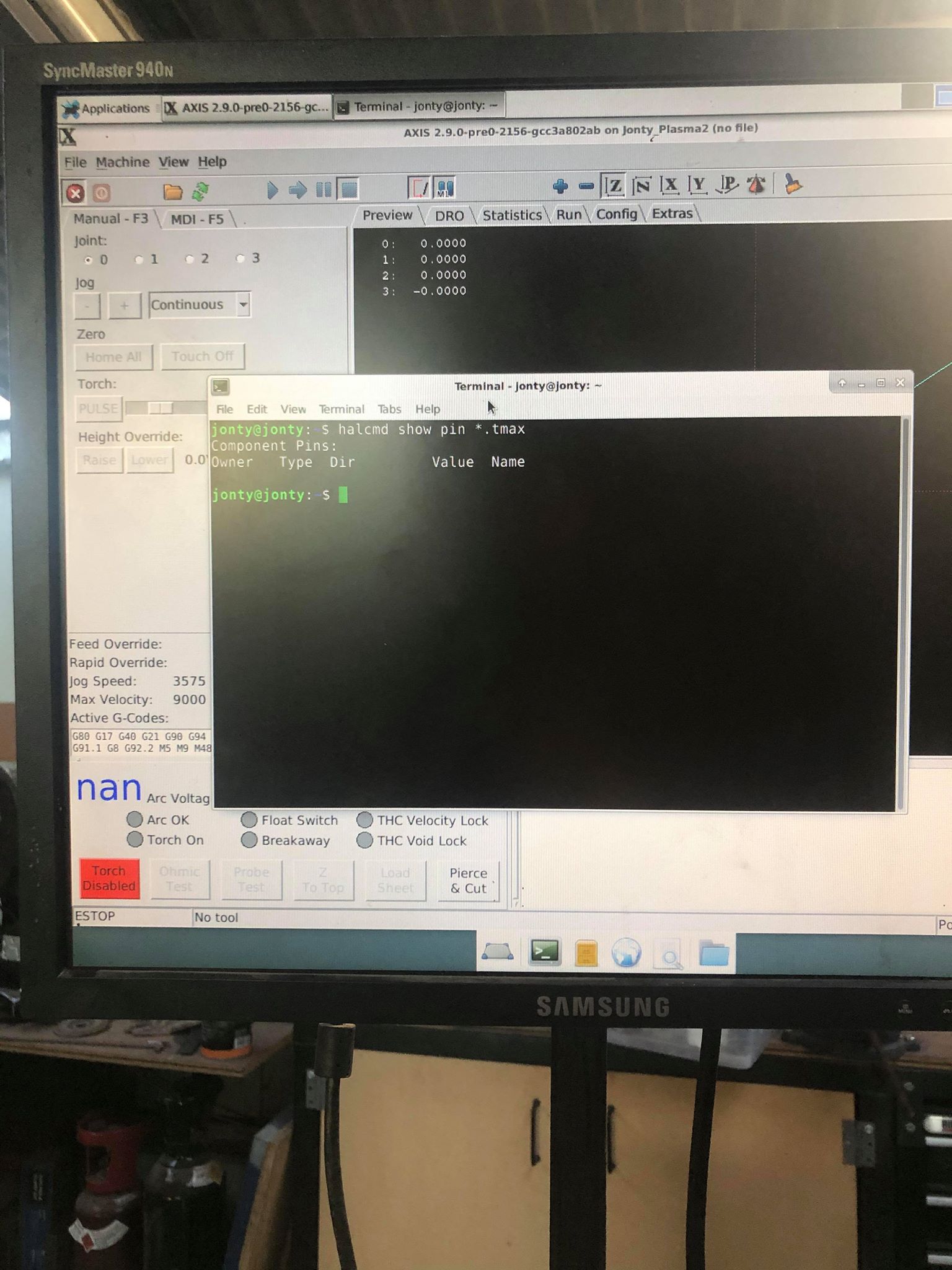

- little_sparky
- Posts: 138
14 Jun 2020 01:40 #171566
by little_sparky
updating the ethtool gave this.
i couldnt seem to get halcmd show pin *.tmax to give any values.
this is what came up.

- Posts: 18119
- Thank you received: 5337
14 Jun 2020 07:48 #171600
Replied by PCW on topic Watchdog has bit!
Sorry that's:
halcmd show param *.tmax
