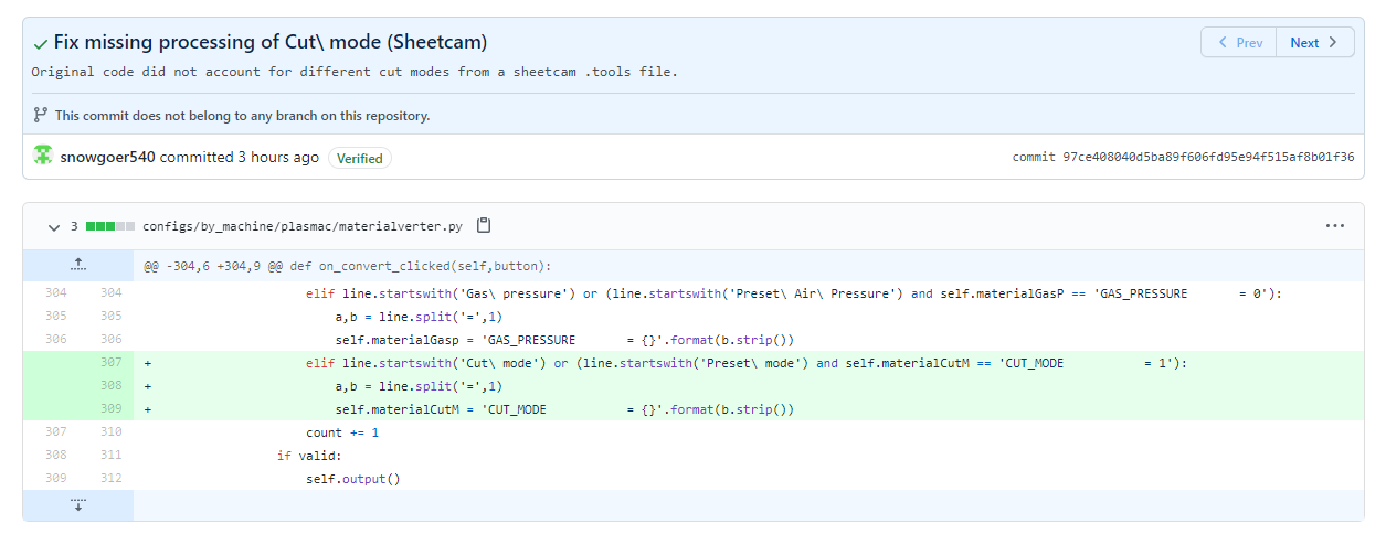

Ok, I think I got it figured out. I am doing this from the website btw, idk if that makes a difference.
There is no linuxcnc-dev that I see on the github repository. I changed the .comp file under the linuxcnc folder. I am not sure if that was right or not, you can see what I did there though, please let me know if I need to fix it.
How does this get from the master branch to the 2.8 branch? It looks like everything I did was under master?

OK, I assumed you were doing it from your local repo.
It does all need to be in one commit though, which you can do locally with a squash. I am not sure how that can be achieved via the website.

I think I got them all to the same pull request, does it look right, or no?
Replied by snowgoer540 on topic Materialverter
It may be worthwhile asking the question on the developers email list:
sourceforge.net/projects/emc/lists/emc-developers

They are the same PR but there are four commits, ideally it should be one.

I don't think I have the permissions I need from what I see on the interwebs. At any rate, I've reached the max amount of frustration for the evening, and ironically the end of my laptop battery.
needs to be inserted after line 306, or as the screen shot shows:
Evidently I can only have one coding victory per day.
It wont hurt my feelings if you commit the change on my behalf. I'll figure out git another day.
elif line.startswith('Cut\ mode') or (line.startswith('Preset\ mode') and self.materialCutM == 'CUT_MODE = 1'):
a,b = line.split('=',1)
self.materialCutM = 'CUT_MODE = {}'.format(b.strip())needs to be inserted after line 306, or as the screen shot shows:

If you do want to try again here is a starting point. I can help you through if I know the answers.
linuxcnc.org/docs/html/code/contributing-to-linuxcnc.html
No rush, you can always close the existing PR and make a new one when you a happy with what you have.
