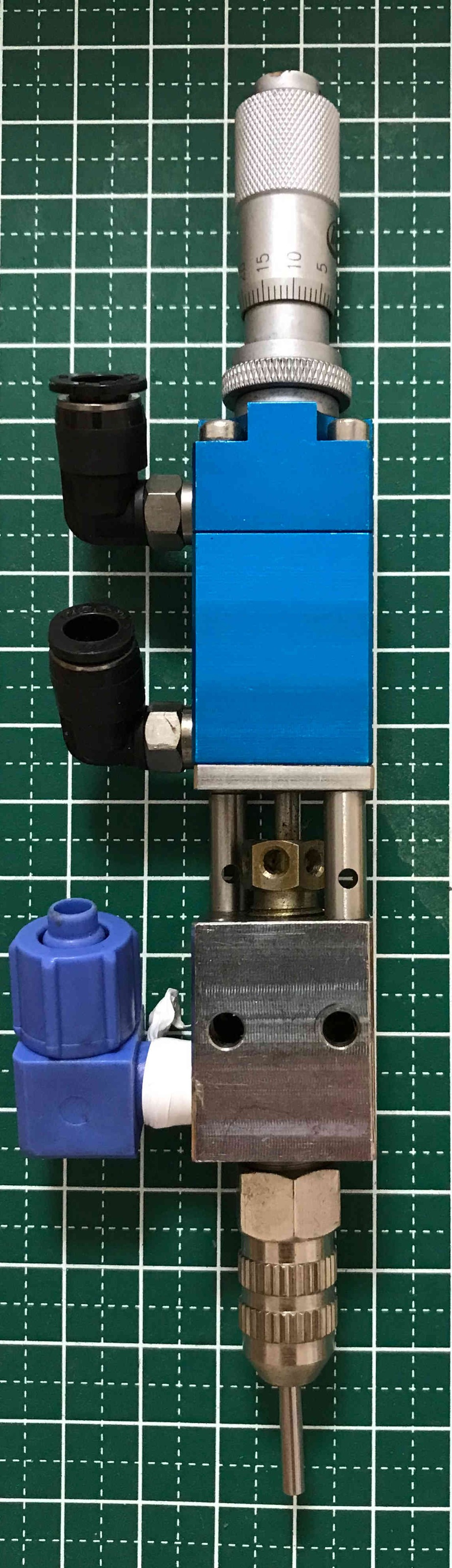

Hello everybody!
I read about Plasmac and isnt clear to me the THC and Hypersensing.
I dont have Plasma machine and ill try to make one glue dispenser machine for engine cover head.
The engine cover head is made from casting mold, some engine cover head isnt leveled because the process of fabrication.
I tested the working process using one 3D printer (Prusa I3) and worked ok, just the height level was different from many samples (10 samples per model using 20 different models) was good just the height level difference is around 0.7 in some models...
I trying to have constant 0.5mm height level.
I wondering if is possible to attache the 24V plus side to the nozzle and the 24V minus to the table and use the THC to control the height of the machine.
Do you think its possible or to use the THC i need ARC start?
If someone is interested please take a look in the pictures one from small engine cover head and another from the nozzle type im looking to use.

One thing worth trying would be to probe the surface at regular intervals and calculate the Z offset required before the glue run. There have been some examples shared about probing a surface in a grid on the forum and possibly in the wiki which could be adapted.

It seems doable, but as ROD mentioned, using THCAD for probing first.
You can also use a proximity sensor for probing as they can sense the material without actually touching it.
There is a component written by a member of this forum used for probing and levelling a 3D printer bed, that could be very useful, but i could not find it.

Thats what I meant... I'm not sure the THCAD is useful though as you don't have to deal with the electrical noise the THCAD was designed to handle.

You can use a THCAD in a hypersensing mode but it cannot be uses to detect the height in real time like while plasma cutting because it uses the plasma arc to determine the torch height above the cut.
Maybe try setting up the hypersensing like a 3d printer BL touch probe. The other option is a vision system but I do not know enough about vision control..yet!

If i saw right you are glueing on metal. As a distance probe you could use inductive sensors.
2 tiny ones to make old fashioned 2 point regulation = too high / to low. (fidely mecanical wise, but with 4mm sensors eventually possible.
Or analog distance if you find affordable.
Than make normal xyz machine. On the z axis use external-offset to adapt hight by your inductive measure equipment. Should be easy if you can probe near to your noozle.
