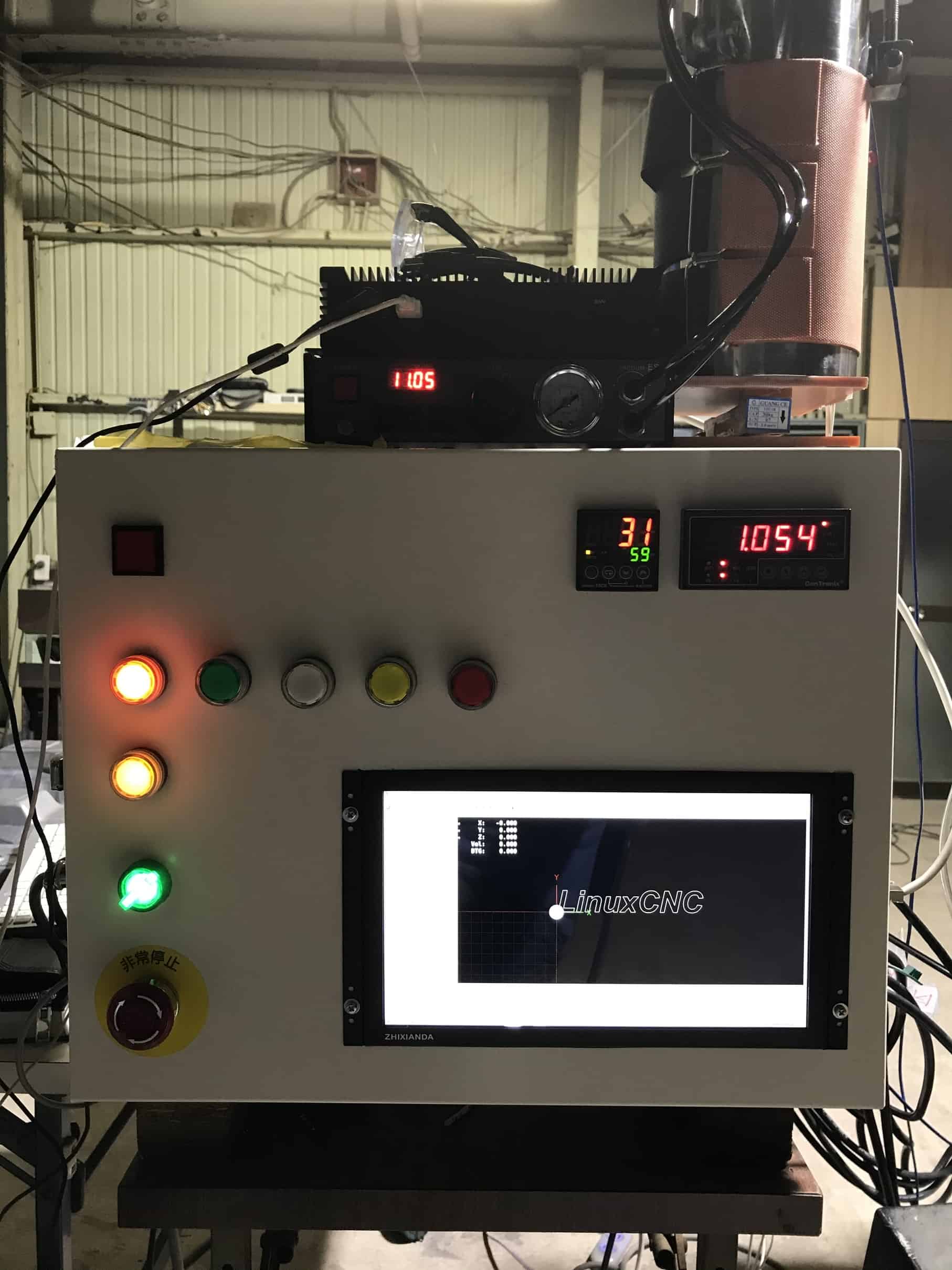

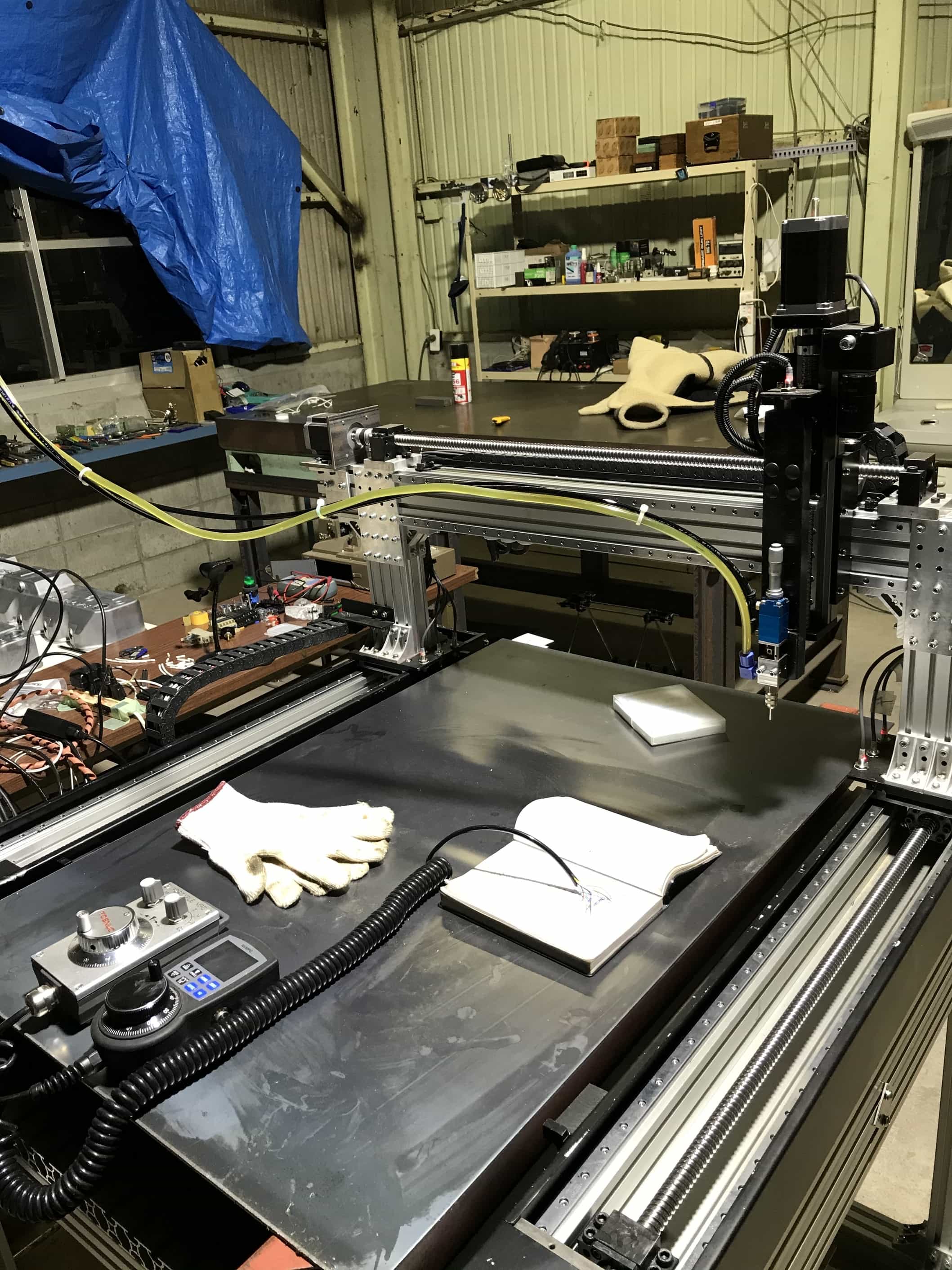

Yes but im still working and learning how to do the thing. mechanical part is ok.
I wrote a lot here but i pushed wrong button and erased all...anyway 12/14 ill take the machine to the customer and get feedback after 2 weeks and adjust all and make prober GUI. now im using AXIS but i have touch panel...and i need more simple screen like BP Touch style
the machine have temperature and weight control, im learning gcode the real GCode because my background was 3D printer...
When i finish ill open one thread at show your stuff.

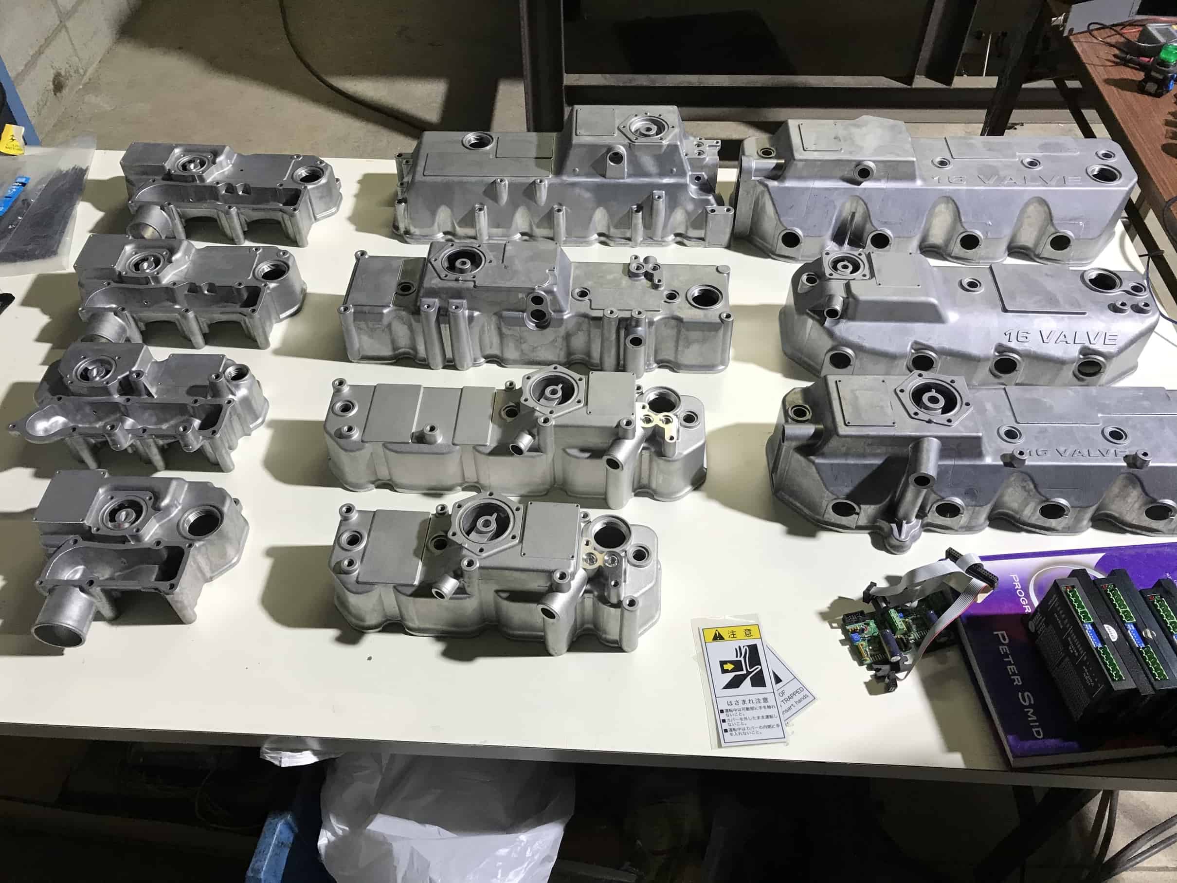

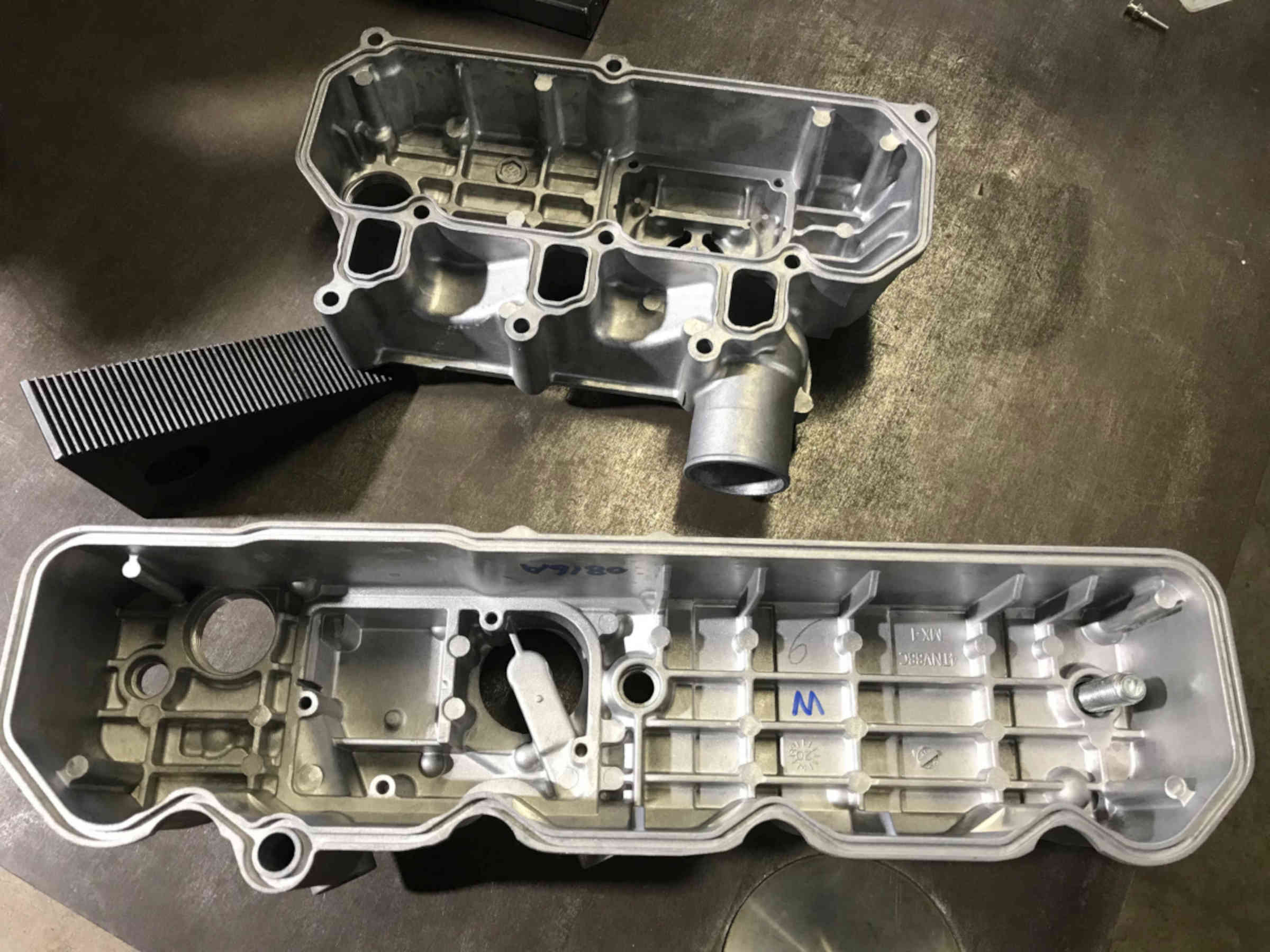

the total covers is 40 models...i get some cover models to make test and adjust.

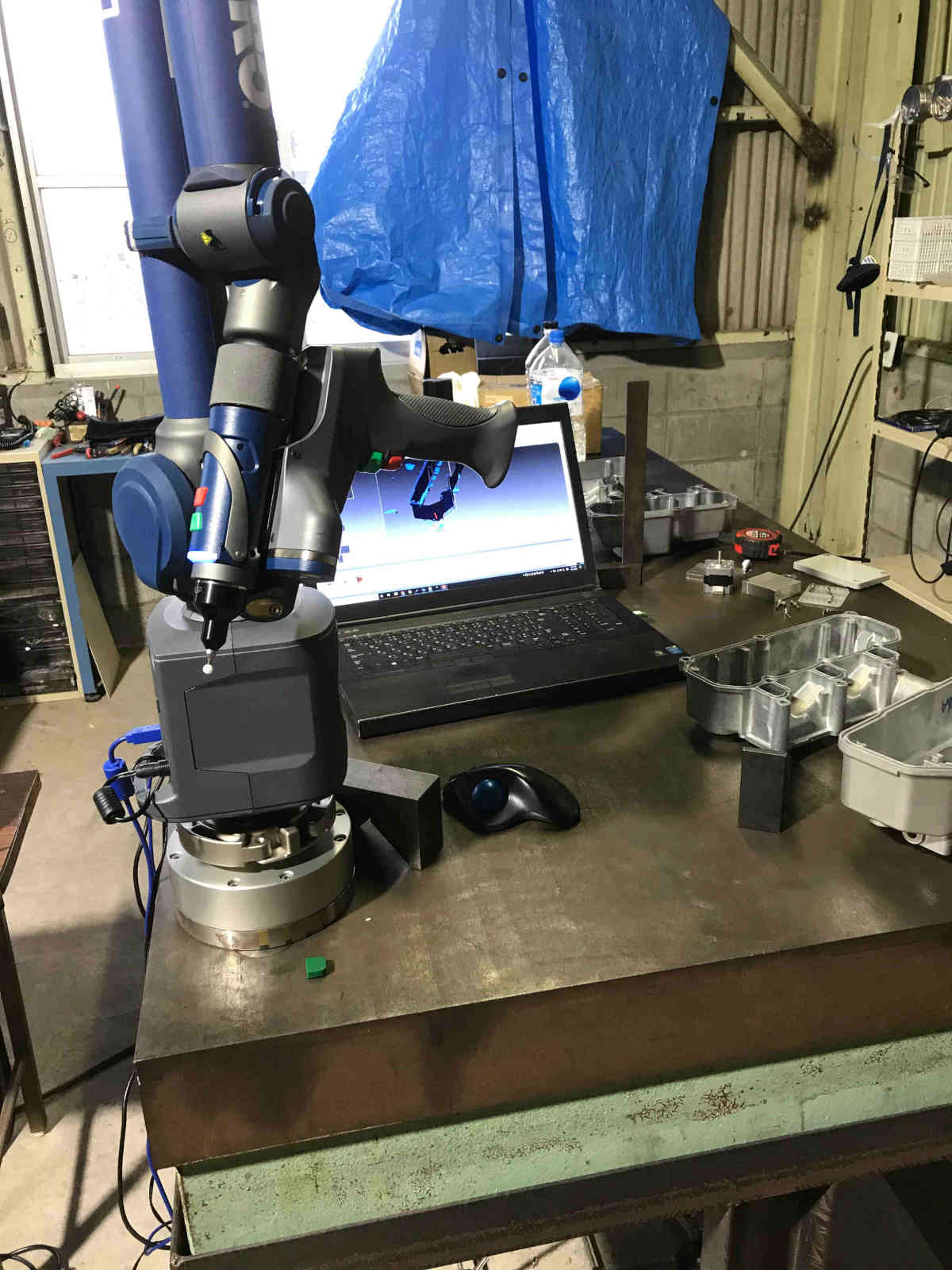

I tried teaching using pendant and logging the coordinates using teaching.py...very time consuming, before i start using Linuxcnc I imagined can teach like weld robot (weld robot is time consuming too but little more fast and smooth arc) I remembered i have scanner so now just take few minutes and send to Design X > NX > Sheetcam > Linuxcnc

Could you tell us more about your scanner please. Is it a 3d hand held unit? What kind of retail price does it cost?
